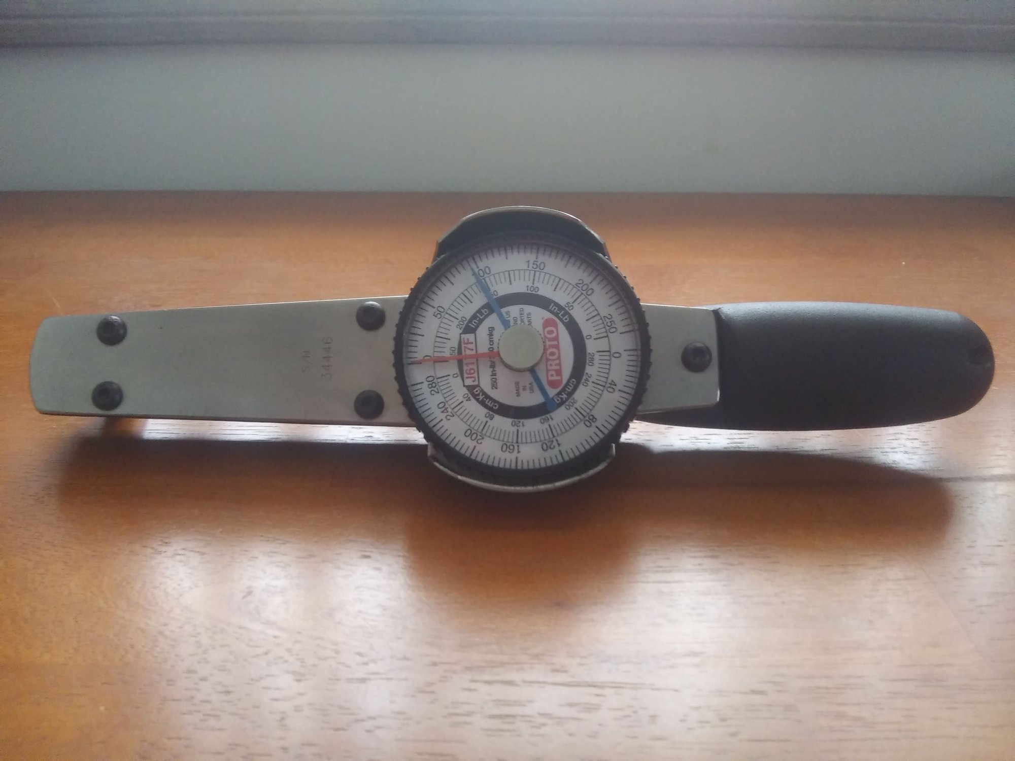

Another advantage of using a torque wrench with a dial indicator.
It automatically returns to zero after each use.
