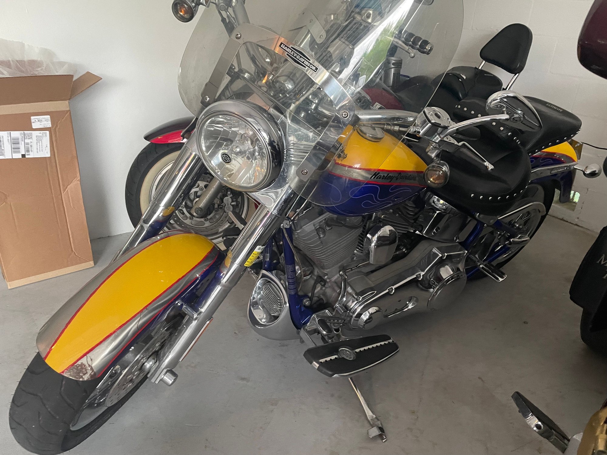

My father in law has a CVO of that year, with what appears to be a HD windshield. If you want more info, I might see it tomorrow.

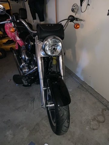

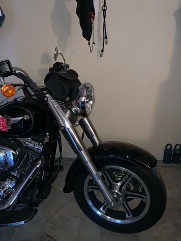

The photo I attached yesterday is of one I saw online for sale, and others I've seen online were similar with the width being 14.5 inches at the bottom between grommets. But my Harley measures 12.75 inches from the left grommet to the right grommet (across the forks) and that's where I'm not sure of things.
Photos below are my Fatboy... Do these forks look stock for a 2006 Harley?... If so, wonder why none of the used windshields I'm seeing online match my measurement of 12.75 inches across at the bottom grommets.

When I zoom in on your bike pic, I don't see those spacers... So I wonder if you have aftermarket mounts, or something was done to your HD mounts....???

I appreciate the time in sharing insight... I just bought the bike late fall and bought from a dealer, so not sure what windshield it had on it previously. I assume it had a windshield since it has grommets on it.
I don't know if these are stock forks but assume they are. But if they are, then not sure why I'm having trouble finding a used fatboy windshield with the same measurements as the bottom grommets.
Note: The width between the top grommets different than the width between the bottom grommets. The width between the upper grommets is 12 inches (whereas I had mentioned the bottom grommets are 12.75 inch width)... So no spacers on the top grommets to make them the same width as between bottom grommets... But not sure if this matters as I'm guess a lot of windshields are set up for this (if these are stock forks) and I assume the prior owner must have had a windshield (or these are stock forks), since there are grommets installed.
