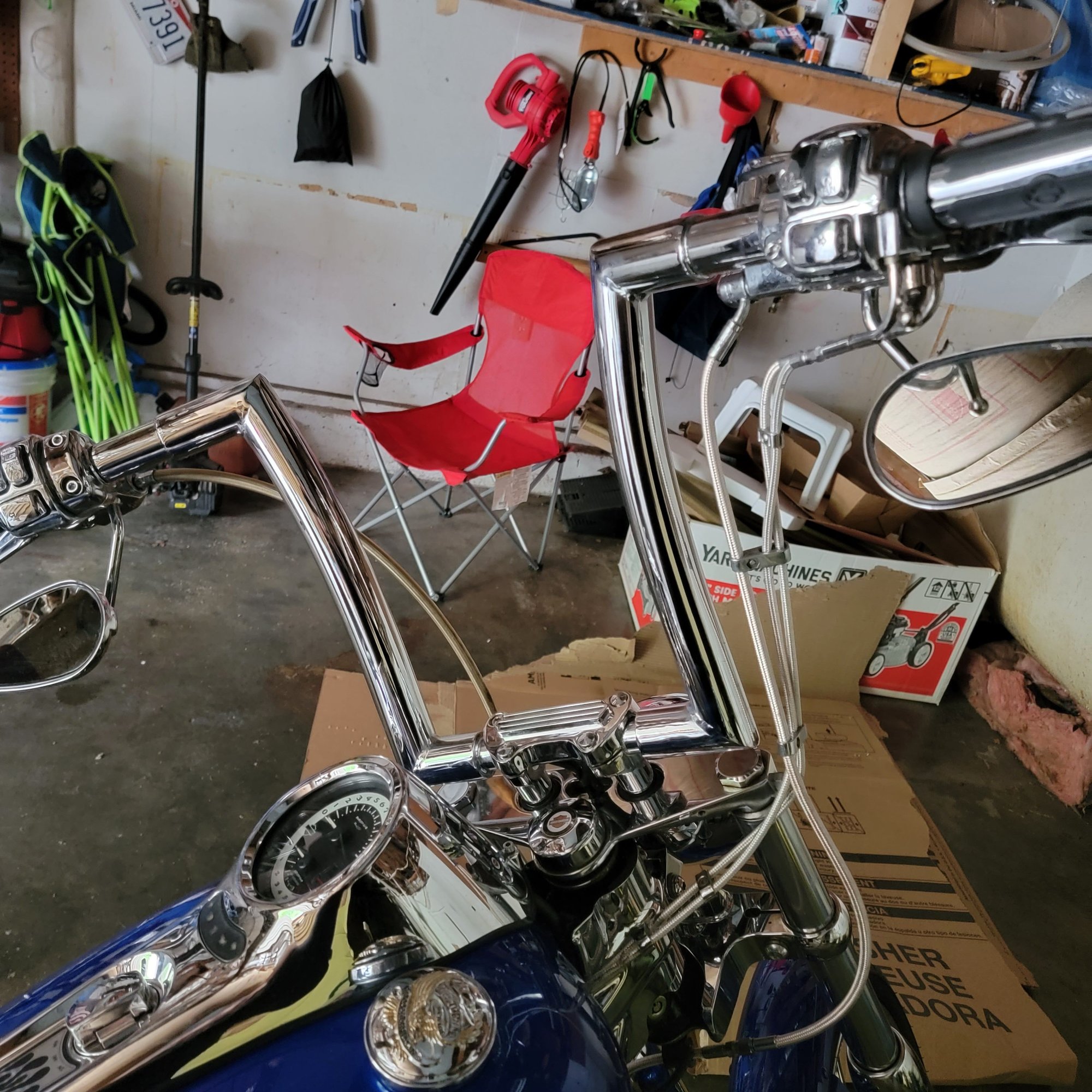

Hello I'm trying to find an as close to stock as I can for a handle bar setup as I just bought my duece. Not a fan of the ape look. Just found out how hard it is to find parts for mine. Dont think i have a factory riser though. I need to replace the riser bushing as there bad and just want to go to a stock look.Any info would be great.

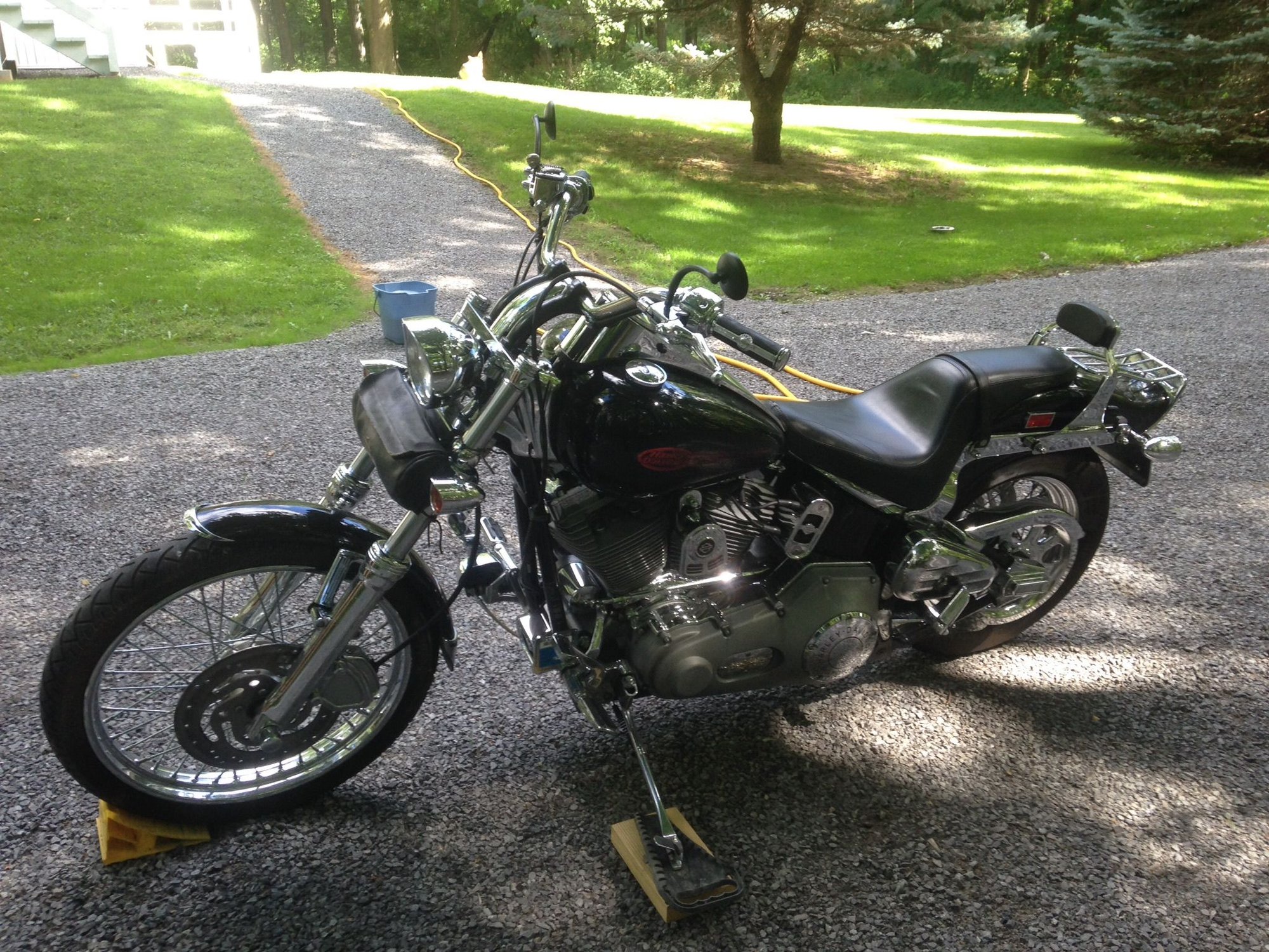

Here is how it came out.
