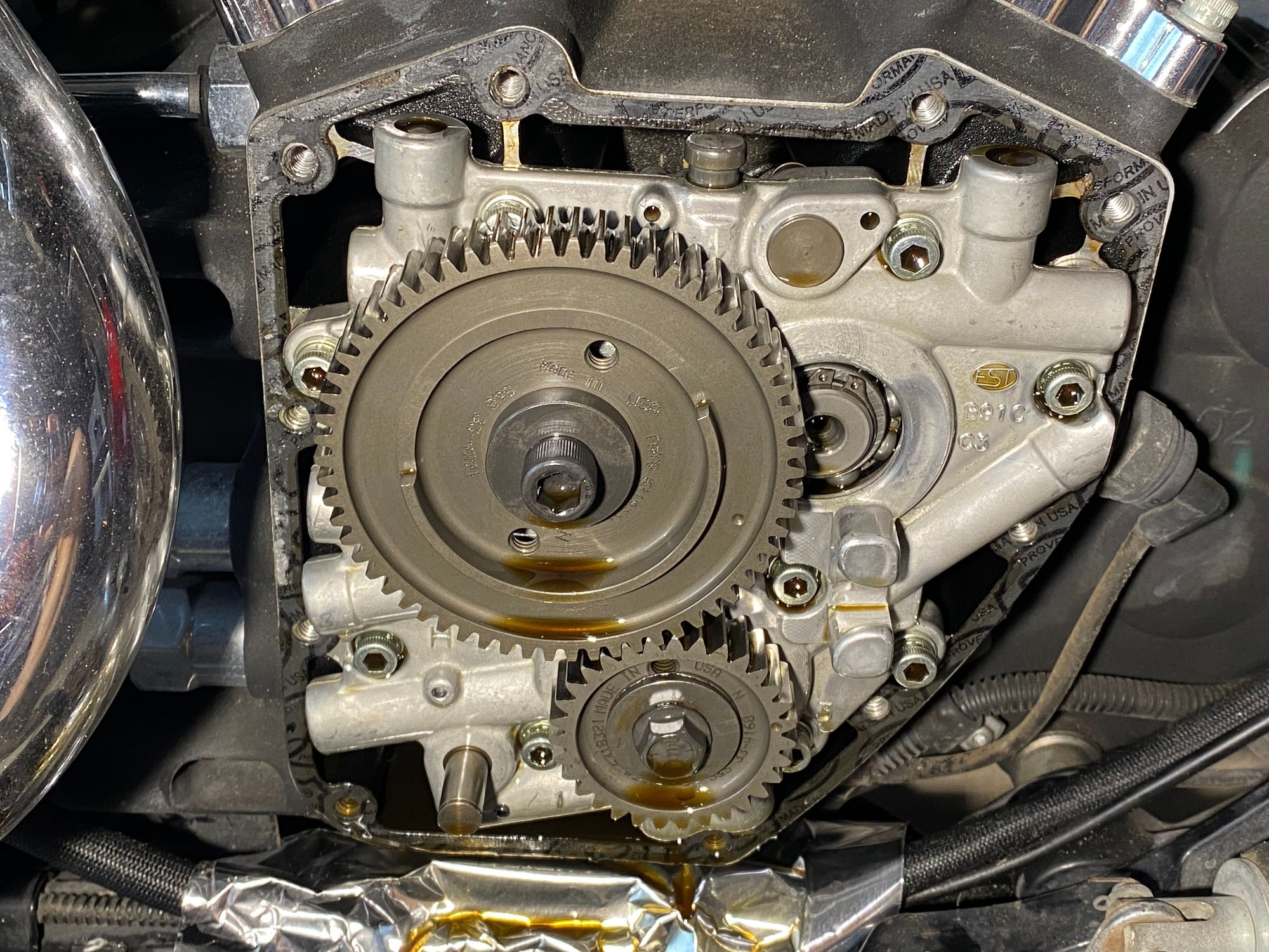

Welp, got me some awesome news today and a very pretty sight when I opened my case and found this:
Woohoo! Putting it back together now…
Raz

You are missing parts! Don't start that up like that, no cam chain tensioners, no chain, year that apart until you find the missing parts.

Very nice surprise......!
