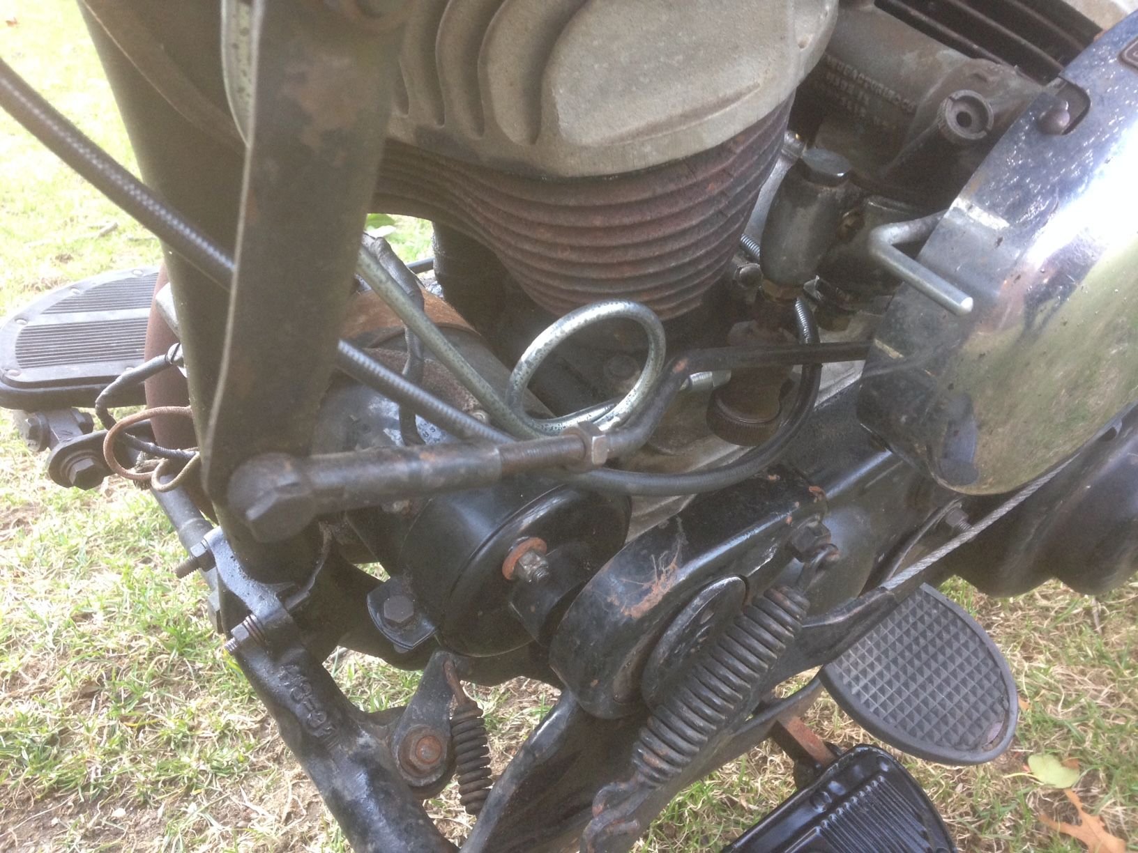

Cannot comment on hydraulic but many years ago my friend had a big crazy Evo chopper. He had the jockey shift handle off the transmission for shifting. He bought an original HD rocker clutch setup at a swap meet and fabricated a mount to get it to bolt up to his early Softail frame. And there he was with a rocker clutch.
If the rocker is really what you want, and I do recommend over the usual suicide clutch pedal, go find a nice original one from the MoCo than figure out how to mount it to your bike. The cable has a ferrel at the end with an eye hook that just slips onto a stud on the rocker mechanism. So after figuring out mounting, a custom cable should be the only thing in your way. Good luck.
