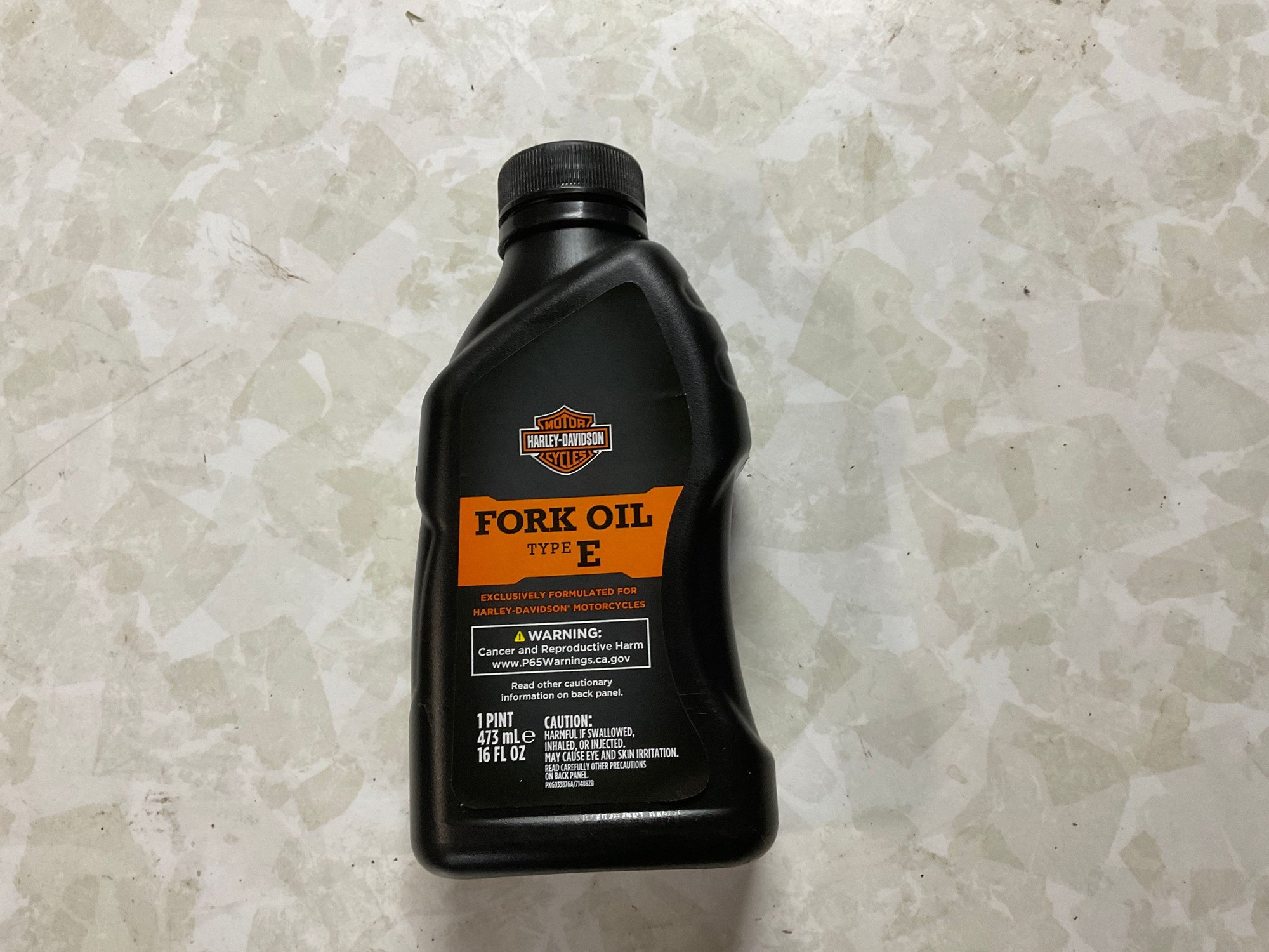

Check your service or owner’s manuals to see what’s recommended.
If you don’t have a service and owner’s manual then that should be your next purchase.
On my 09 Heritage the manual states to use type E.
That seems to work fine for me @245 lbs.
Also, you’re going to want to use new compression washers just to insure you don’t get a leak at the drain screws.
You can get a kit with new screws and washers from HD for I think around $8 or go to Harbor Freight and buy a copper washer kit for $7.
