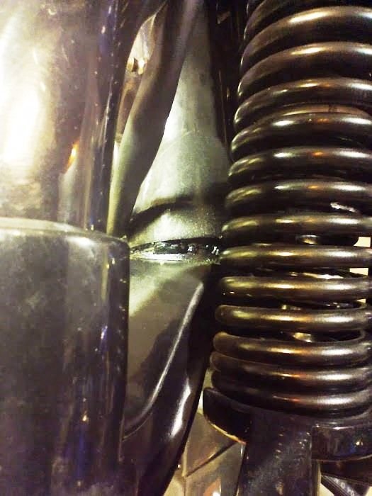

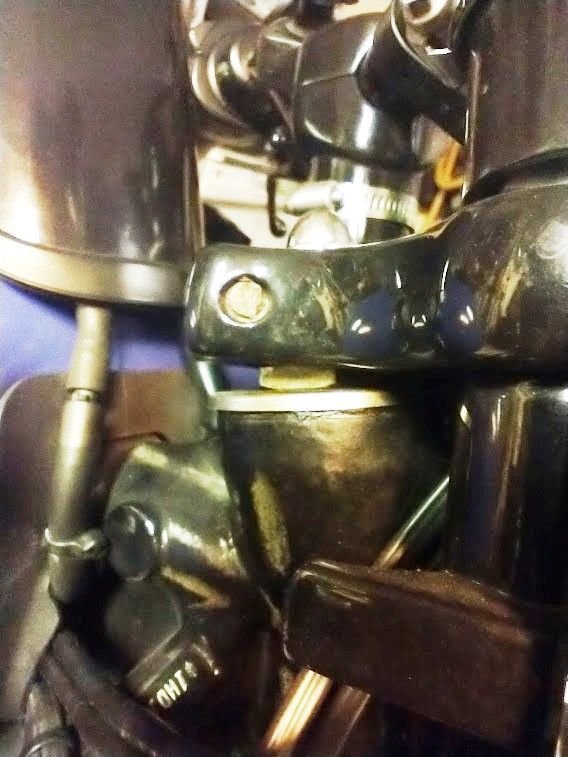

My '05 Softail springer bounces a lot, more in turns. The fork seems crooked. See the attached pics. Its the only springer I have ever owned, so I cant compare it to anything. I have filled the neck with a greasegun, and the grease comes out a lot. It only has about 7,500 miles, but it doesn't seem right to me. Is this normal? Any ideas would be great thank you.

I'm still learning a lot about springers myself, but shouldn't that bottom bearing (race) surface on the fork be more in line with the neck? Maybe it's just the camera angle...

Was the bike ever in a front end accident? Bearings would never be exposed liken that, the stem shaft is bent by the looks of it.

Look up the rake and trail specs for your springer, with a tape measure, and a level or plumb bob you should be able to see if your are in spec. that gap looks at least a 1/4 inch.
looks like ball bearings are missing that bike is not safe to operate in this condition

That front end is definitely tweaked.

If you can’t do it yourself take it to someone who can now. We have two springers in our garage and neither one of them bounce or more correct term pogo. Neither did the other two I’ve owned in the past. The bottom race is amiss for sure.

I haven't owned my Crossbones Springer too long, but I would say it's supposed to feel pretty close to regular forks, in terms of how it behaved in a turn. Mine definitely doesn't bounce or pogo in turns. The spring shown in your photo looks OFF, as it is not supposed to bulge, but rather be a straight line from top to bottom any way you look at it. As you may/may not know, the Springer front end has a fairly frequent recommended maintenance intervals, (at least every 5K miles) so if your bike is overdue for this, just get it done.
