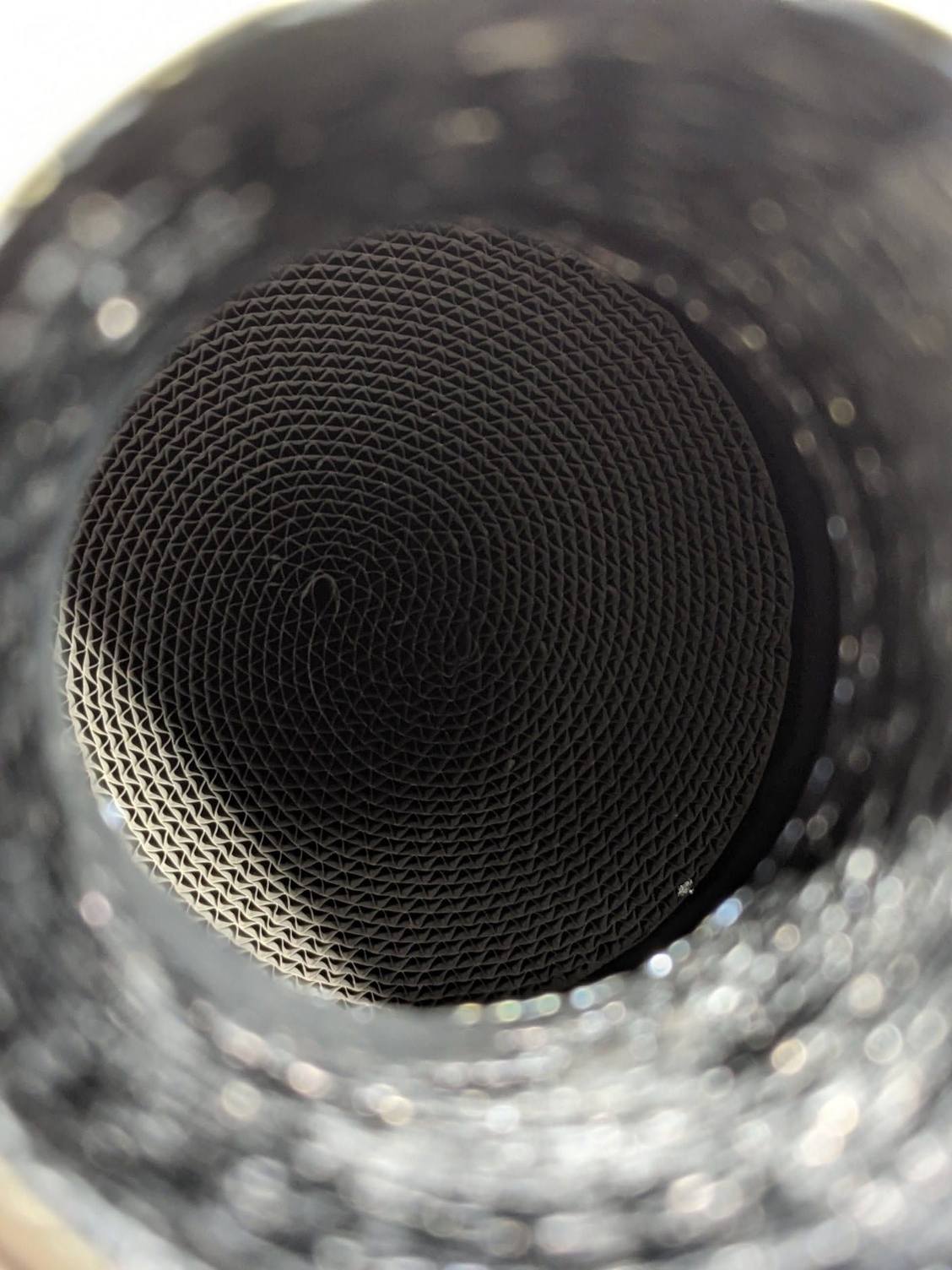

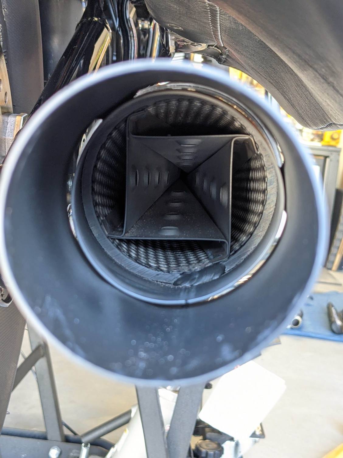

OP; What's your end-goal here? Are you looking for better sound, or performance?
Either way, I'll know more in the spring, as I have a brand new Freedom Performance true-dual system in garage waiting for spring. I can tell you, from experience, a muffler swap definitely helps w/ sound as I swapped stock for Thunderheader slip-on's in 2020. Also true is cats are in pipes...check out my before & after pics:
Before (stock HD):
After (Thunderheader):
