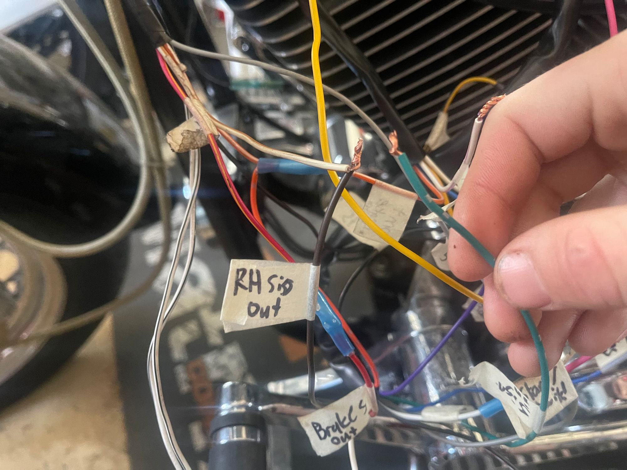

Hi all,
I am in the process of rewiring a 96 fatboy. I got everything else working perfectly except for the turn signals. The flasher module wire is hooked into each turn signal output as the new diagram shows but whenever power is sent turn on the signals are constantly flashing. When I disconnect the flasher module wire from the signal outputs I am able to press each button and the signal light will turn on but doesn't flash. I am using the Pro-One wiring harness kit and everything else is working perfectly. Attached are a couple images to put some visuals to it. Friends and I are stumped.
