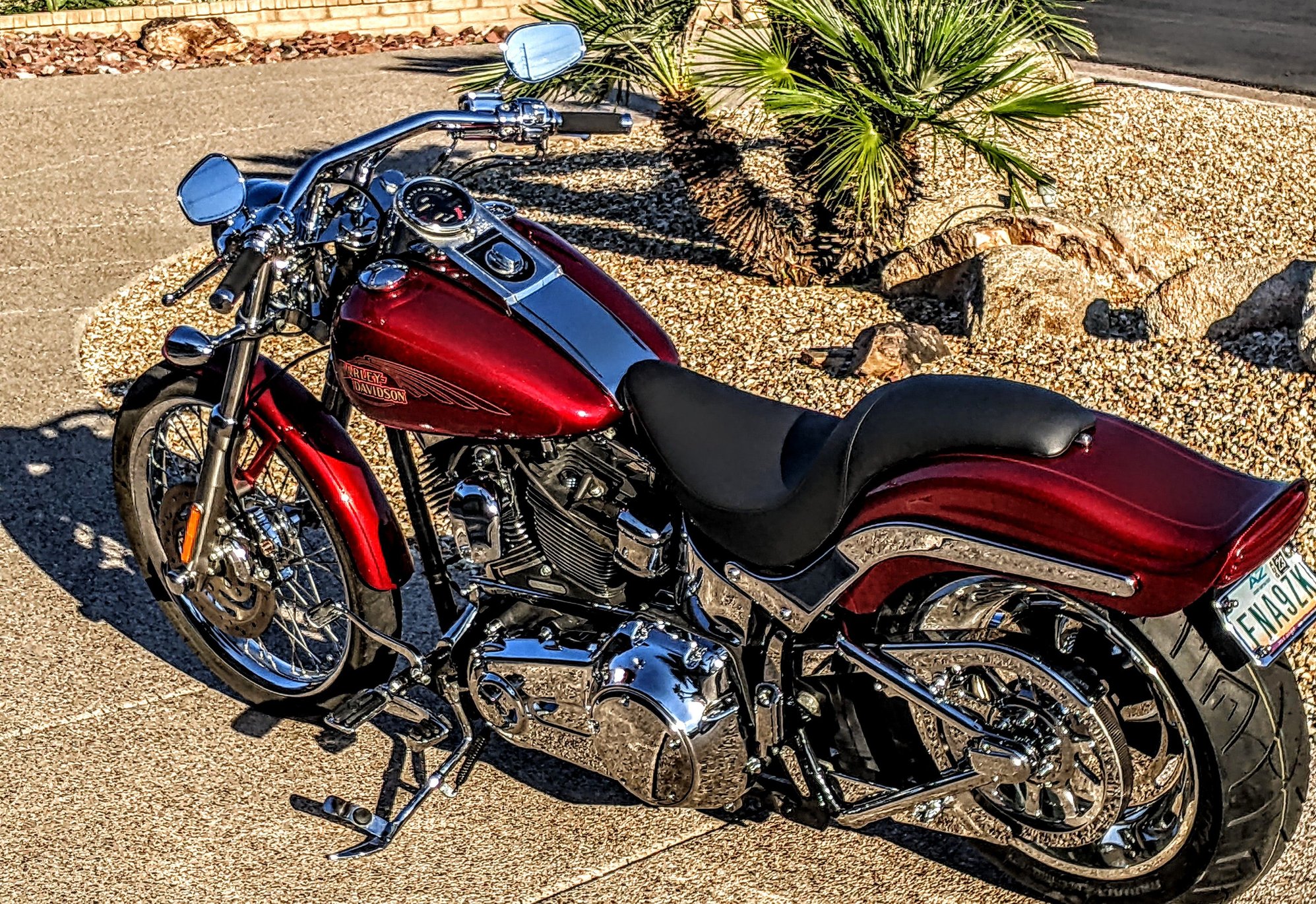

I'm changing my rear master cylinder to chrome on my 2008 fxstci and was wondering if it would be ok to use a 3/4 bore mc instead of a 5/8. Would it stop better with less peddle pressure?
