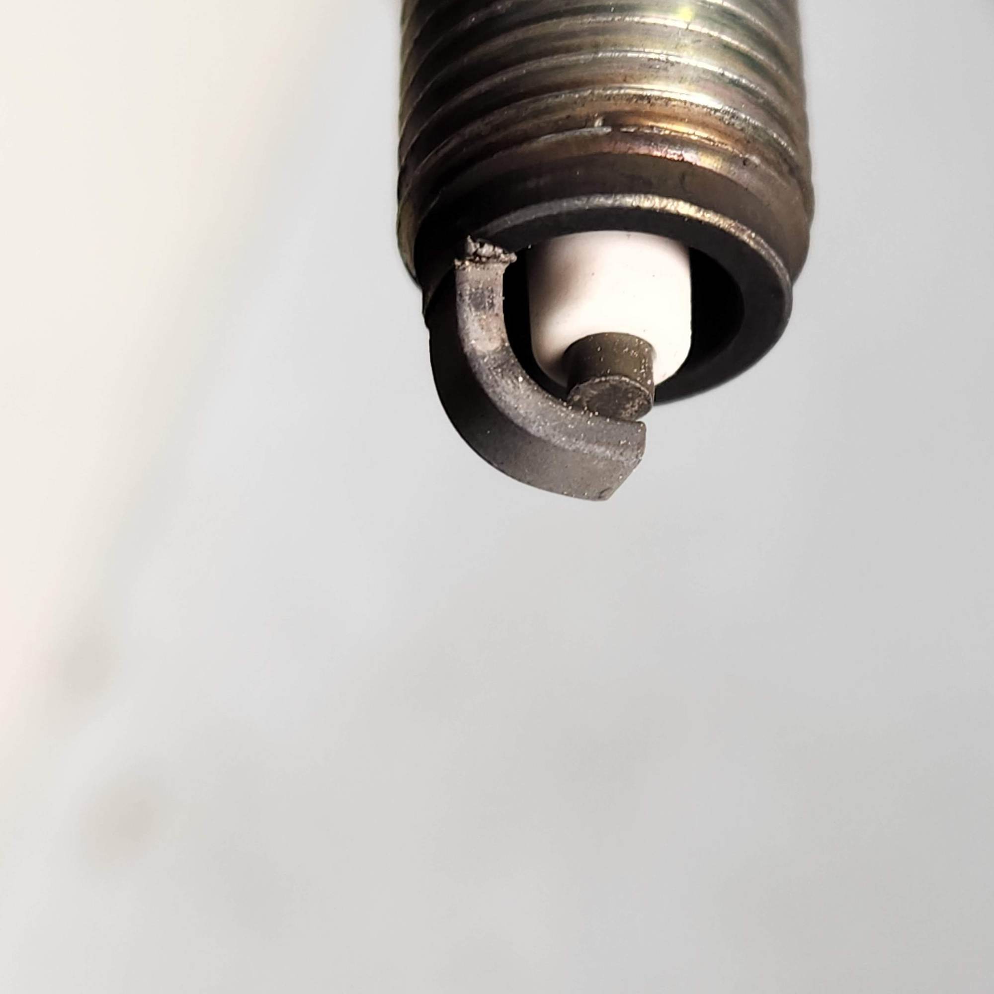

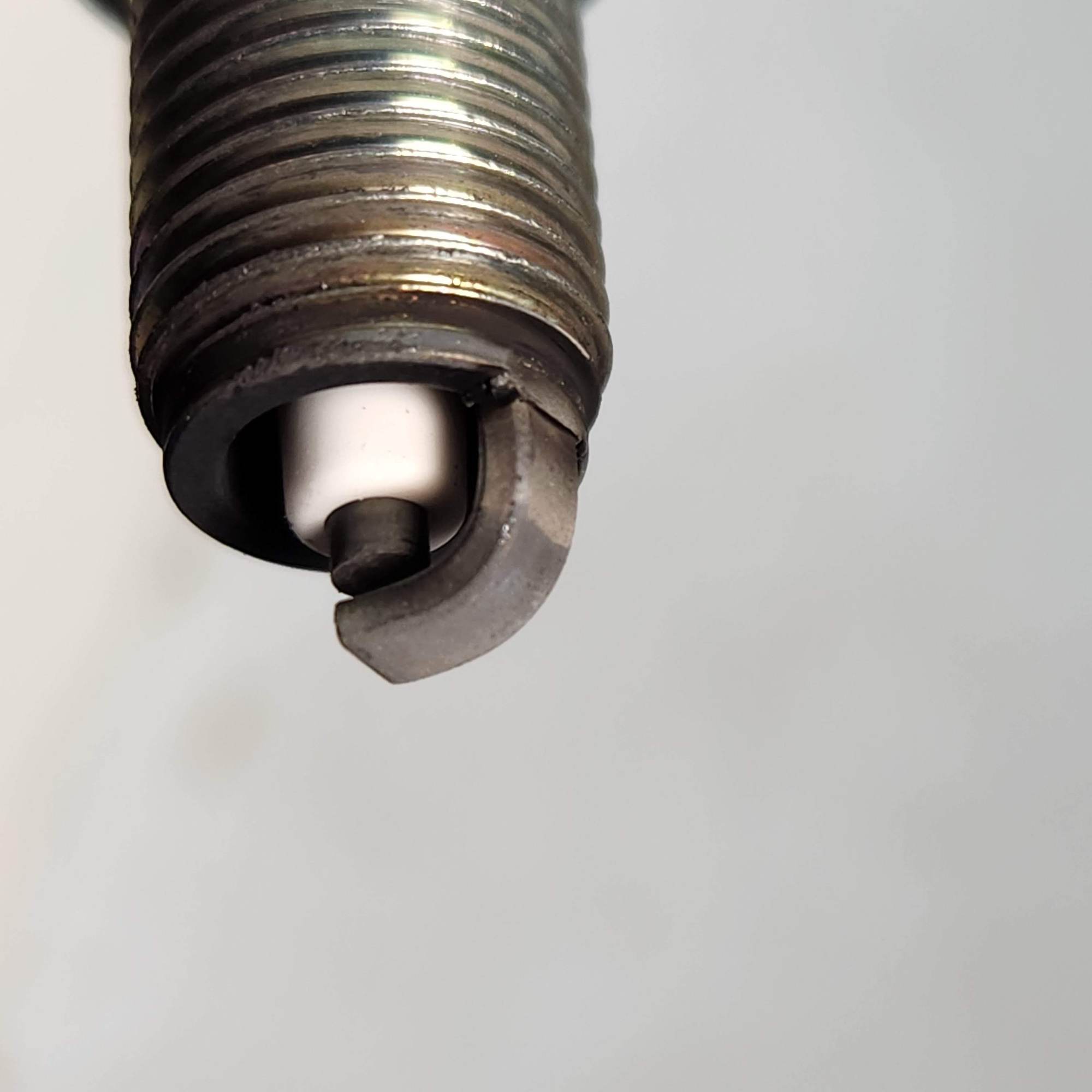

This is what hey look like after 150 miles.

NOTE: I am not an expert at reading plugs.
I have read a lot about it over the years, and there are various experts who will disagree on some of the minutiae of what various things should look like.... I've also read that slow speed running and idling can alter how a plug looks when reading them.
However, unless there was a lot of slow speed running and idling in those 150 miles, those look pretty good to me......
I certainly don't see any of the red flags I've read about that would cause me alarm.
If it's running & starting well, along with those plugs, I'd be satisfied...
Hopefully someone better trained/experienced in reading plugs will chime in...

No low speed running/ idling. Mostly back road riding , average 40-55, some hard riding mixed in. Thanks for your input, I appreciate it.
