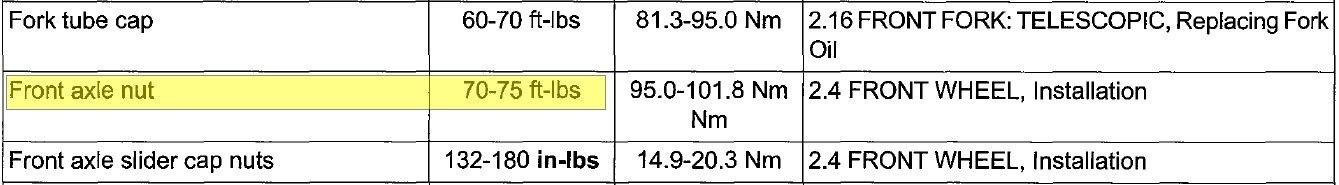

This is from the 2012 Softail Service Manual

I have 2011 manual and it states
Front axle nut 60-65 ft lb all but FLSTSB
Old Mar 6, 2023 | 09:08 PM
Hog Augie's Avatar
Hog Augie
Joined: Apr 2020
Posts: 101
Likes: 77
From: Central Okanagan BC
To continue (lol hit submit before finishing)
same 60*65 ft lb for 2.5 front wheel FLSTSB
So same for either one
