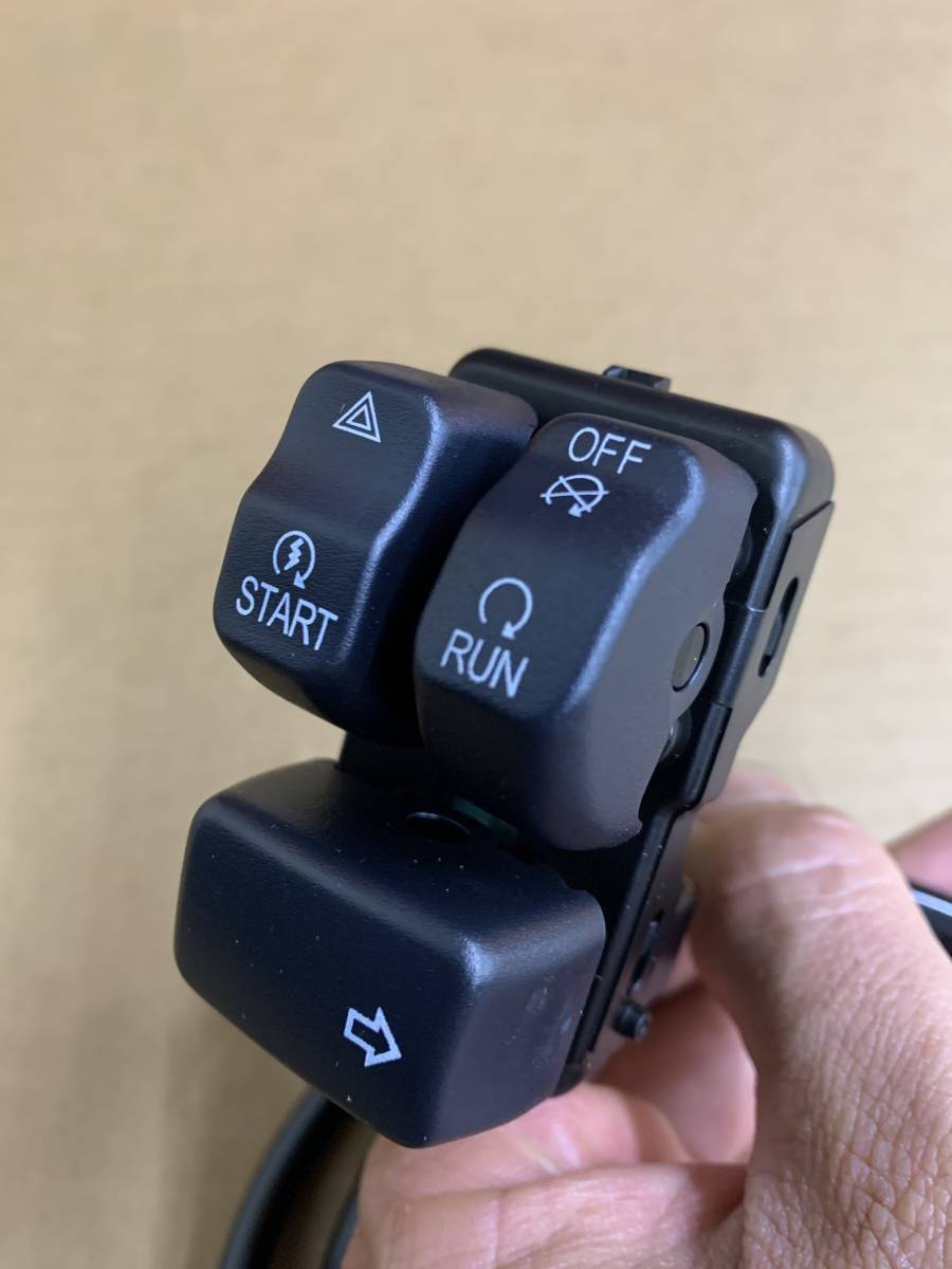

For anyone looking for handlebar control module.
Quick explanation of issues. Have 2014 Heritage Classic and right side switches quit working.
Ordered Harley part 72948-12 for 2012 to 2015 years to replace it. $350 for the part, its on back order..
so instead of waiting I went to the dealer and bought 71500297 for years 2016 to 2020 for $200, the dealer had it in stock.
It was a perfect replacement part and works fine. Only difference is the decals on the switches them self.
I will switch the switch buttons and all will be well.
This should be a work around for all the CAN bus type switches.

Nice find....
Other than the word "start", it looks to have the proper symbols in the correct places...
