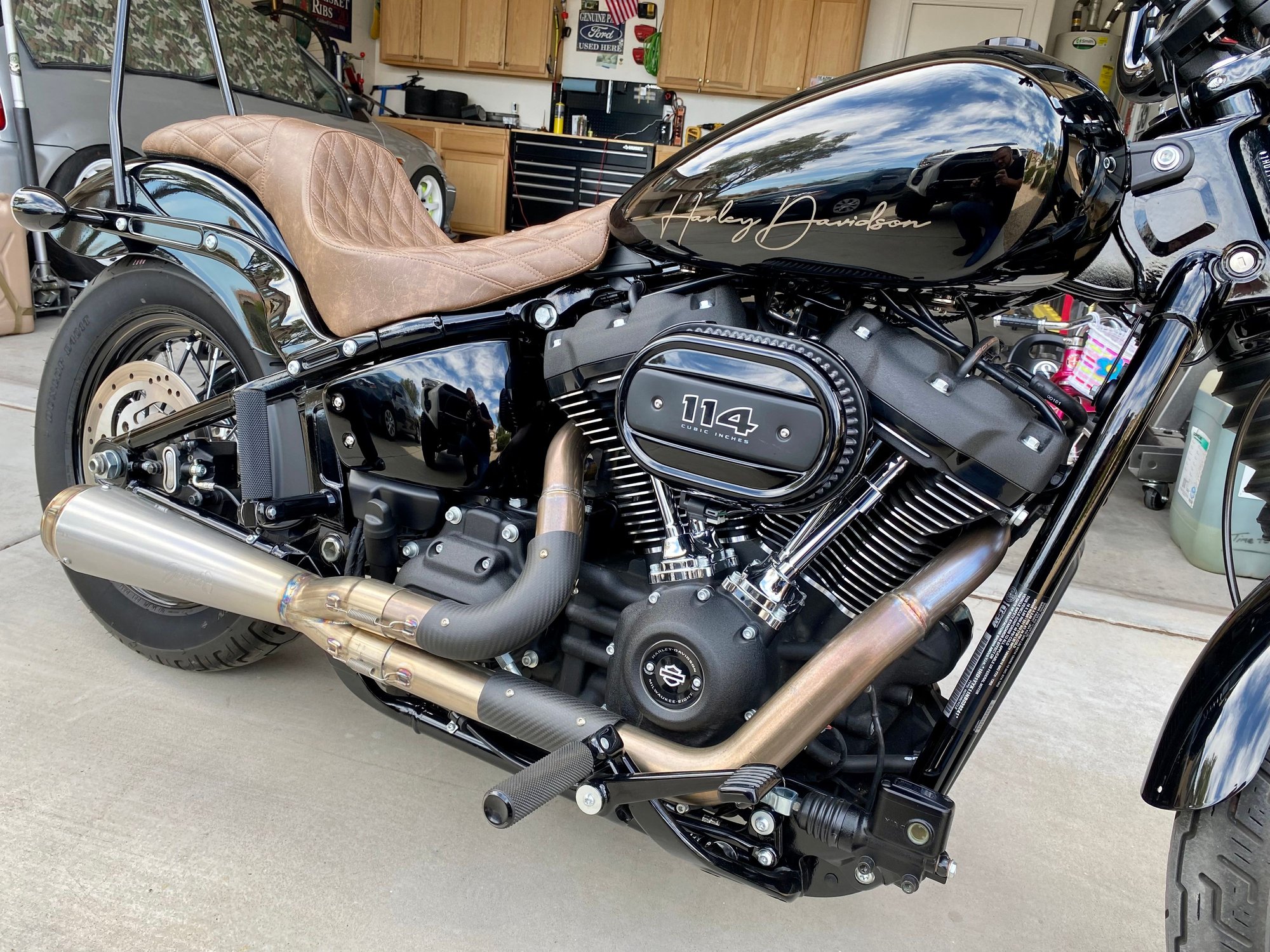

I just bought and installed Vance and Hines short shots on my 2022 street bob 114. The kit did not come with a relocation bracket for the rear passenger peg on the right (exhaust) side. Anyone know where I could get a relocation bracket for my rear foot peg and even a part number and recommended site? Thanks in advance!

Mount it up higher in the threaded hole. Mount both sides in the same hole so the pegs are level.
holes should have a plastic plug in them.
I moved mine up. No extra parts required.

thanks so much. I won’t be able to work on it again until tomorrow but I’ll definitely do that. Glad I don’t have to spend more money especially if I can do it with the things that already exist.

Hey, I know this is an old thread. Just curious what exhaust that is? Looking for something like that for my M8 Fat Bob. BTW nice bike

Think i just found it, Jackpot RTX Riot 2-into-1 shorty?
