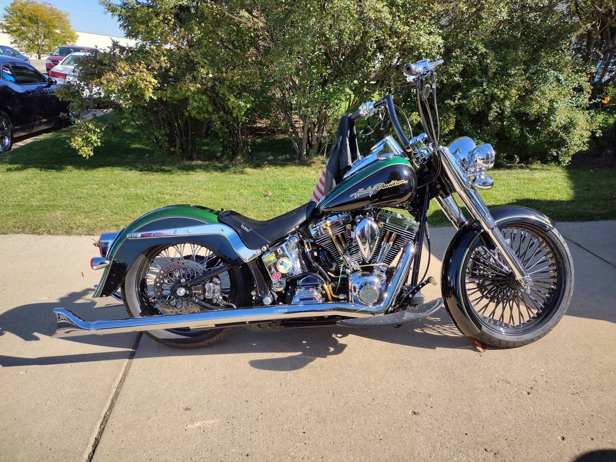

Originally Posted by Jshopes
itll look cooler but its going to ride like crap at that length shock.
I lowered my Deluxe 2" in the rear, then put an18" tire in rear and 21" in front. It rides great and handles great. I have ridden it this way now going on 3 years. I could not be happier. Then I went against all things holy in the Harley big bike world and lifted the tank 2". .
