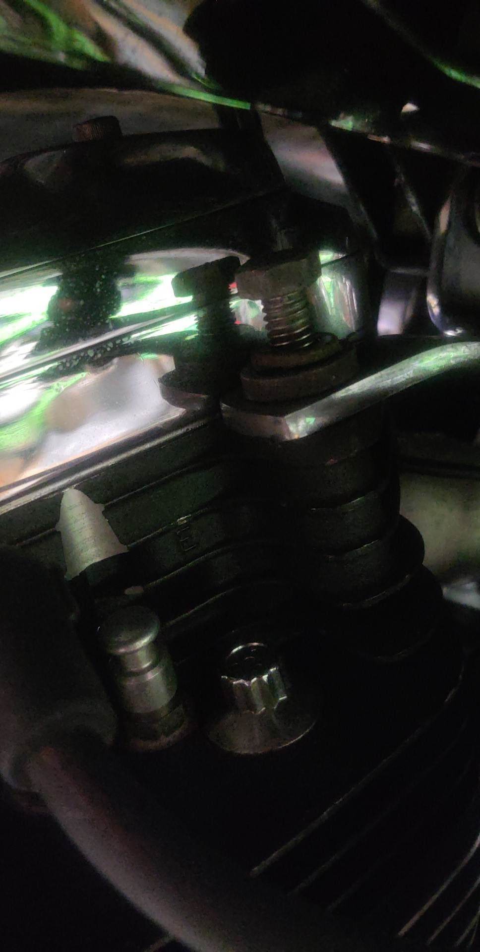

Hey guys , so I got a rebuilt 89" ran all last summer great. Changed oil recently along with rebuilding my mikuni, and ironically I'm getting super crazy vibration at higher rpms now . Was wondering if anyone had any direction on where to look . Thank you

Oh wow Im new on here and didn't even know there was an Evo section . Will do thanks . But more or less I feel it in the seat and it's distorting my vision . This has never happened before . But also hearing it rattle kind of by the headlight and the mirror is impossible to look through at higher rpm. This is all new from riding it all last year when I put my rebuilt motor in April 2022. I almost thought it was the wheel or something at first , but when u switch gears , it all goes away until I'm guessing I'm around 4000 rpm

Seat was never off. I did use a purging puck connected to the oil filter just to purge all the old oil out , but I had my oil tank filled with oil while purging out the old oil and topped off with more new oil. Can't imagine that did anything it shouldn't have ? But in neutral in the garage , I raise the engine rpm and my sissy bar is vibrating like crazy also . Will try and find the Evo section also . Thanks for any pointers

You guys are awesome . Not sure how I over looked the one bolt going into the head but it was hanging halfway out , and the two piece heavy duty mount that I have it was also loose where the two pieces are matched together with a bolt and thread locking nut . Can't thank you guys enough for looking after my post and problem .
