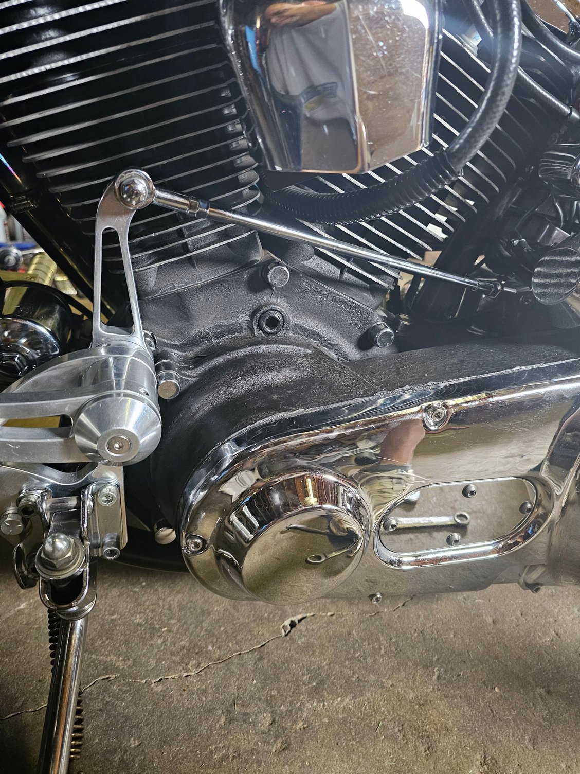

I think you are condemning the transmission way too early.
First disconnect the shift linkage from the lever on the transmission.
Make sure the linkage moves freely.
Check the shift lever on the transmission, make sure it is tight on the shaft, absolutely no wobble.
Let us know the results.

I sent u a message with a picture

Please don’t be shy I like seeing pics like that and learning. I’ve assembled and blue printed a stock 4 speed, I did a 5 in a 4 from swap meet parts that turned it great and I just did a 6 speed gear set with a few baker upgrades.. don’t keep me in the dark lol.

There the pic of the new controls. The guy screwed me over , took it home even left the shop it wouldn't shift up at all. I told this person it not working he said it me......I'm so upset at this person his dad built the motor great guy...he passed away he knew how to fix all bikes...I know his dad wouldn't let this go out like this.....my old oem he has won't give back unless small claims court or the sheriff go with me and get them.

So are you thinking the really tall lever is at an exaggerated height, making it hard to shift? Any chance your talking about Mr Harris passing? Are you near Shelby Ohio?

Tell us the whole story here...
Was there a shifting problem before the aftermarket linkage was installed?
