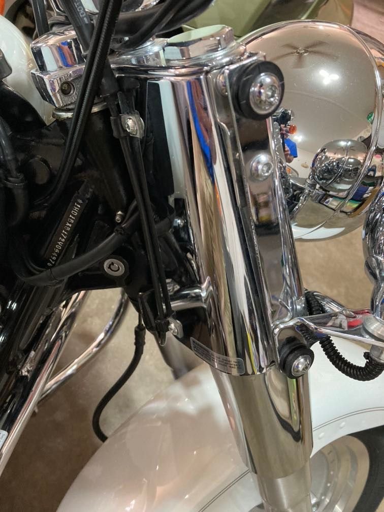

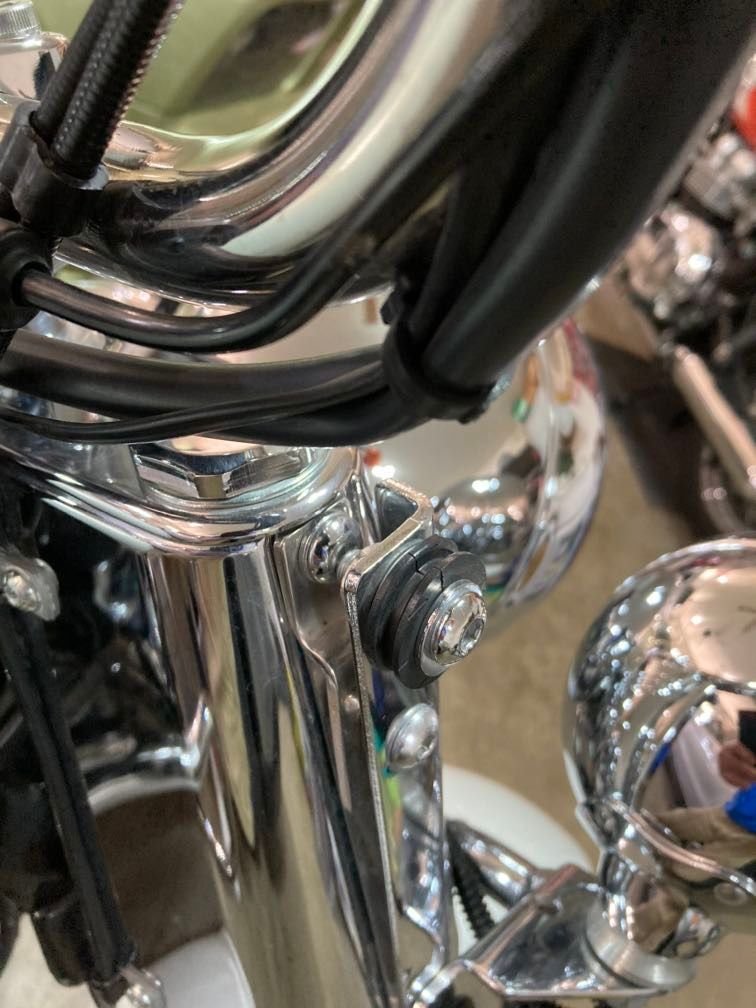

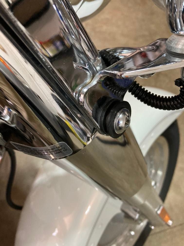

Here are the mounts for my HD windshield. Hope it helps a little. I have never had them off but appears they are a shoulder bolt/cap screw with a grommet.

Thanks, helps to see how the original setup is. Mine is a bit different since it doesn't have the headlight nacelle, but I got it to work, should be much nicer on highway trips now
