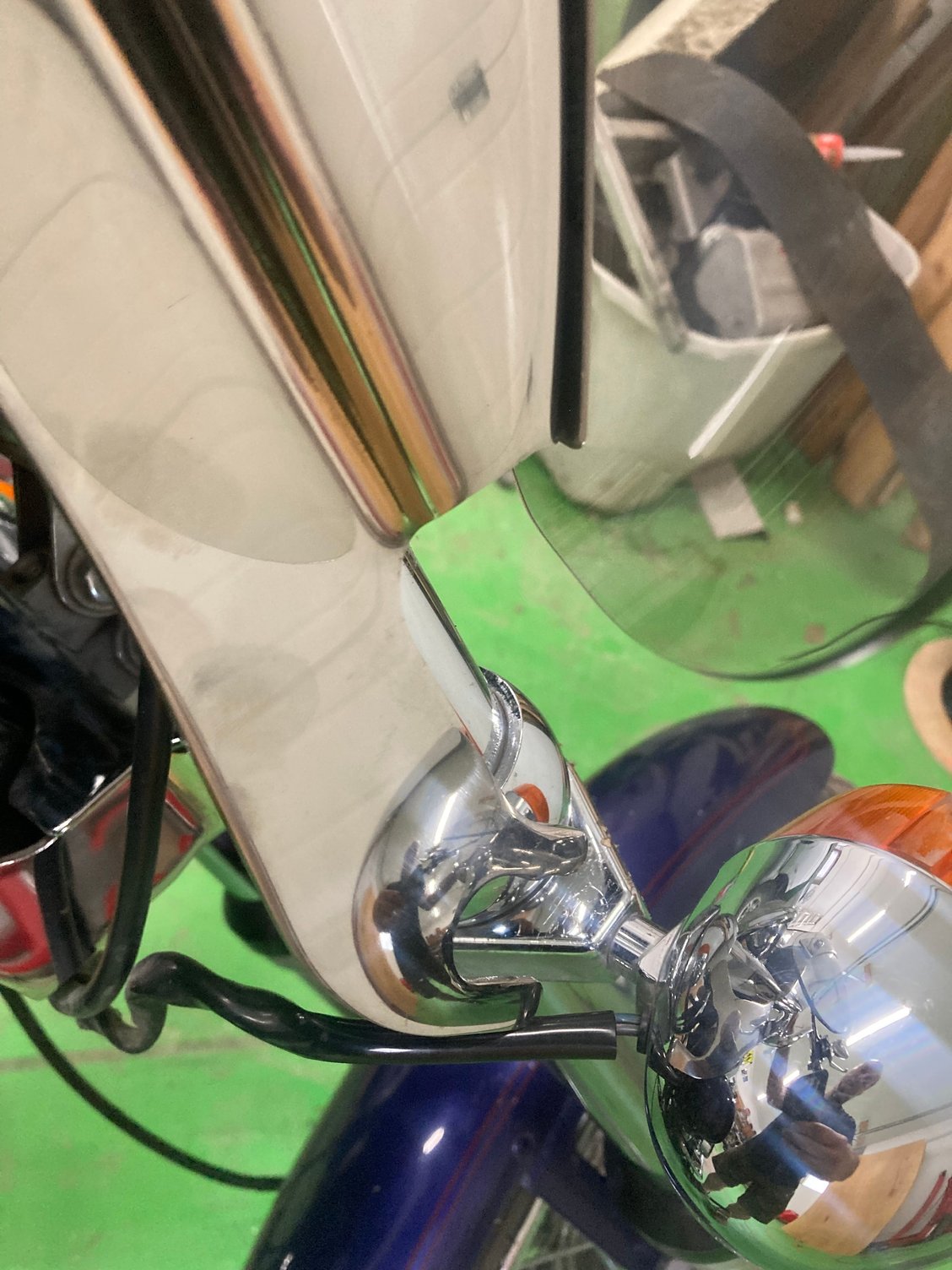

Has anyone converted/used the camlock style mounts that clamp to your fork tube to mount a windshield setup like this one?
I got this from a friend, its genuine HD but was on his fatboy, I'm putting it on my '99 softail. I can get the top mounts to work, but the lower are wider than my forks, It looks like the clamp style will line up, just want to see if anyone has done it before I order parts

Softail custom, yes the front end is narrower, main problem is that the lower mounts don't line up with the tree at all that's why I'm thinking of getting the fork tube clamp style then putting the grommet mount on the clamp for the lower mount, just wanted to see if anyone has done this before

I think I can grind down the signal light mounts and put the mounting grommets on them for the lowers, but it won’t be tight to the forks, I’m wondering how stable it’d be?

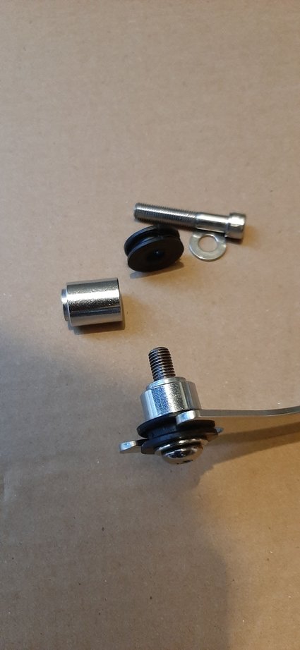

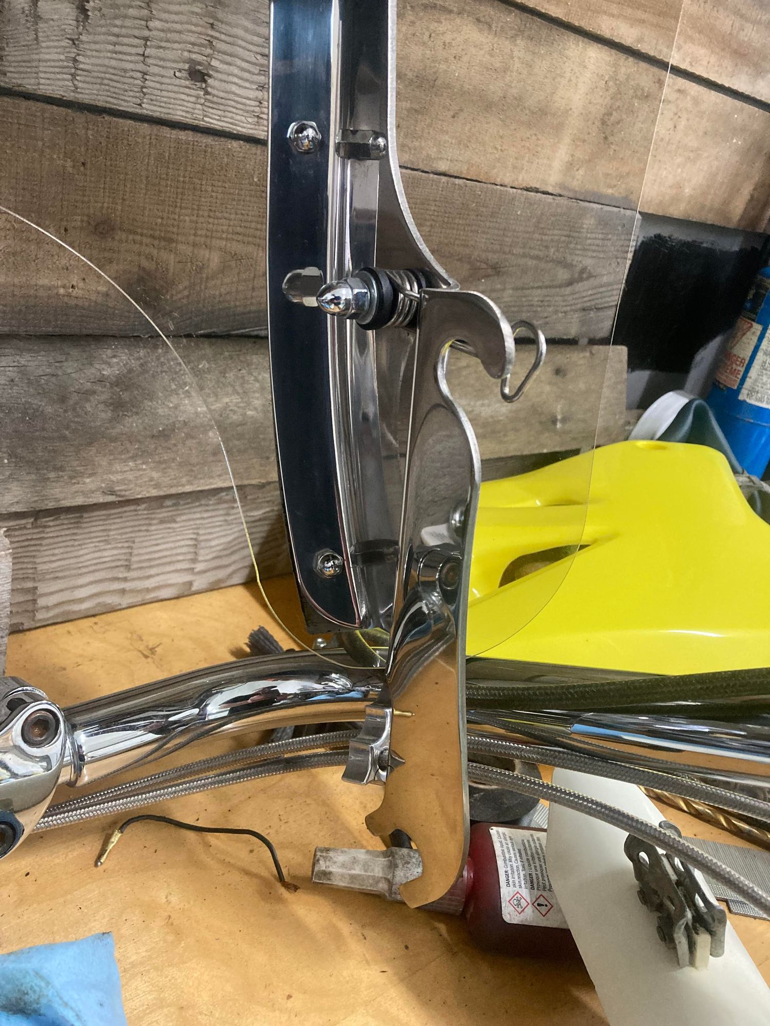

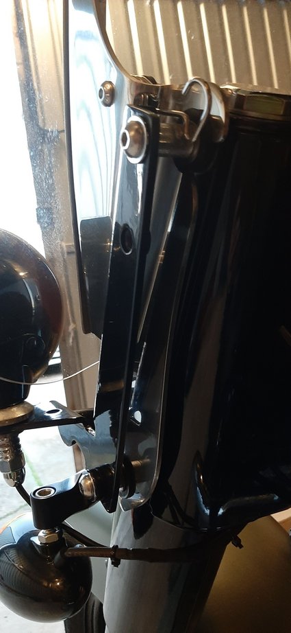

These are the mount's I Spoke of.
The mount set for deluxe or fatboy. The fatboy uses the spacers under the black grommet and the deluxe uses the grommet straight on the passing light mount points.
This is a slim with a custom mount set-up where passing lights have been cut and widened to allow a winscreen i already had to mount under the passing lights.
I wouldn't recommend any grinding...
If you need to ask I would recommend you purchase mounts that suit or sell the windscreen and buy the correct one.
I am old with a lathe and experience. It makes a difference.
Hope that helps!

This helps, thanks. I just wanted to see the spacing on how the mounts work with the softail front end opposed to the fatboy.
What I meant by "Grinding" is that I'd just make the signal light mounts a bit narrower since as you may be able to see in the pics, they're just a bit wider than the lower mounts on the windshield, the grommets would hide any modification when installed. I don't have my lathe operational yet, or I'd just chuck em in and turn them down.
