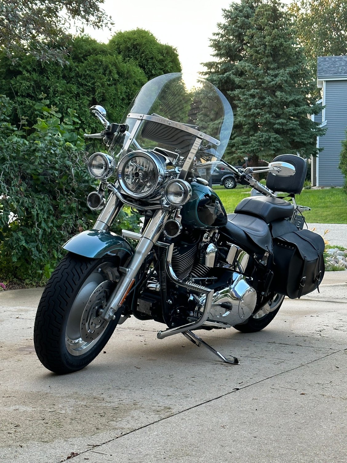

Suddenly my 2000 Fatboy started sputtering at take off from stop. Let it idle up some to get to 5th gear. Then ran fine. Every time I stopped at an intersection, I had to feather to get it up to speed and at times, it just kicked in and road fine. Only thing I found of the carb was the vacuum slider had a pin hole in it. Slapped a tiny piece of first aid tape on it and got half way 15 miles home and it got to the point where I pulled carb apart the first time to see what the hell was going on. Idles, just won’t take off without sputtering. At times it would just light up and go. Trying to think about physics as im trying to pull away from stopping. What is the common? Id say throttling up is consistent. Sputters until I get it up to the speed limit, which was 50 in the county.
