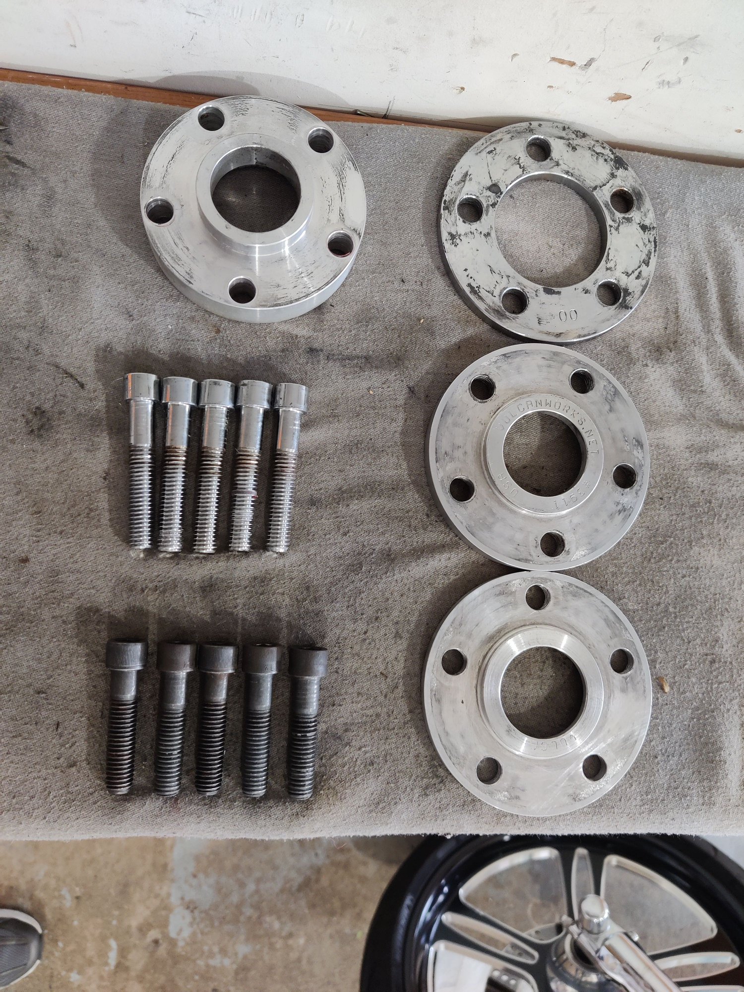

Okay on the left are pulley mounting bolts 7/16" by 2" socket cap screws they're grade 8, the chrome ones are grade 5 and they're 2 1/2", Keep in mind you're going to need the hardened washers to mount that sprocket to the rim, regular washers aren't going to cut it.. Albove that is for a 99 down rim 2.0" hub x 3/4" spacer and then on the right side are 1/4" and 3/8" spacers but are for rims that are 2.2" for the mount ring of the pulleys or sprockets.. If any of this can help you let me know.. if you're going to use the older 2.0 equipment for Evo on down you can always get the spacer to make the 2.2s work..
Yeah I do have the engine spacers both in a kit with .010, .020, .035 and .065" and 2 loose that makes your .050" exact, all new.
Rear's 1/4" & 3/16" both, 2.125" Id x 4-1/8" @ 1/4" used. 3/16" = 2.125 ID x 4-3/8" od , new, 7/16"bolt holes for drive sprockets.
You want pm me I won't give them away, I did buy them at some point, but I'll do you much better than retail.
Need anything else ask , I have a lot of new old stash for the older machines, repair and custom stuff, I'm in downsizing mode. Know I have more on hand than most shops stock for rebuild or repair goods.

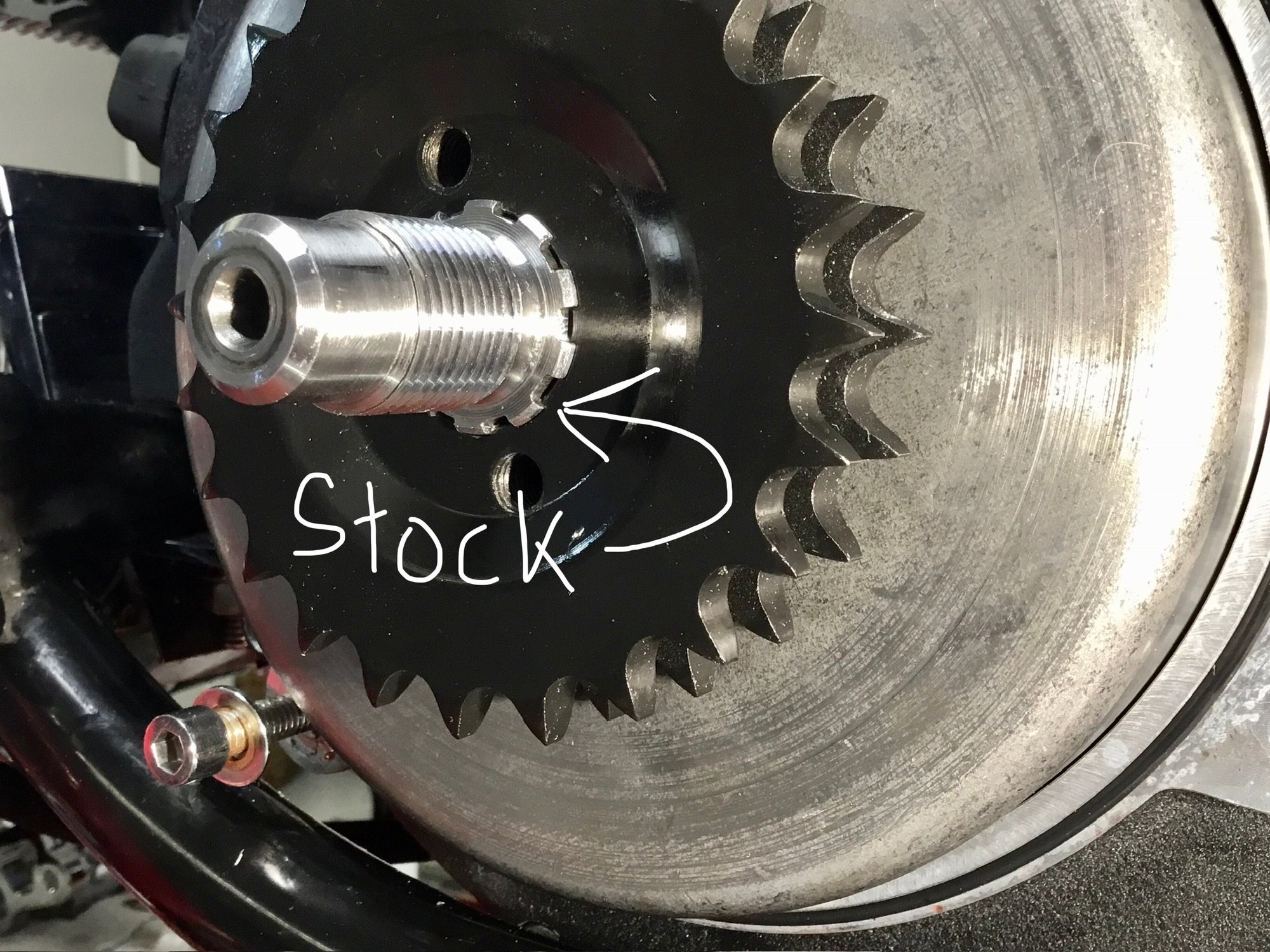

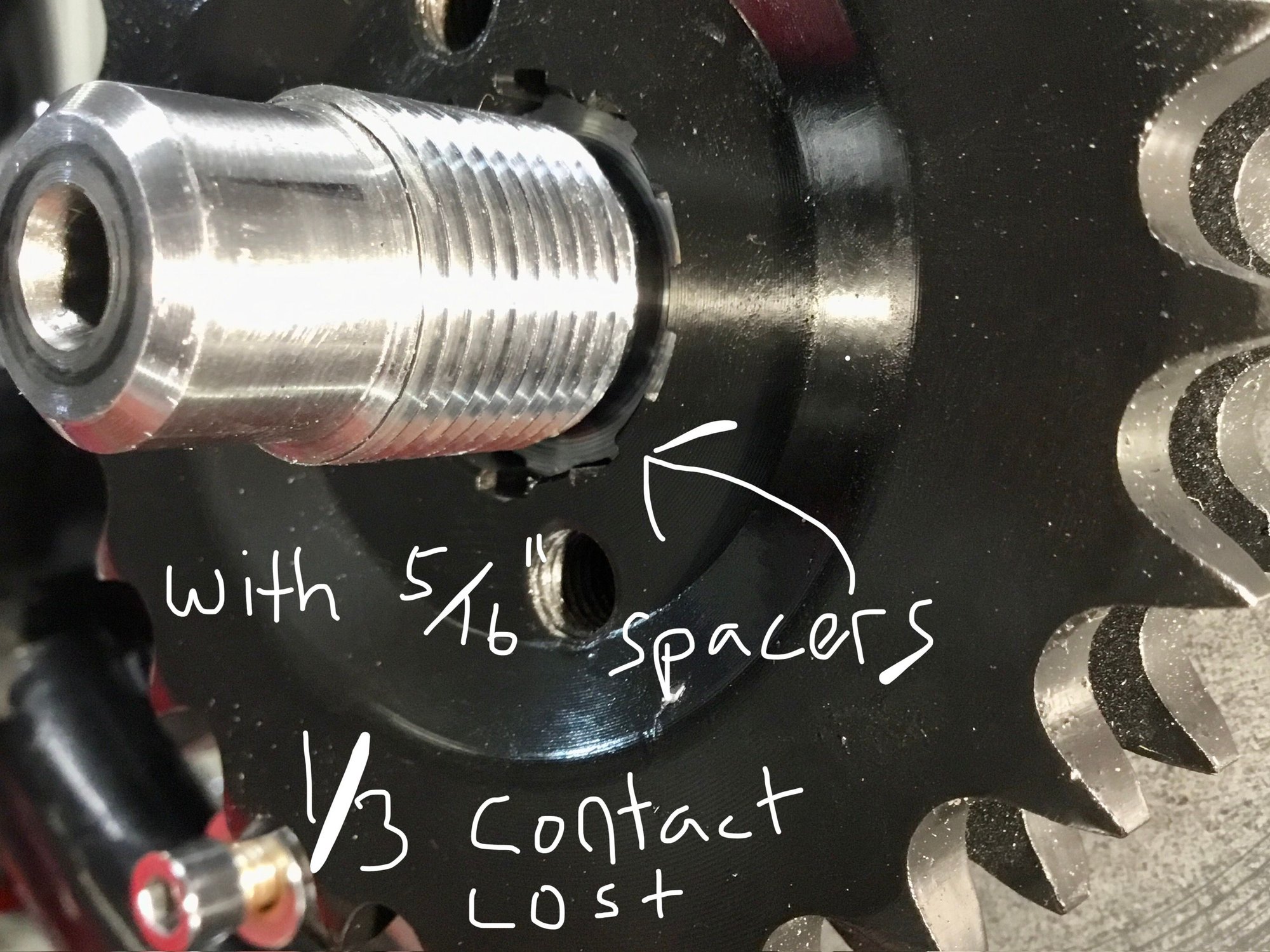

we’ll here’s my thinking on the motor sprocket shim. I need it shimmed 5/16. If I stack a bunch of shims between the engine sprocket and stator cover I lose about 1/3 of the contact surface of the teeth, Harley thought a stock motor putting out 50 hp needed it to be that thick.. so genius me puts three times as much hp and torque against those teeth, only now it’s 1/3 less with three times the power. I personally imagine that stripping and creating an expensive mess. I’d rather at minimum have as much as Harley thought a stock motor needed for power.
No clue how I’ll launch this softail compared to the shovel.. but loading the clutch and quickly releasing puts a lot of stress on those parts especially while rpm is low and torque is high with the greatest amount of weight to move.

Think somethings getting lost in translation here, I've got factory spacers up to 1/4" so I can't picture what you are struggling with unless there's a serious miss matching of parts going.
