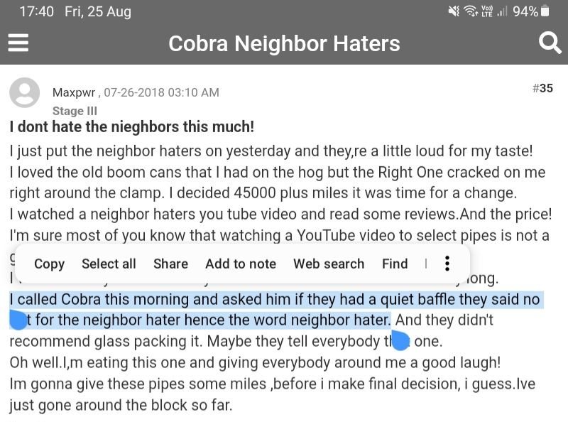

Did the Cobra Neighbor Hater slip-ons come with baffles?
If they did come with baffles, have the baffles been removed?
If the baffles have been removed, then putting the baffles back in may deliver what you are looking for.

I bought them (off the shelf)from Dennis Kirk, I assume they are baffled, I installed them as is and have not modified them at all, not removed baffles or anything like that. You did give me an idea to contact Cobra to see if they have different baffles for these pipes that might make a difference in the popping noise I'm getting.

from Milwaukee 8 (M8) sub-forum
