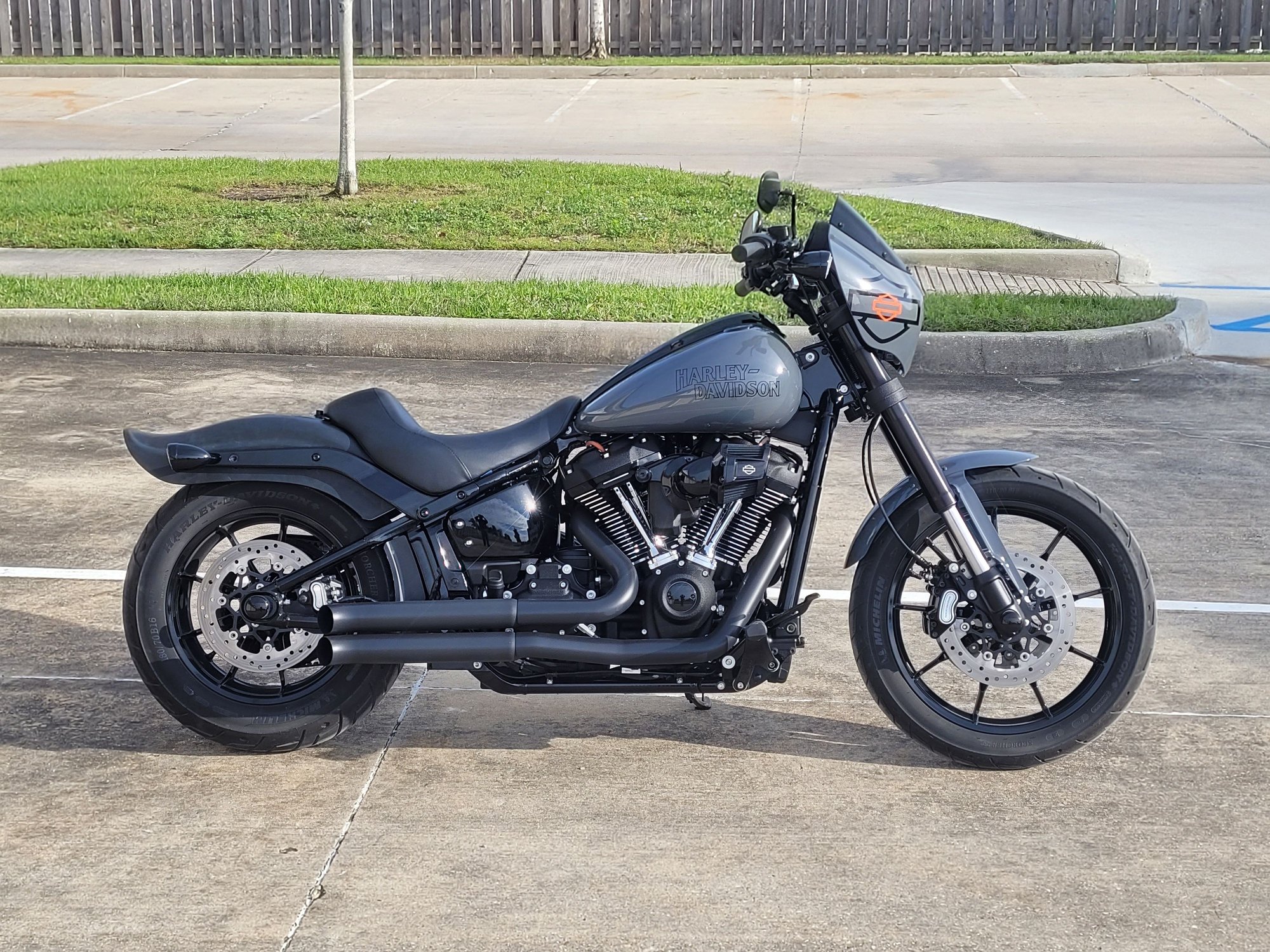

the rear can be done, the frames are the same,,, rear tire size dependent, you may need the struts as well
i actually did a 2009 bobtail rear for my fxlrs
this was during the fitting stage, and no rear tail light. i did use the Harley 3 bar LED for the 2009
