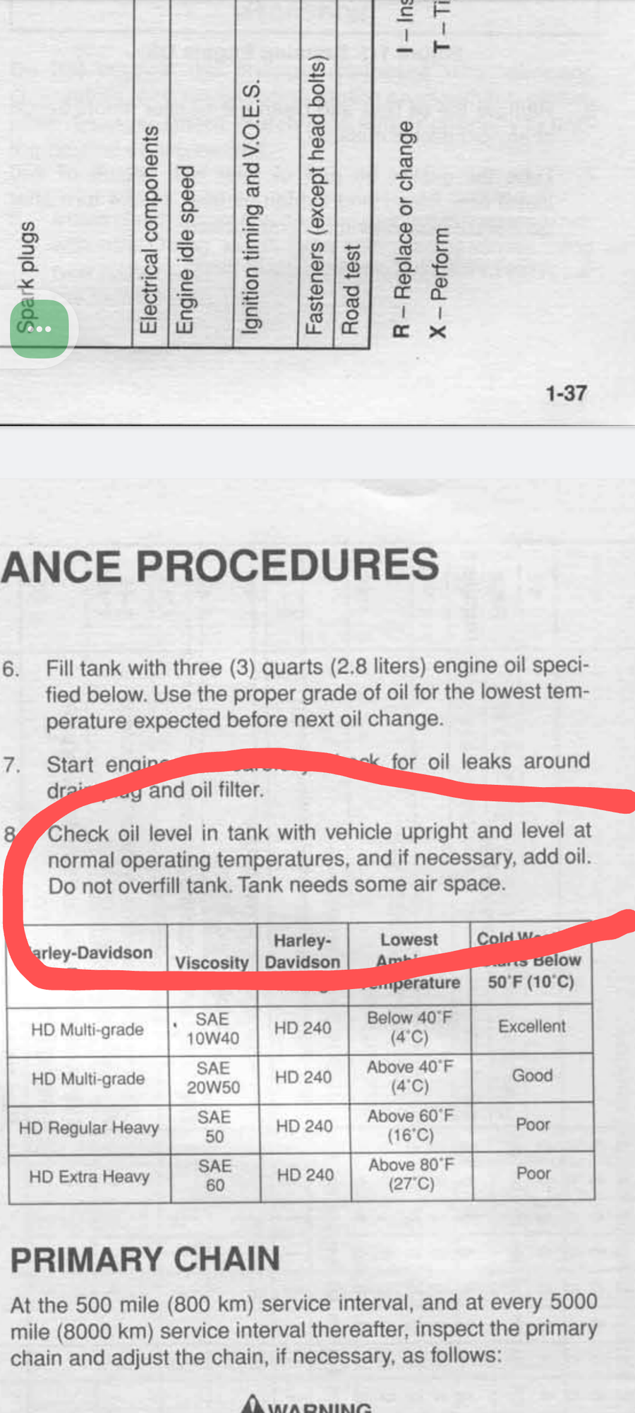

Ok so on my heritage softail classic.I changed starter and of course I had to take oil tank off and lost all the oil in it..
so after my starter replacement and putting tank back on.
The shop manual said for an oil change to ad 3 quarts.so I did. Now my oil seems to be very full.
I drained out some from oil drain hose..About half a quart.I rode bike then back and checked it with bike up right level..It was just at bottom of filler neck on tank..
I came out this morning after bike sat overnight and put bike upright.I took off oil stick and it was so full oil came out!
Any ideas why a cold check is too full on my bike and warm is about right?
Makes no sense

Ok well I was going by the shop manual 1997 and 98 softail
so that's what is confusing

Mine is a 1998
I e heard both ways on having it up on jiffy stand or up right but the manual I'm going by is 97 to 98..and my stick is solid with just one machined scribe about half inch from end of stick.Norhing else.So I'm assuming that the scribe at end is low point.
Like I stated. This is my first Harley..I've had Vulkans and
V stars and their methods are different
So when I replaced starter I had to take oil bag tank off and figured 3 quarts after replacing and never warmed bike to normal temp Not knowing about the sump oil.
That's where I went wrong because I noticed oil being dirty right away so I looked further into it and bought manual..
I did drain about a half quart out..
So today I'll ride it about 10 miles roundtrip and drain oil while hot from tank.
The I'll put 2 quarts a check it and ad as needed.
My dip stick has temp gauge on it so not sure if it's factory..
Let me know if doing oil change like this is right? Thanks

Ok, you have the correct manual for your bike. That's good. Follow what it says, and you'll be fine. Since the dipstick is solidly attached to the oil cap, you're meant to check the level with the bike upright.
Whenever I change Reaper's oil, I always start with 2 quarts in the oil tank, then fire her up, wait until the oil light goes out and add enough oil to get it to halfway between "add" and "full" on the dipstick. If your dipstick only has one mark, I would suggest you find an OEM, or an after market with the range markings. There's no way to know if that mark is the "full" or "add", although, it would make sense that it's the "full" mark, since there would be no way to know how much to add if it was the "add" mark, and you really don't want to overfill it.
