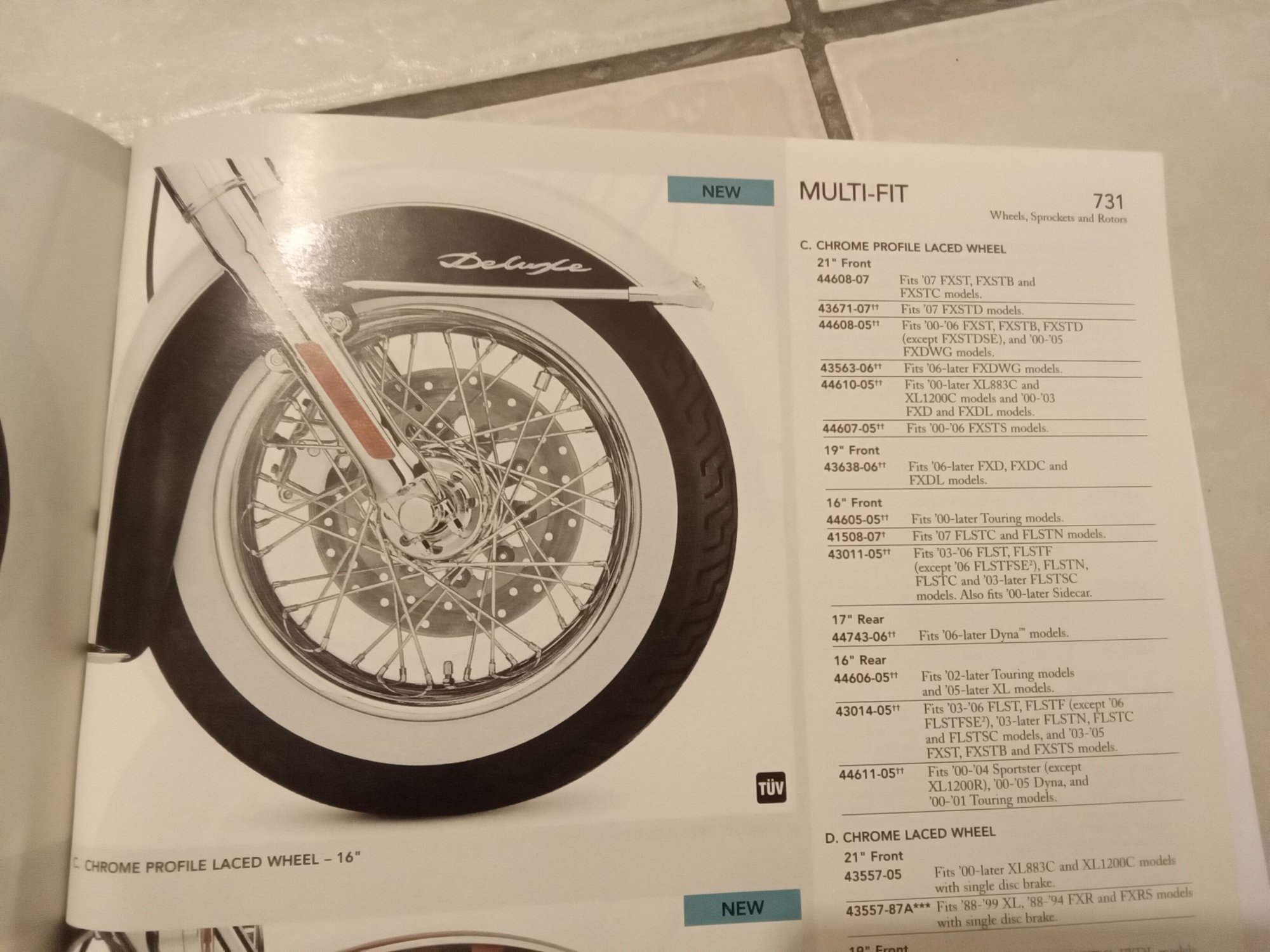

I have a 2001 FXSTS Springer and several of the front spokes have rust on them. There is a deep scratch on the rim, and the hub has some corrosion.
The bike needs new tires, so I want to replace the front wheel. The OEM version is no longer available from the MoCo, so what is a good aftermarket wheel ?
I want a 40 spoke, OEM looking wheel... nothing fancy, but a well made wheel.
FWIW for your model, GMA 2007 listed 44607-05 as an option, if there are any still around - like the OE 43676-05A it's also no longer available from H-D. (BTW the OE outer rim 43662-80B appears to still be available.)
