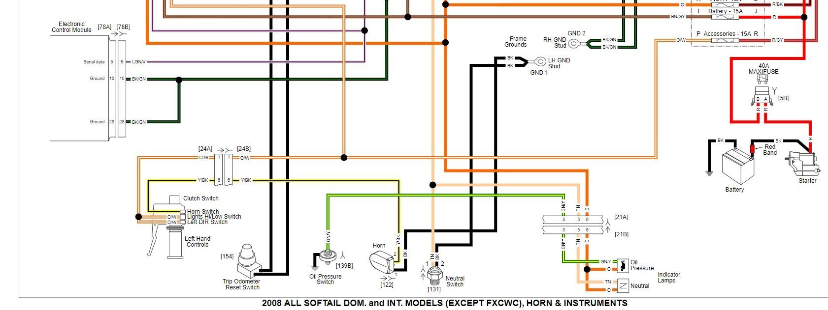

There is no relay, just a switch.
Pull the sheathing back at the switch and make sure the Orange/White and the Yellow/Black wires are not chafed and contacting each other, if the wiring is good, replace the switch.

Disconnect the horn wires at the horn.
Consider creating a simple incandescent test light and connect it to horn wires.
An old brake bulb works fine.
With ignition ON, but engine OFF
Turn handlebars left and right, use a rubber hammer and tap hard parts of bike, create vibration.
Basically trying to find location of possible wire problem.
The horn has two wires.
A ground (-) and a then one positive wire that is switch controlled.
From a distance it reads like either the switch is bad, the wires that exit the switch clamp are pinched or somehow the positive wire from switch is being energized by a break or connector fault.
If wires to bars are internally run (inside the bars) in order to give the bike a clean custom look then it is highly likely that concern is located closer to bar clamp where the wires exit.

Somewhere between the horn and the horn switch, the Yellow/Black wire is coming in contact with the Orange/White wire.
Or the switch is kaput...
