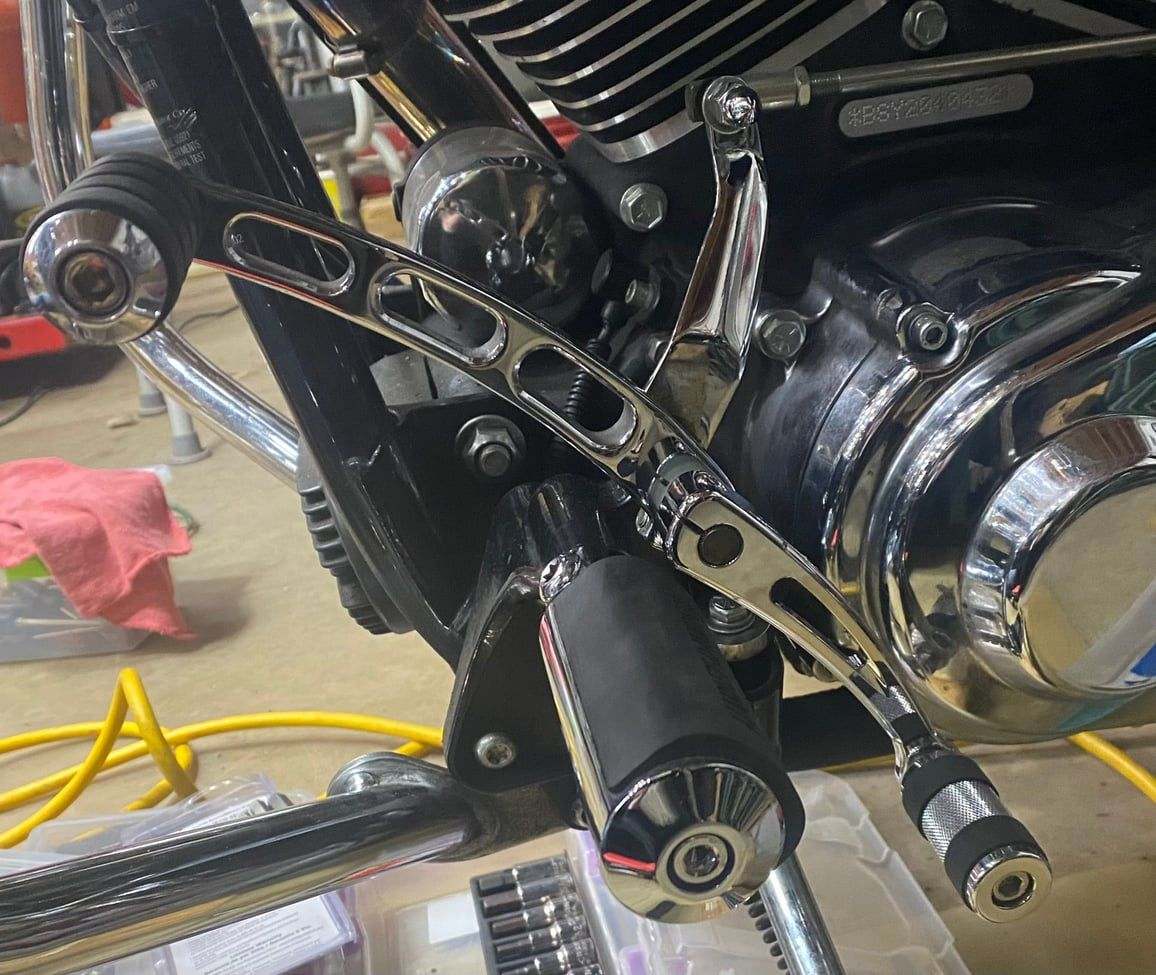

I was looking for a shorter shift lever to make a heal shifter for my Deuce. I used an inside shift lever that is used on some FLHTC Harleys. It Works great except it is not threaded for the peg. You will have to replace the peg bolt with a longer one and place a nut on the backside.

I also added a nylon washer to make the shift lever come to the end of the shaft. I got it at the hardware store for 30 cents.
I failed to mention This lever is very inexpensive.
