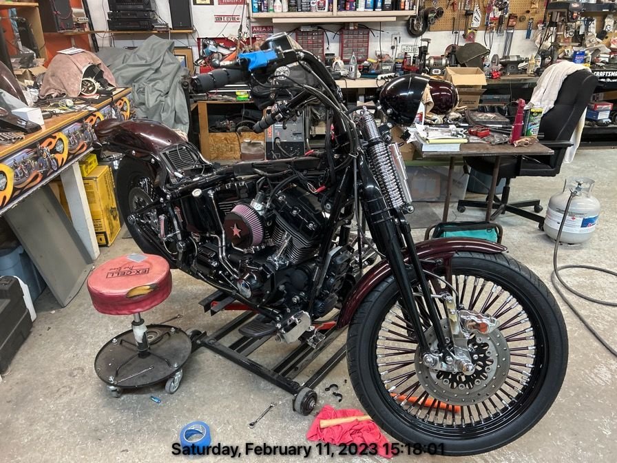

Big improvement over the Springer brake on my wife’s Springer and my 96 Bad Boy. Both of which I ran Lyndall Gold pads and HD floating roters. I did run the HHI/HD set up on theTrain in the picture when it had the stock Train wide glide on it before I put the Springer on it. Springer brakes aren’t the best but floaters and good pads do a great job. You have to realize single pts weren’t race bike stoppers. If you get every bit of air out when you bleed they do a pretty good job.
Way back when with stock front end.
