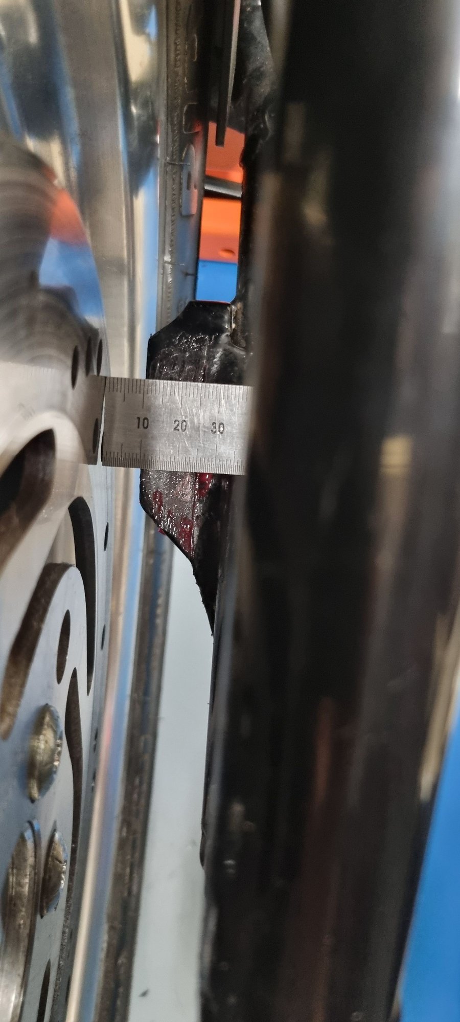

You should always check to make sure the hub widths are the same.. If they are, place the wheel in position but no axle or nothing.. Then work the caliper mount in so you can move the wheel around to get it in.. Once in position then you can slip the axle in to get everything mounted up.. again this is all assuming that the rims are compatible..
Thanks 98Hotrod, I didn't check the original 2010 wheels before I sold them to buy the FB Lo wheels that I assumed would be the exact same wheel just black instead of chrome. My mistake, because I did exactly what you suggested above - and even with the left of the wheel belt sprocket jammed right up against the swingarm, there's only 10mm of room for the caliper bracket which is off by a country mile.
they must be a different hub width. Crap. Waste of time and money - and they would have looked really great on my otherwise chrome bike.
Cheers for trying to help, unless I've missed something else.

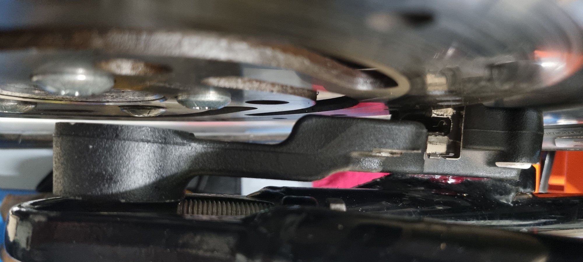

Keep in mind that the Caliper Bracket somewhat "straddles" the rotor. The rotor fits within the small "groove" in the bracket
Yeah, hub width is the same as mentioned above
My 2001 softail has that one piece caliper and mount too.
His is Two Piece

His is Two Piece
Damn, I missed that....
In the pic I thought it was a one-piece. Being two piece, that should make the caliper installation even easier...

thanks for the reply, and I've followed your method before on skinny rear wheel heritage and deluxe bikes I've owned in the past. I would have no problems if this was the case. at all, but it's this 200mm rear that's giving me problems.
Could I have put the sprocket on back to front??
