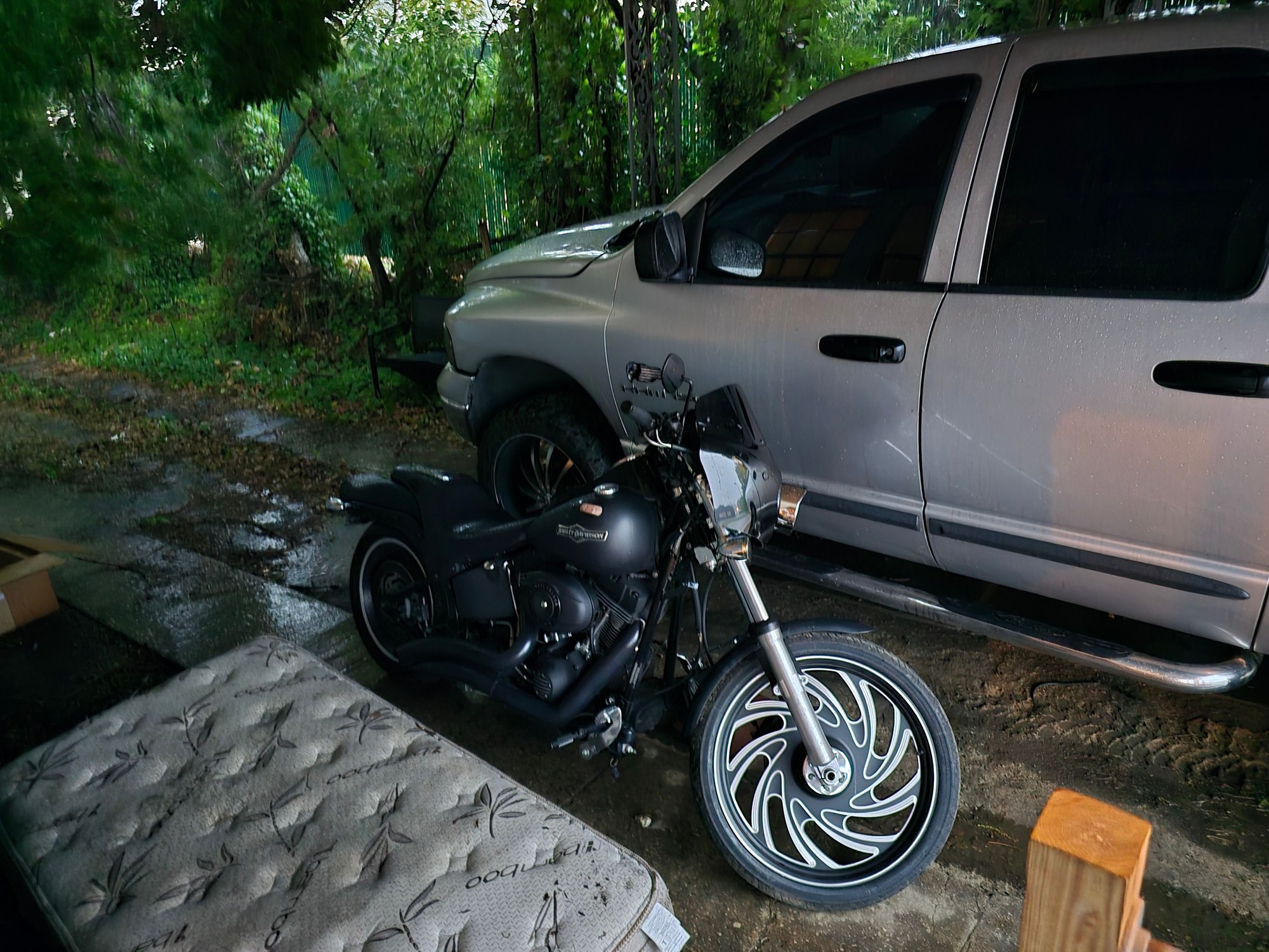

Now that's Camping

Originally Posted by Harley_ish
Now that's Camping
the mattress was there due to storm and high winds and didn't want a hard landing if bike tipped over but yea
A tie down from bike to truck running board would have been a better idea...
well winds supposed to b close to 90 mph again today and mite have wife do that since I'm at work
