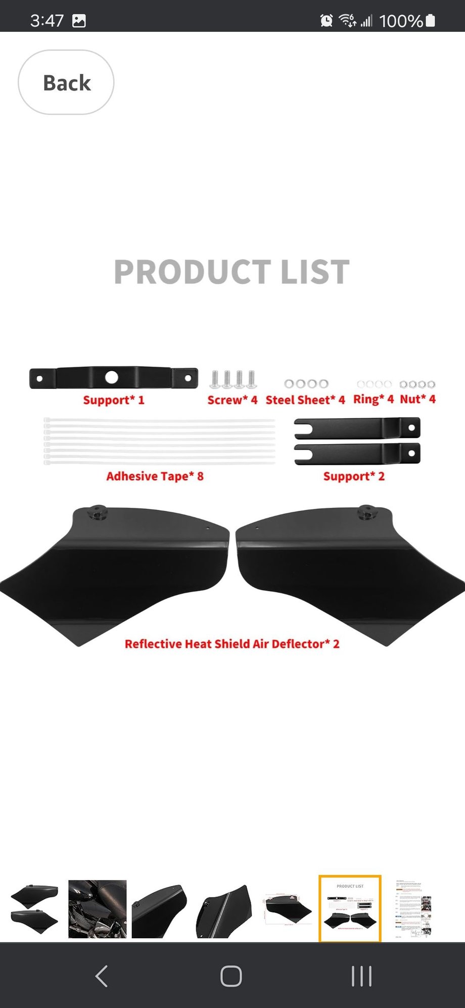

I just purchased a set of mid frame heat deflectors for my 2007 fatboy, that had no install instructions. I had similar ones on my 2012 CVO convertible which worked great, yet this model does not seem to line up correctly. There are only a few parts included, which would seem to make it an easy fix...yet I can't seem to figure it out. My set looks like this. Thanks!

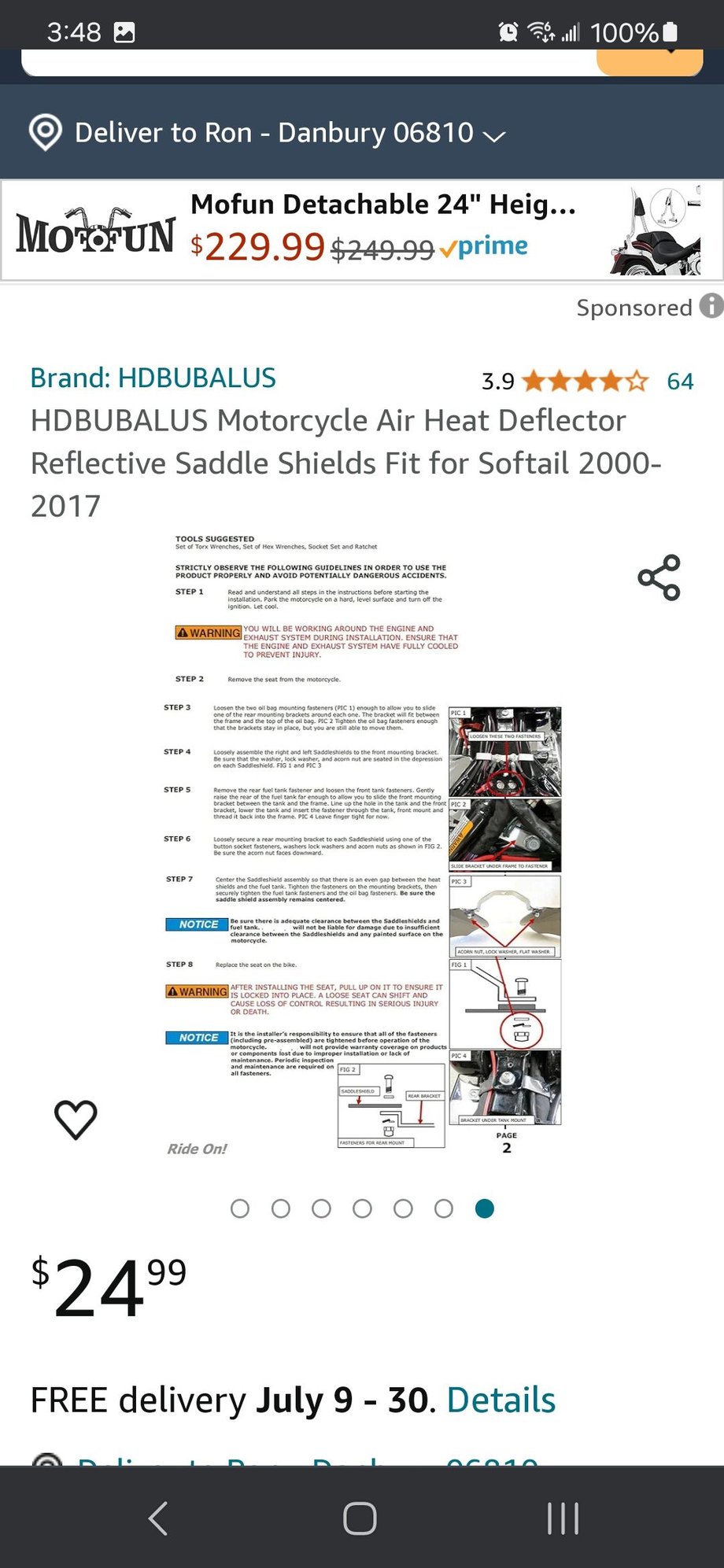

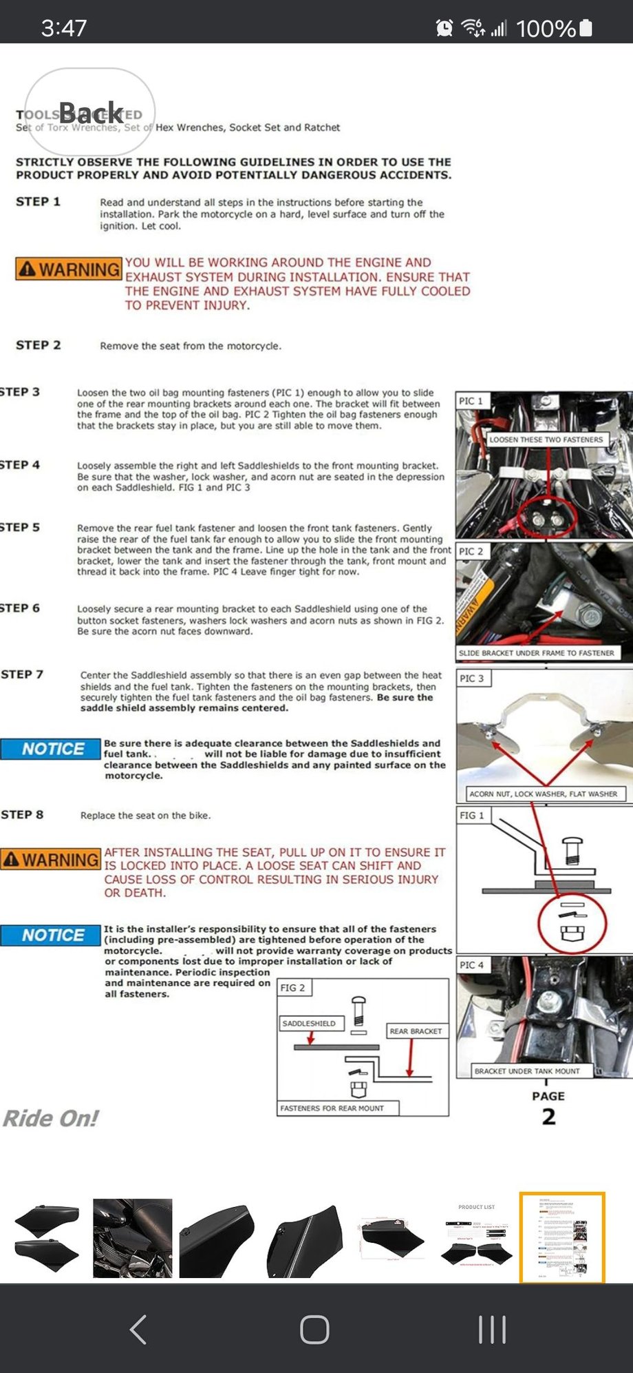

HDBUBALUS Motorcycle Air Heat Deflector Reflective Saddle Shields Fit for Softail 2000-2017 https://a.co/d/brI7saa

Thanks Ron!
