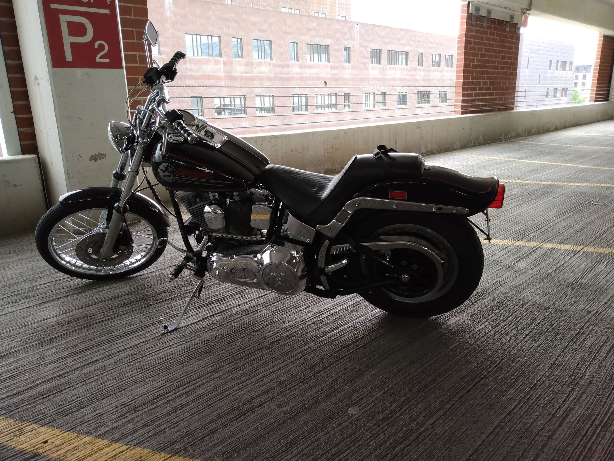

What size cam would be a decent up grade for my 97 fxstc
