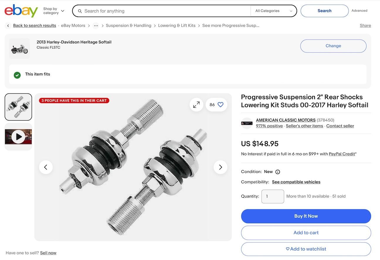

Also, look to see if you have a lowering kit added to your shocks...
There are different makes of lower kits, but it should look something like this added to the rear sock mounts...

Thanks for the replies, no lowering kit, but I agree they shouldn't wear out so soon. I'm trying to have a shop look at them, but it's been over 110 degrees here for over a week and I ain't riding in such heat!
