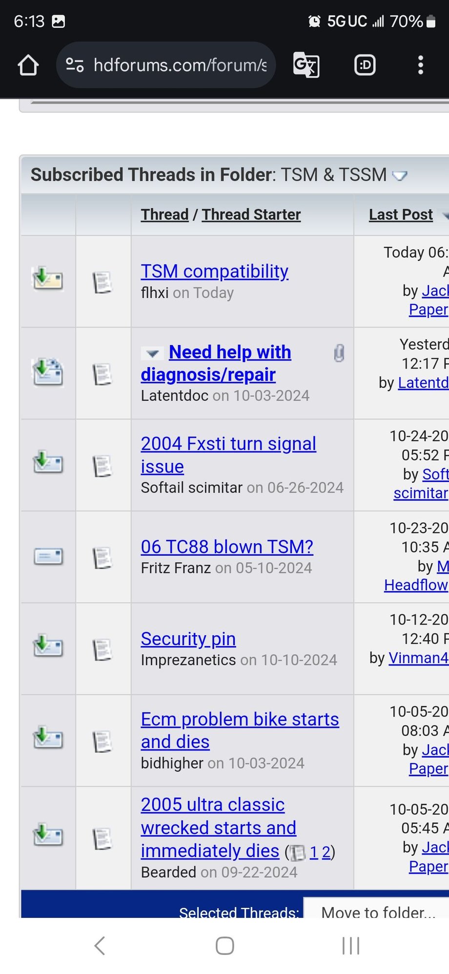

Just an opinion but if you can get a FOB, leave well enough alone. And I sure hope alarm is not set. And you know the pin.
Here is some interesting reading that may help. Been putting a folder together since parts are no longer available.
Please update this thread when you solve the issue.
