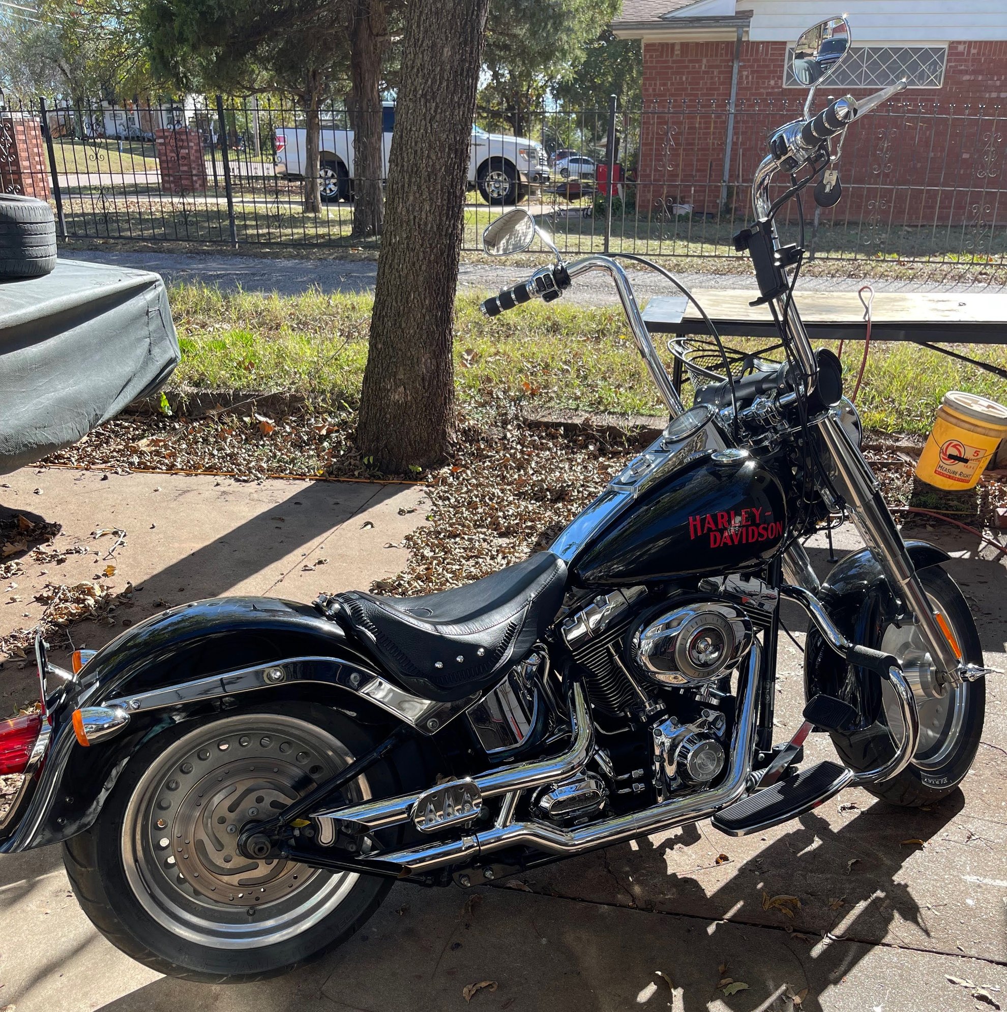

Just picked up an 08 Fatboy with 40k on it.
Is there anything in particular I should check out? I did a compression test and both cylinders were around 170. Seems to run great other than the crappy exhaust causes popping. So I hate that.
Just had a lube job, rear belt, new neck bearings, new tires done in July.
Only issue so far is it needs a new starter clutch so if there's anything particular to check I'd like to do it while I have the primary cover off.
16" apes, look pretty crazy but I'm surprised how comfy they are so far. May go to 14s though. Def need new poly riser bushings.
