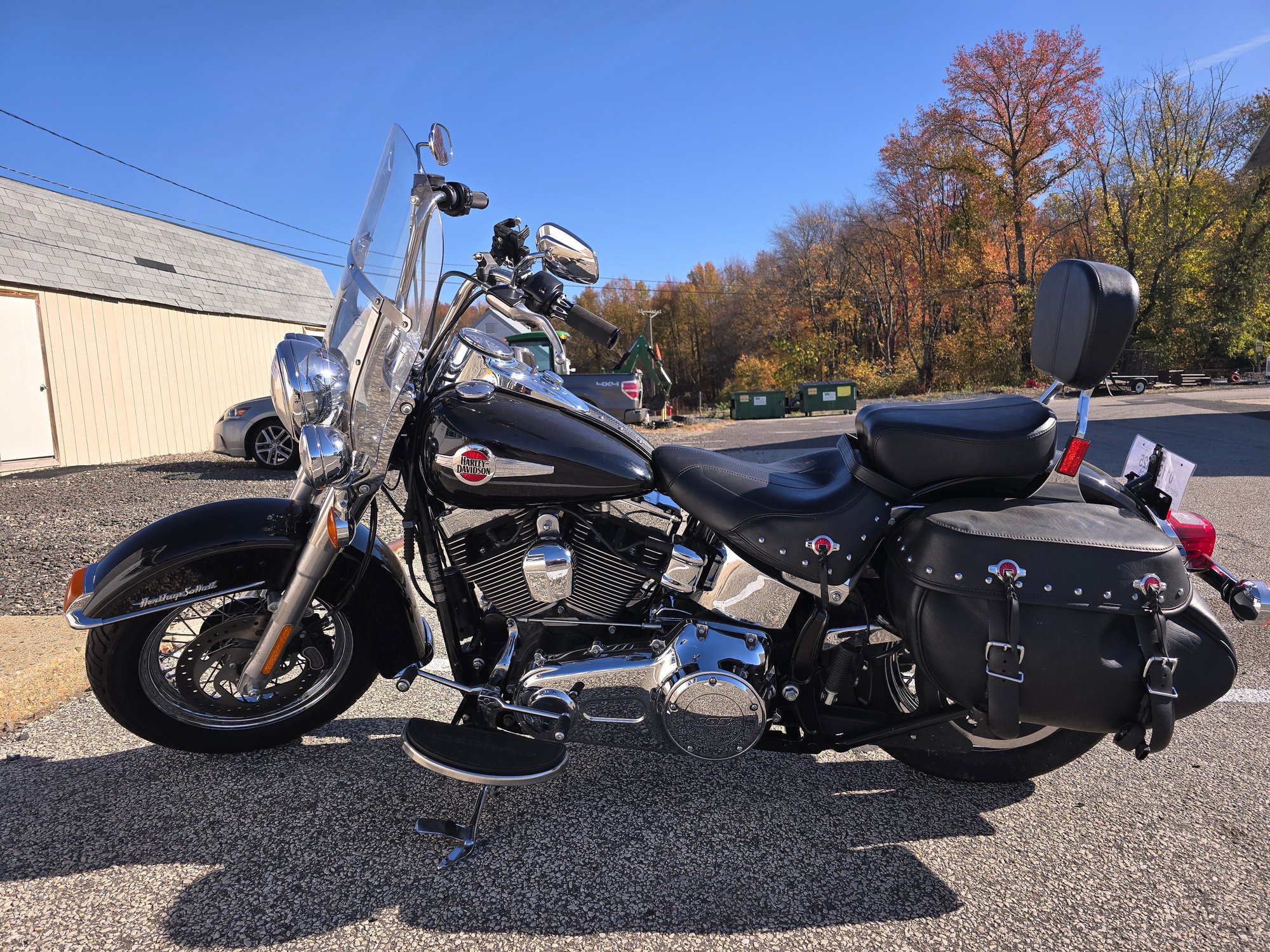

Just got myself a 2016 Heritage Classic w 19k and had bunch of goodies. Windshield, soft bags, Vance Hines pipes. Very nice but as you well know, Harleys are meant to be personalized!
Here is a pic.
I really prefer mid shift controls and finding one for this model and year is tough! Beyond tough, maybe impossible. So, I am asking all of the wise sages out there , where can I turn to for mid controls.

Thats how she came!
Thats how she came!
