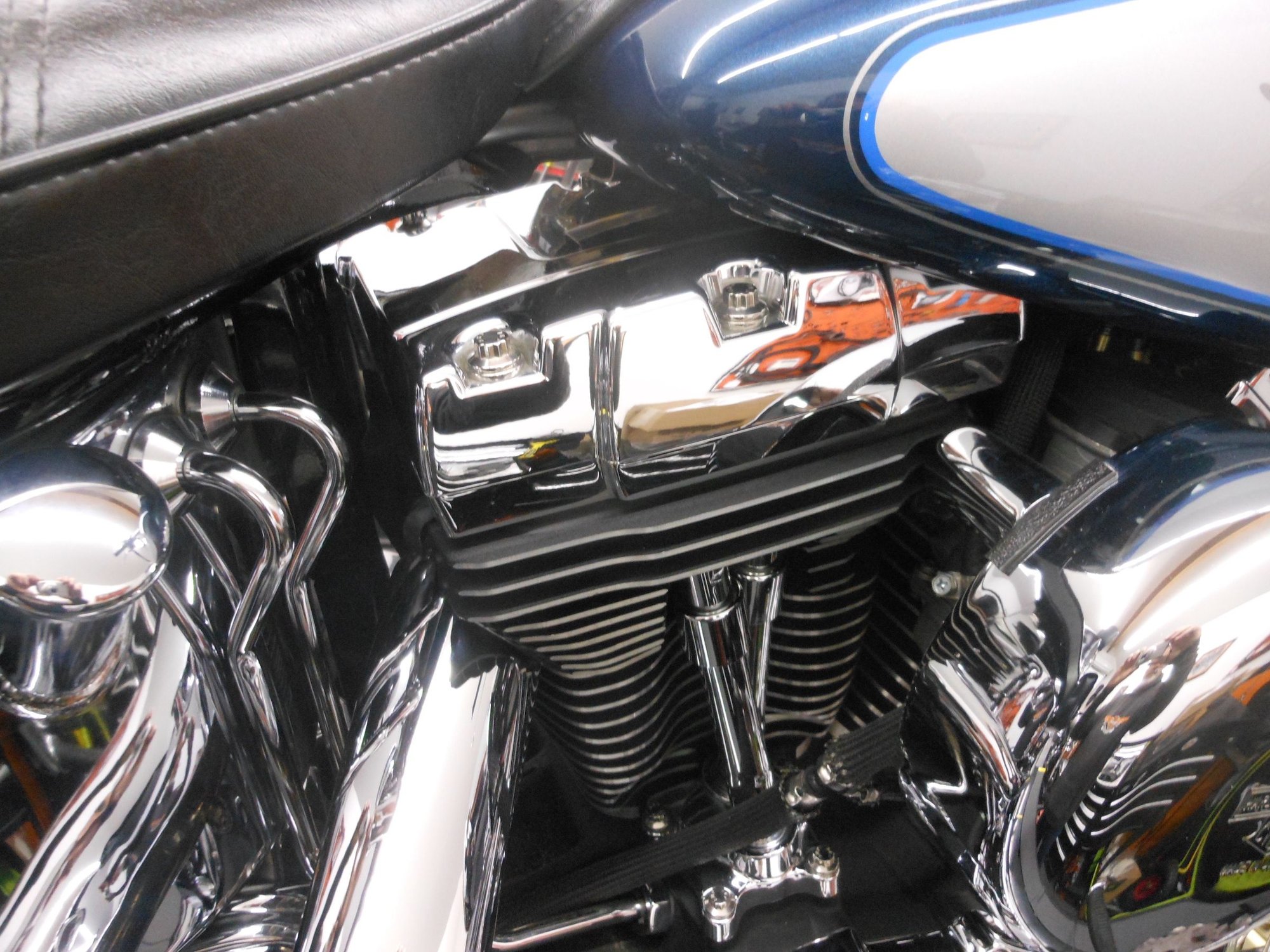

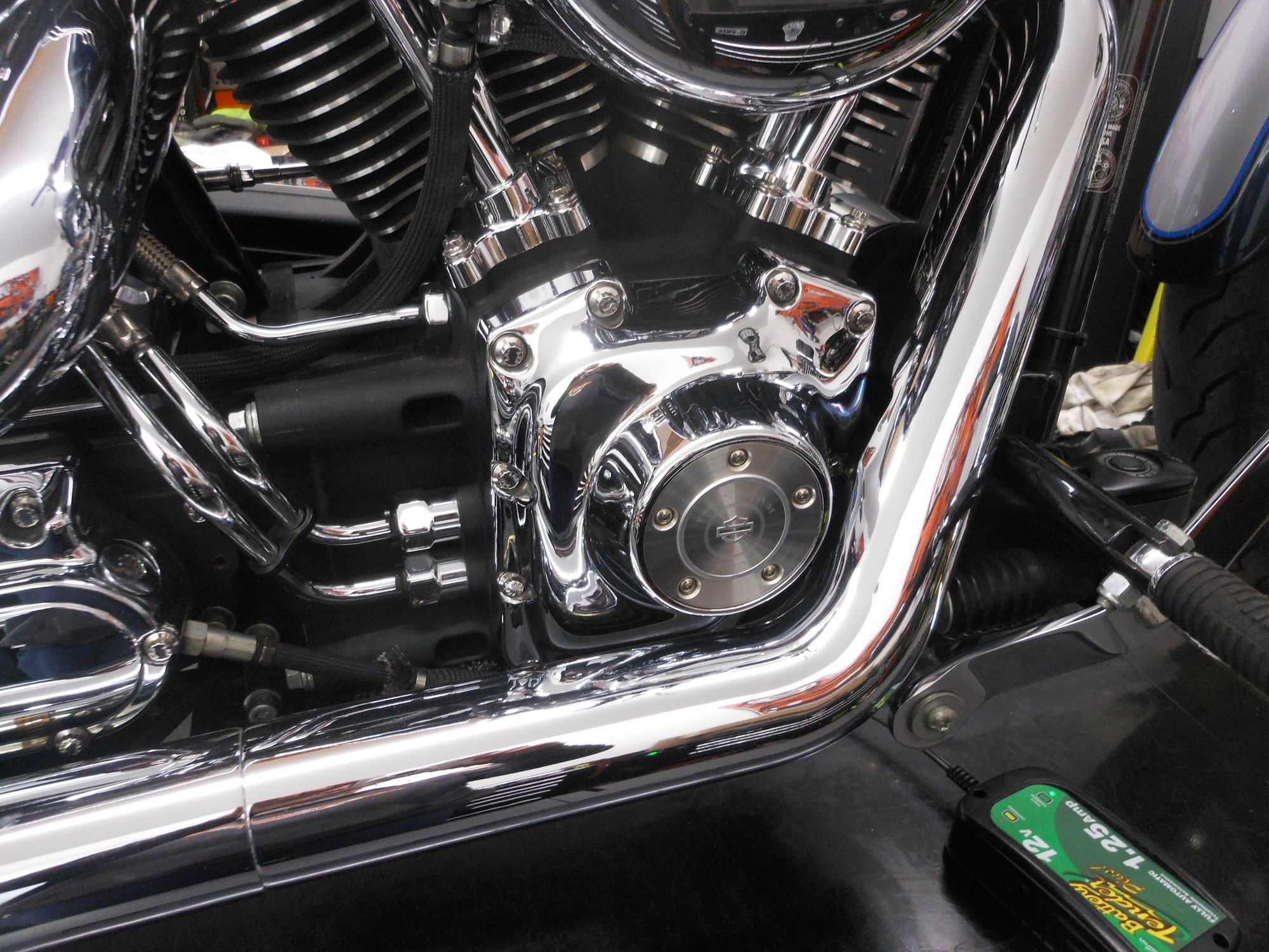

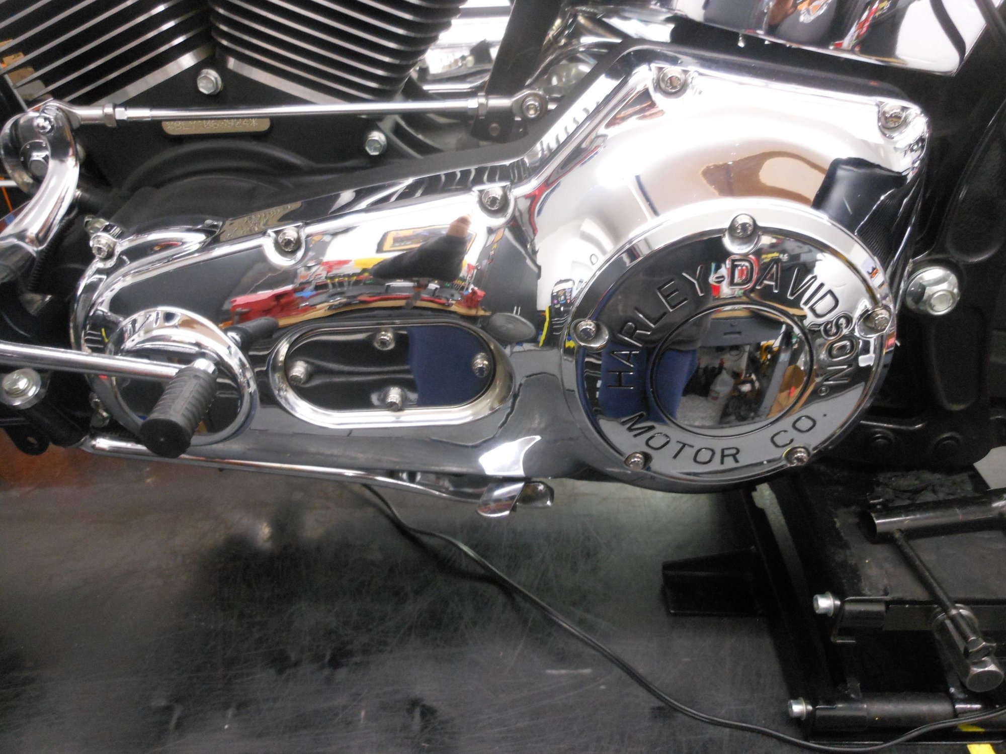

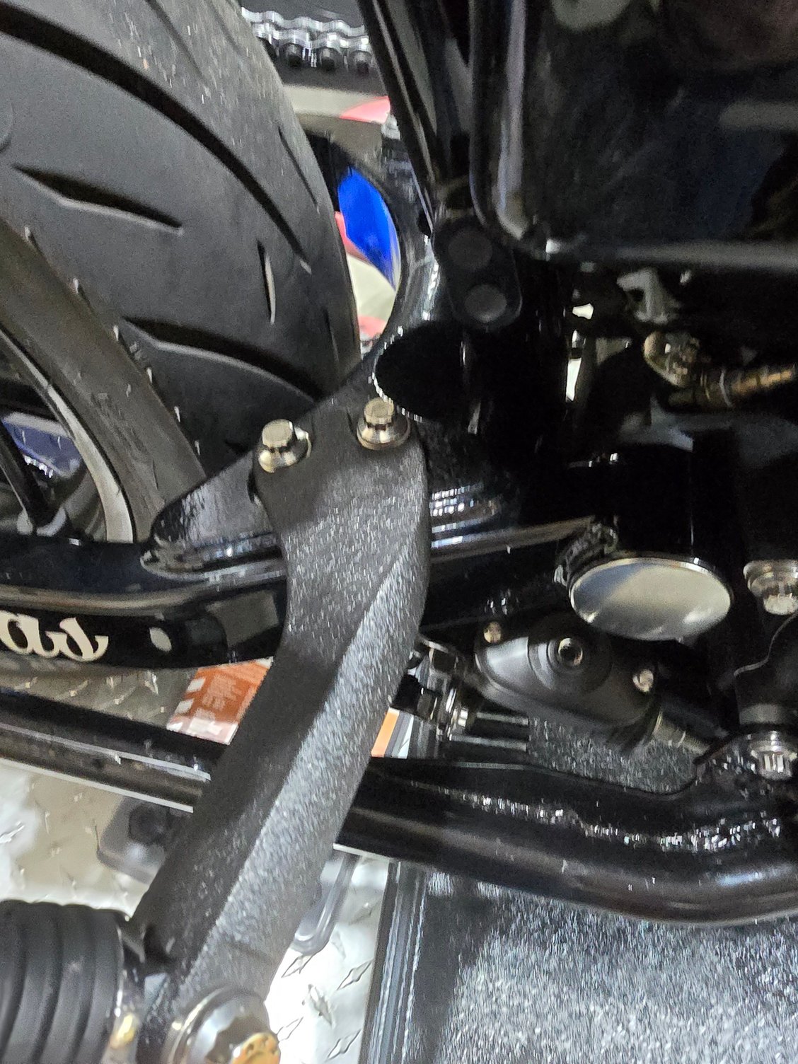

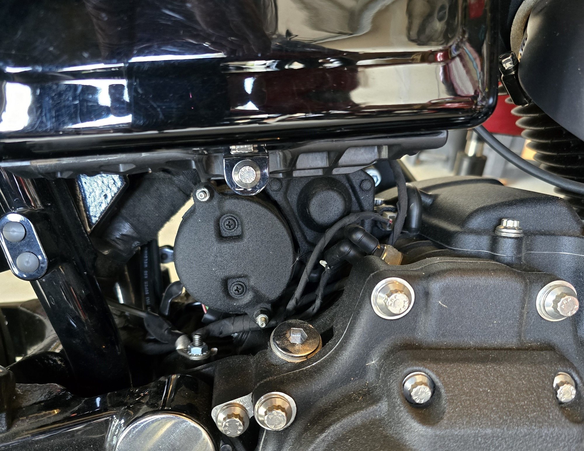

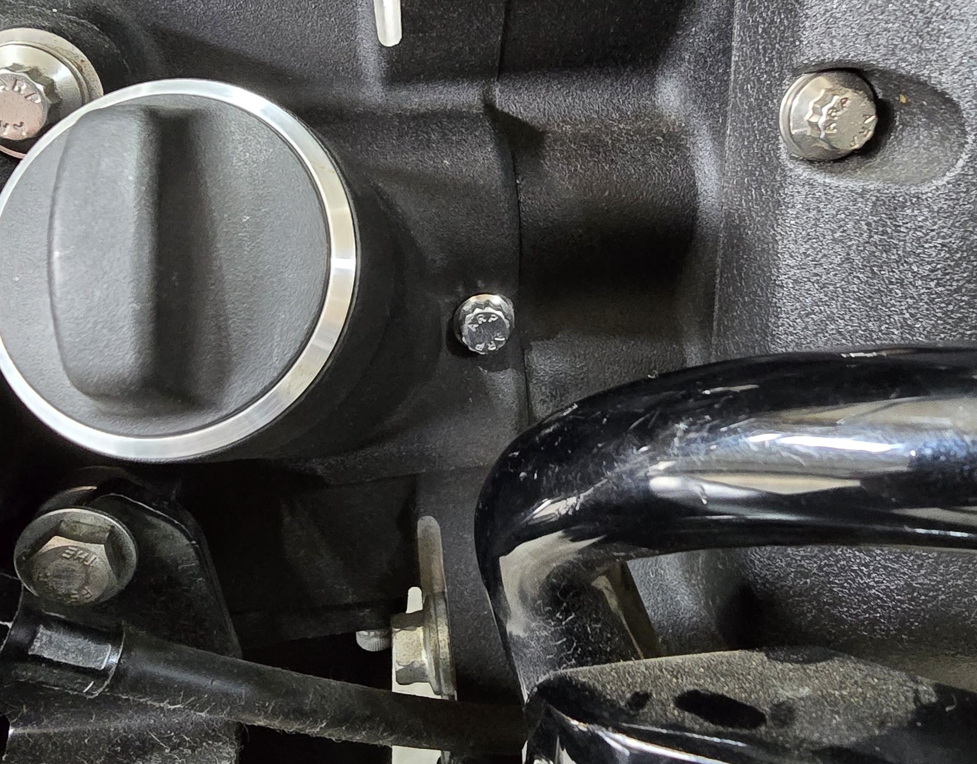

As mentioned above, I have used several Alloy Boltz kits on my Harleys. Their polished ARP stainless fasteners look like chrome. I have never used/seen there "Show Polished" fasteners. They must be real shiny...
I just do the fasteners one at a time. I remove one, put some blue Loctite 243 on the new one (just a dab) then install it torquing it to spec. They suggest using either blue Loctite or anti-seize to prevent the dissimilar metals (stainless steel & aluminum) from galvanic corrosion.
You can buy the alloy Boltz in smaller groups like for an outer primary cover, or in a full engine kit. There will always be one fastener that you can't readily get to. The recurring one for me is a trans cover bolt, right behind the clutch cable. I just leave that one bolt, set aside in a labelled bag, until I happen to pull the clutch cable . You will also have to pull, or at least loosen, the exhaust to get the cam chest bolts all replaced.
I like the look, and the 12-pt fasteners seem more "sturdy" than the allen head fasteners...
Here's a few pics of the ARP 12-pt fasteners form Alloy Boltz on my '01 Springer

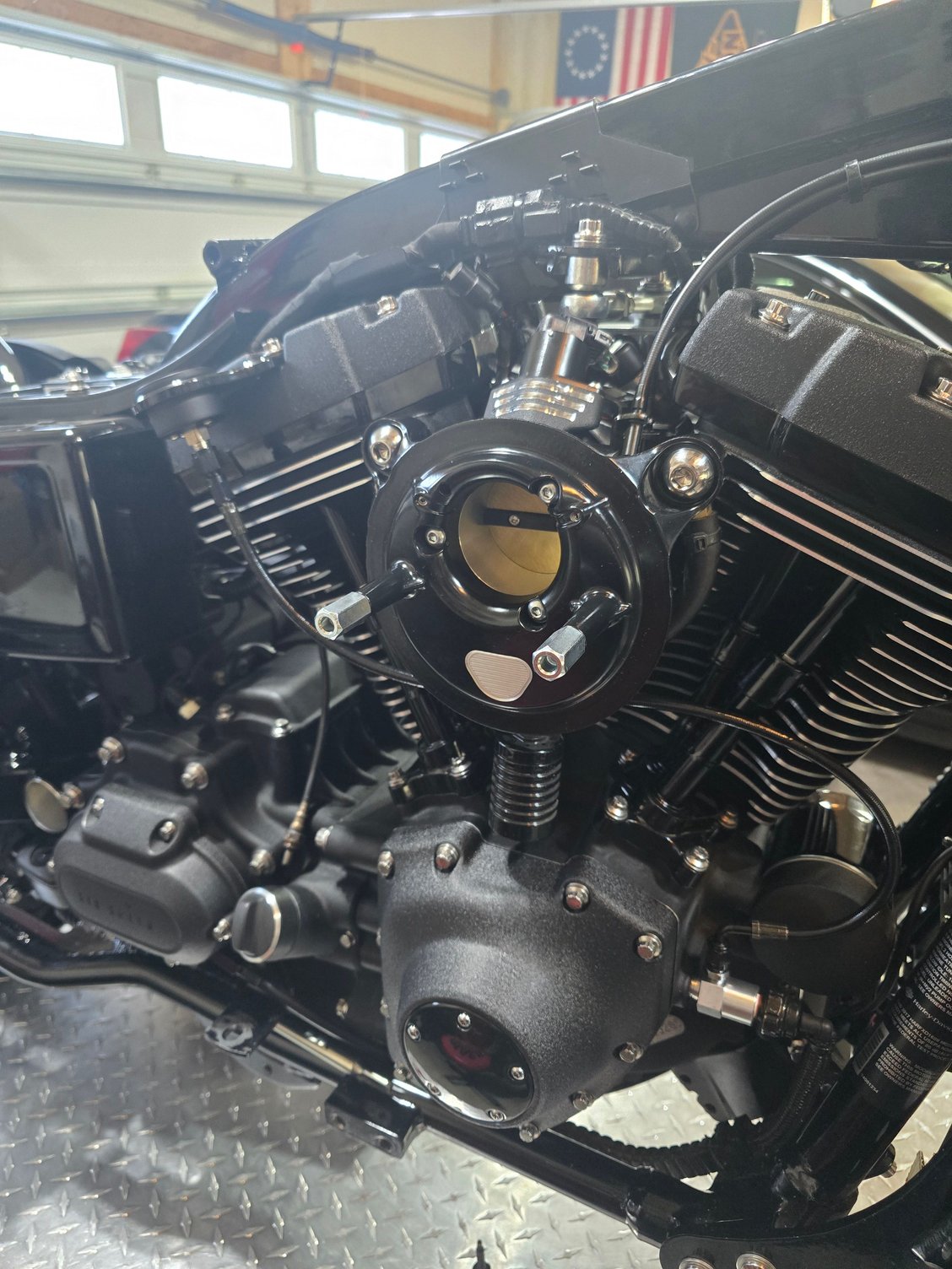

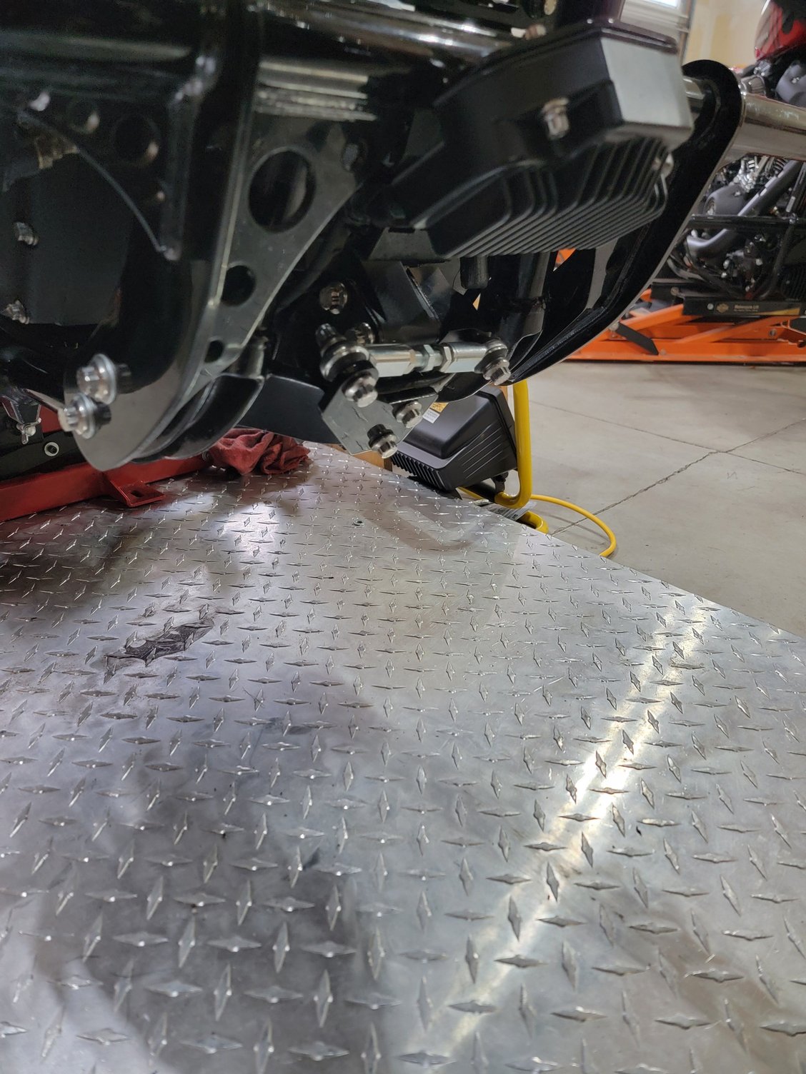

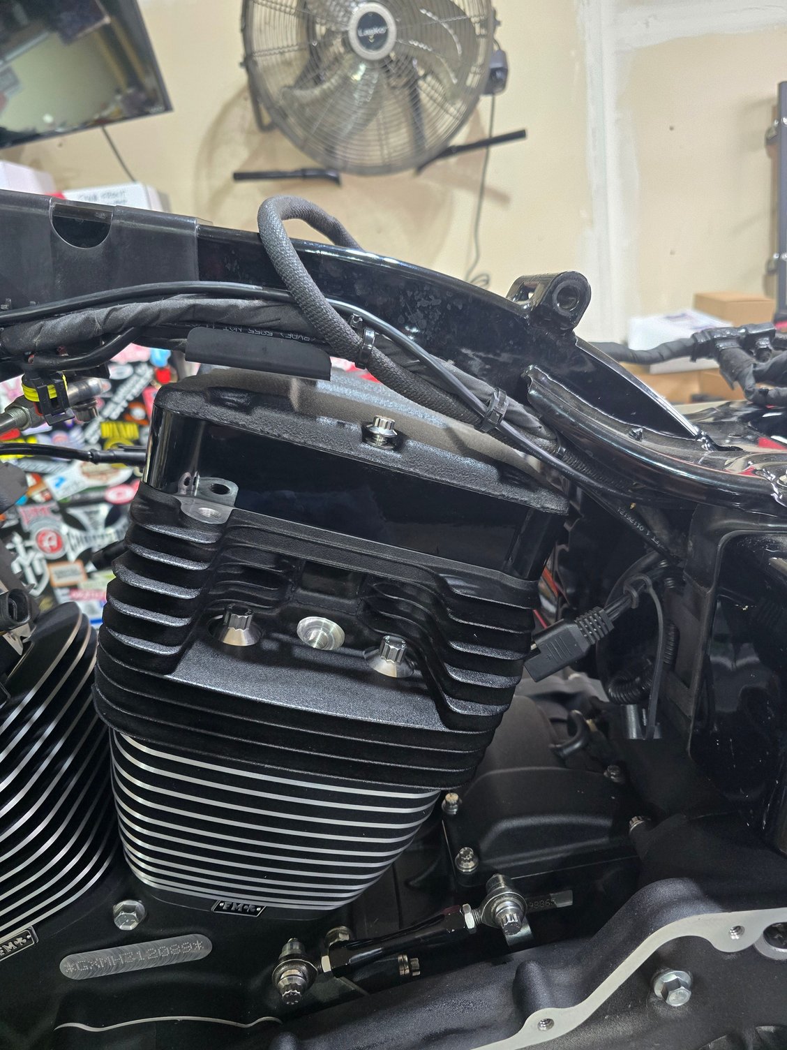

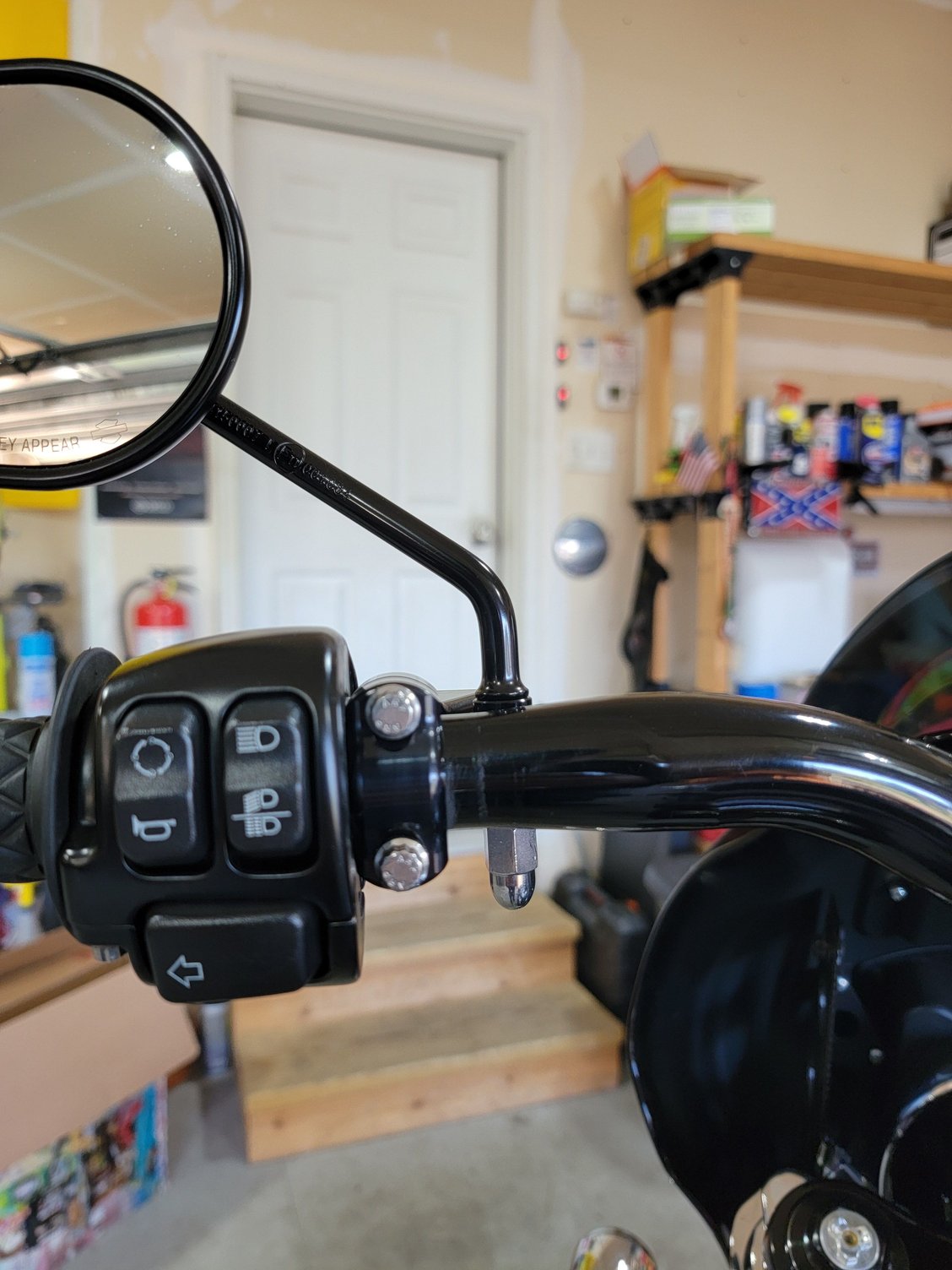

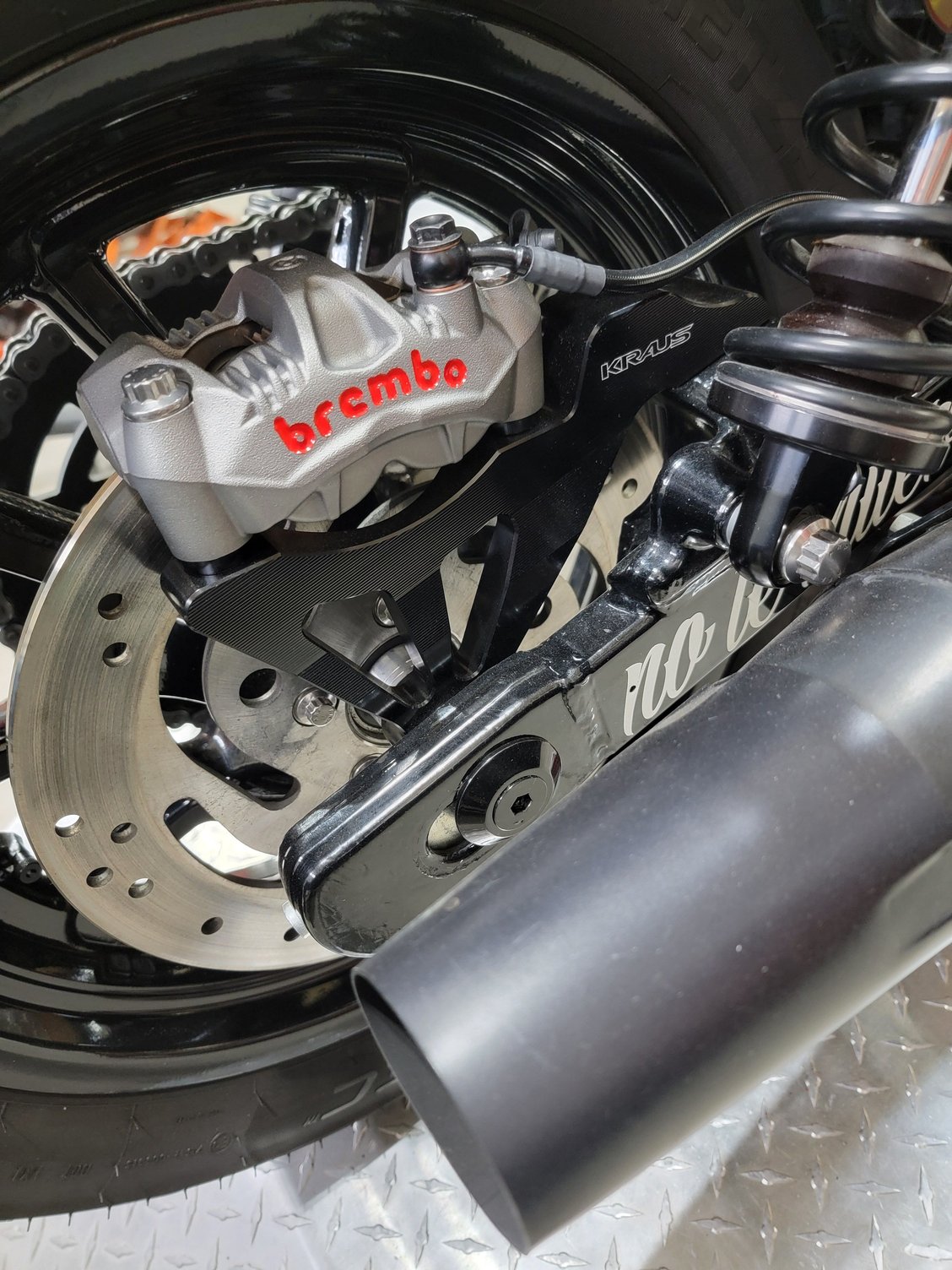

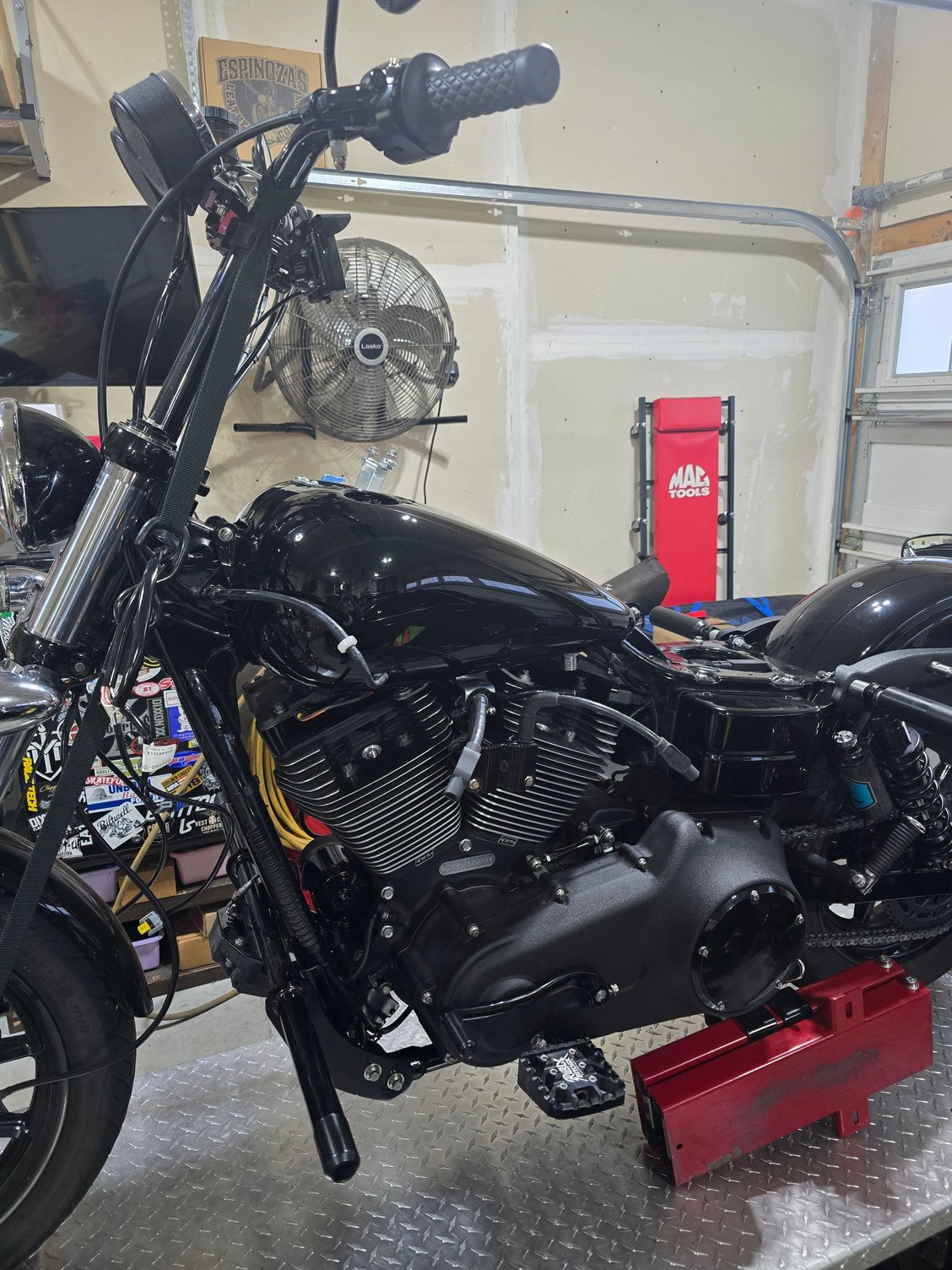

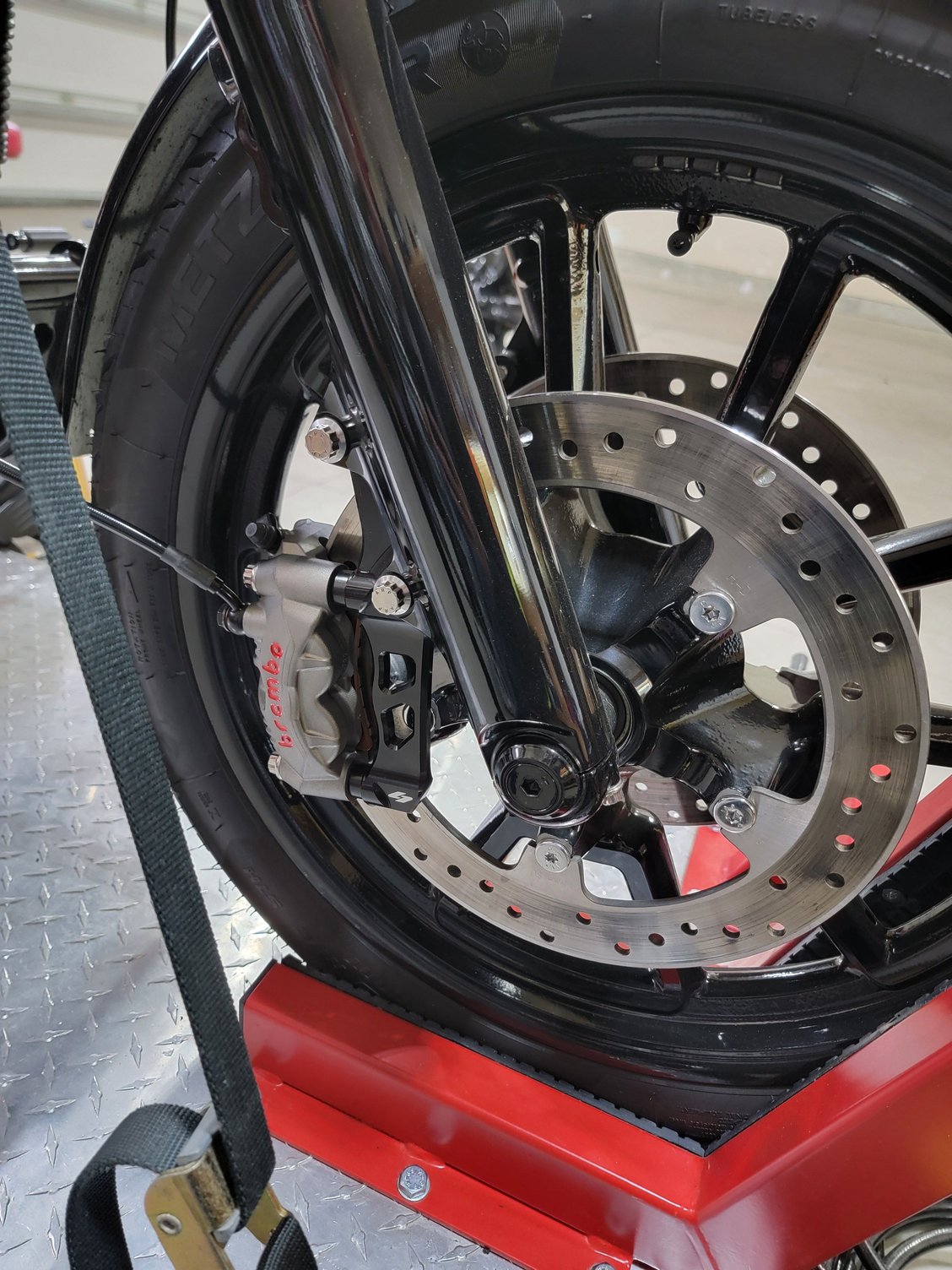

@hattitude gave you pretty much all you need to know, most importantly though is to chase the threads (
Amazon.com: Lang Tools 2581 26-Piece Thread Restorer Tap and Die Set, black : Tools & Home Improvement Amazon.com: Lang Tools 2581 26-Piece Thread Restorer Tap and Die Set, black : Tools & Home Improvement
) if you can and blow them out before installing your new bolt with blue or red Loctite depending on the circumstance, I have been working my bike over for a few years doing bolts as I find them and can access them and as of this winter it is 99.5% stock fastener free, including inside the engine case. You'll see some OEM bolts in these pics and they've been replaced, including the tiny nut on the ground post by the starter.
