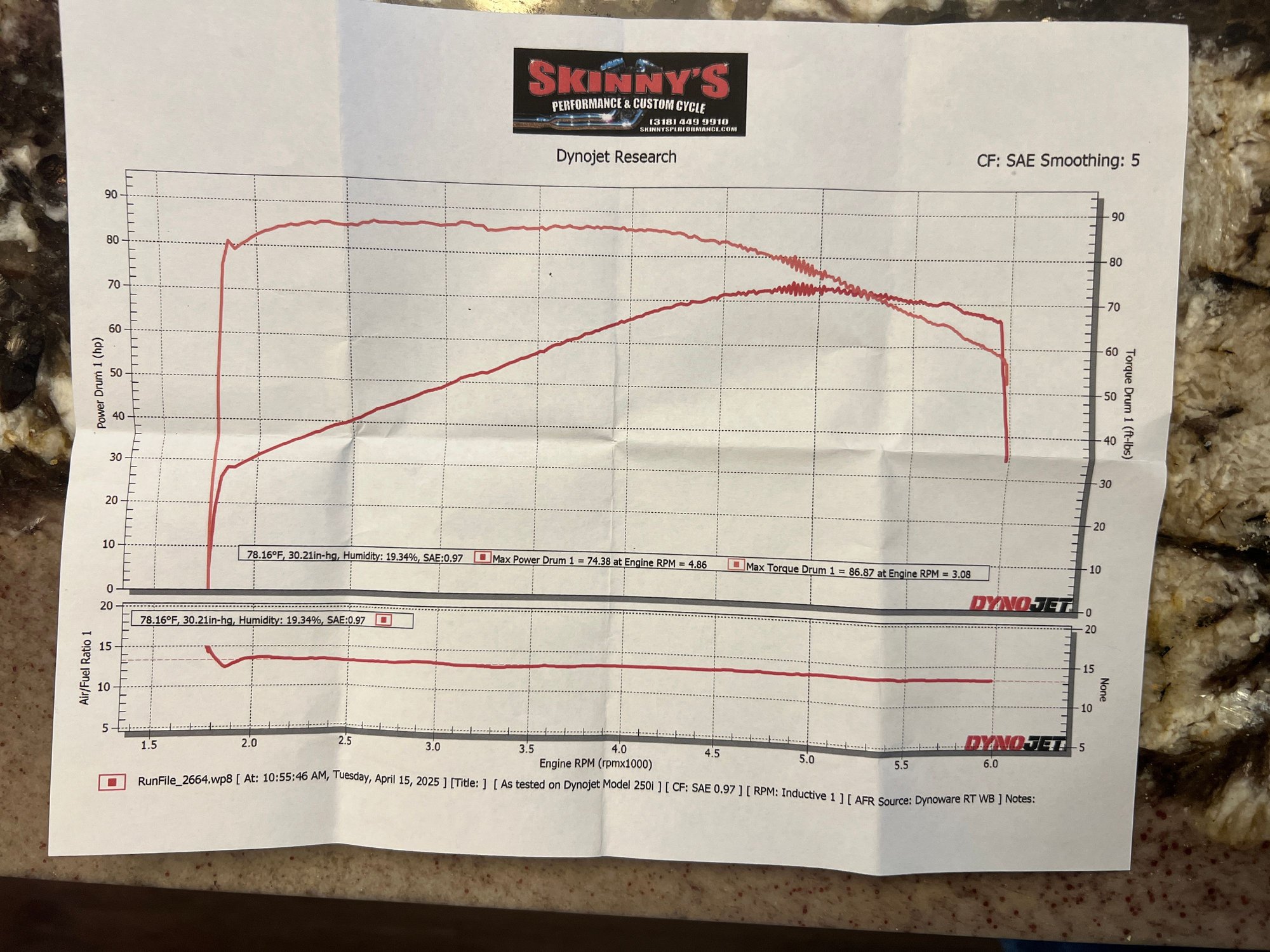

Had the TTS tuner installed today and dynoed. Decel pop problem has been solved.
Anyway if someone is interested in a dyno sheet on a 96 stage one engine, this is what we came up with.
