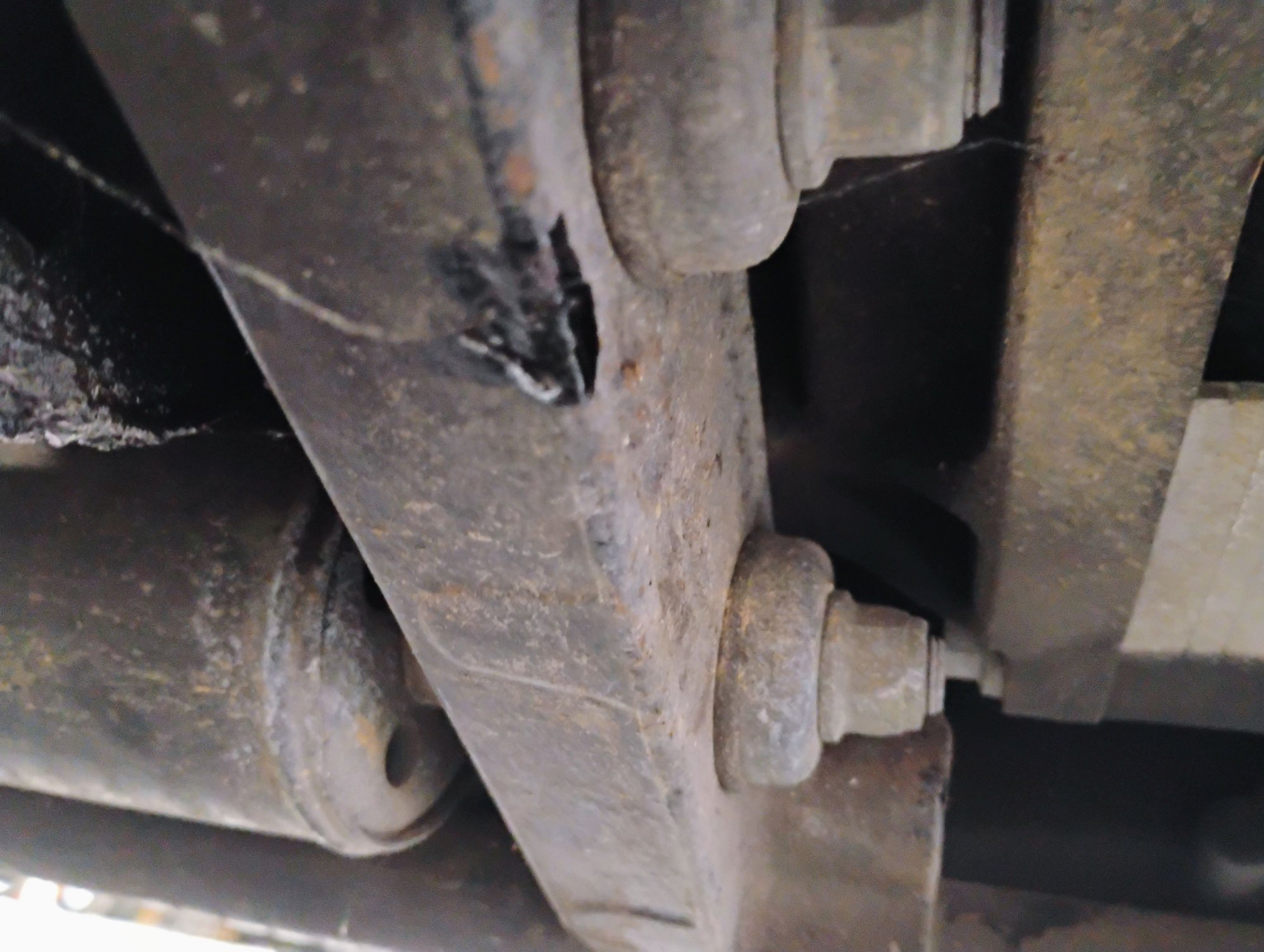

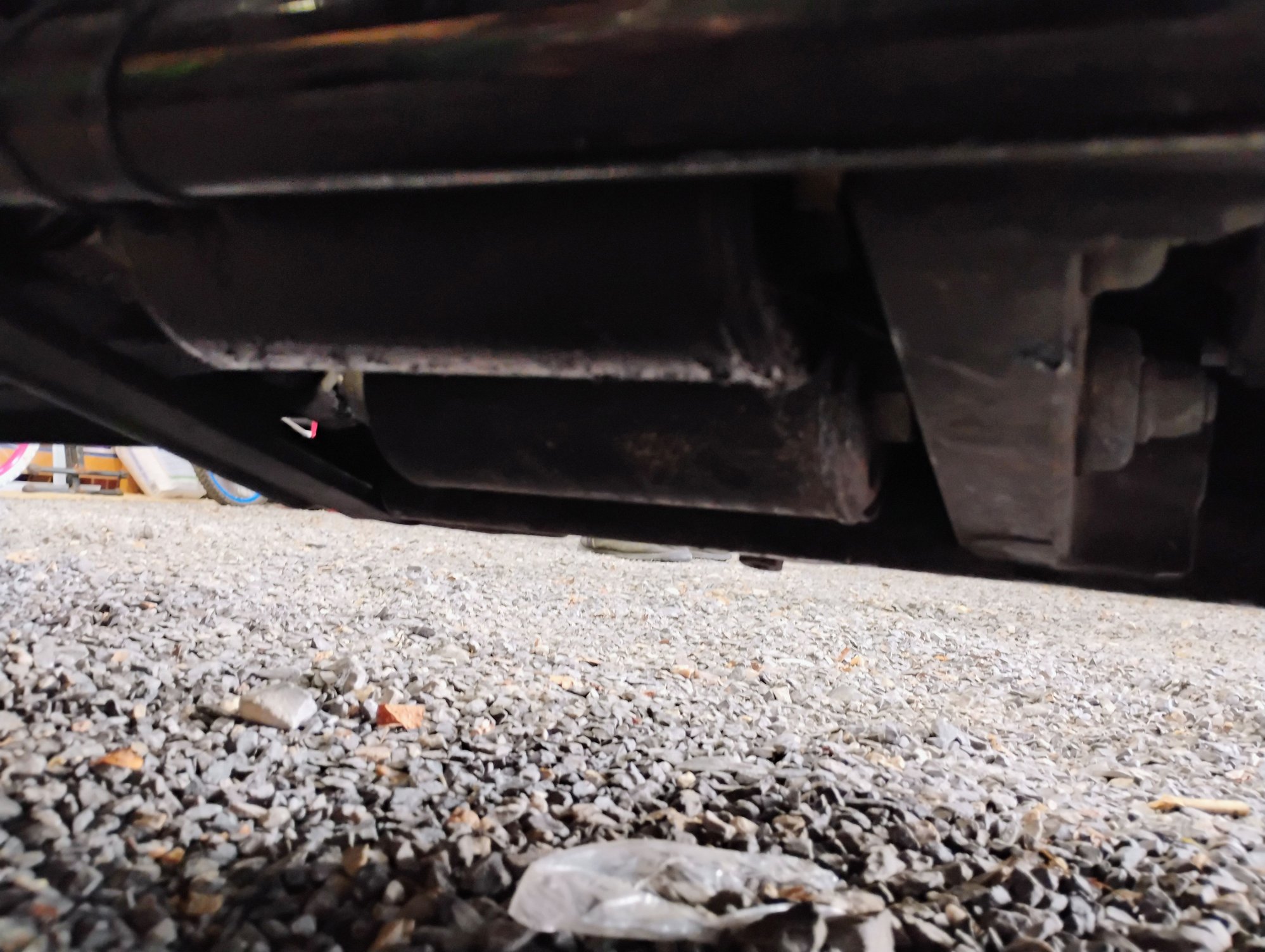

Hard to tell from your pics, and an oil leak is often hard to locate as they "spread" from the leak spot... However..
If that oil leak looks like it's coming from between the rear shocks, the transmission drain plug is located above, and between the shocks. It could be loose, have a torn o-ring, or worse case be stripped. With a mechanics mirror and a light, you could get a direct view of that drain plug and see if it has a drip on it...

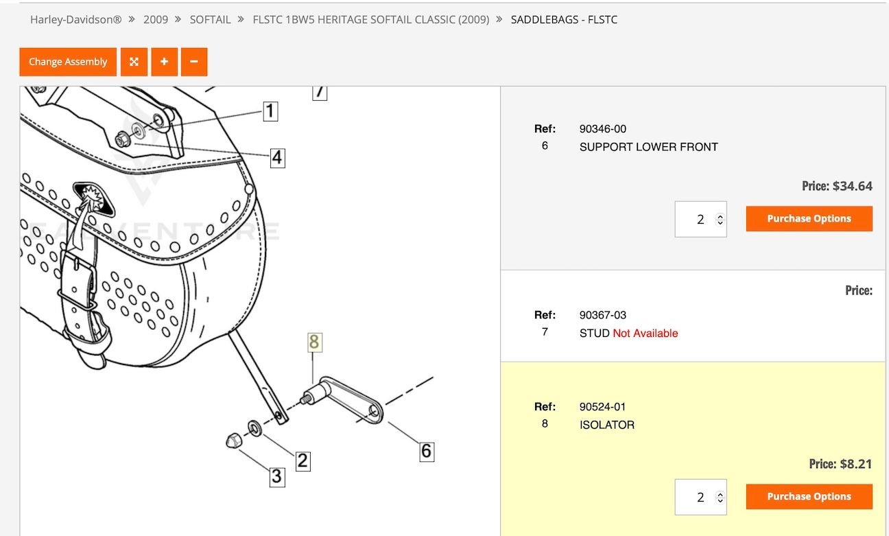

About the broken saddlebag mount.
If that's the forward mount, down by the passenger footpegs, that mount has two pieces. It has an actual mount arm, then an isolator bolt at the end. The pic makes it look like the mount is OK, but the isolator is broken. In either case, both are still available from the MoCo. Your desler should be able to get one for you...
Lower Support #90346-00 @ $34.64.
Isolator #90524-01 @ $8.21

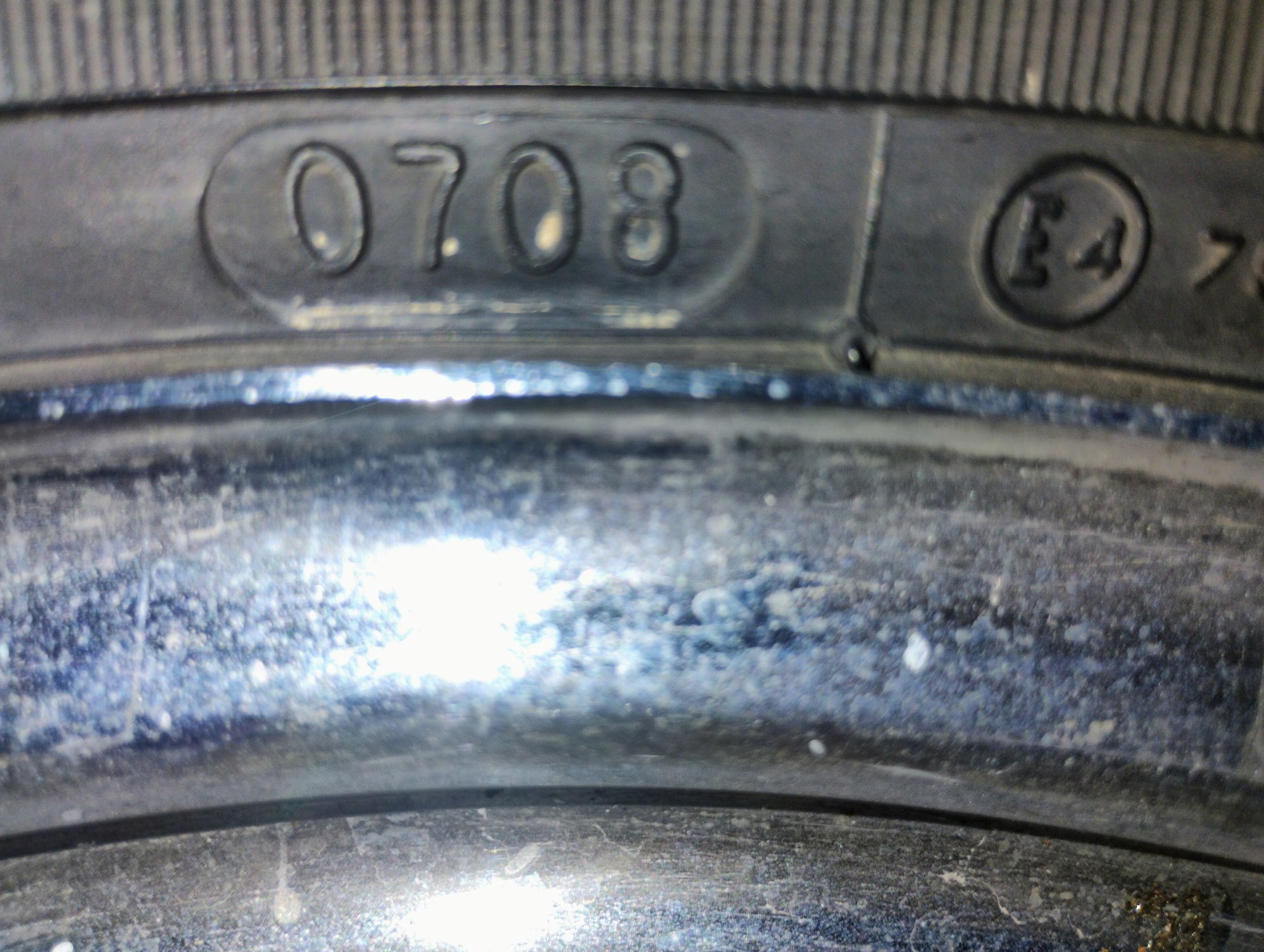

You definitely need new tires. One is dated '08 and the other one is 5801, which doesn't make sense because there are only 52 weeks in a year. Tires and bake pads are perishable items.
I was getting an annoying leak on my '08 Heritage and it was were the stator cord comes out of the front of the inner primary cover. A little RTV sealed it right up.

From the look of the plugs and tires they haven't been changed in years. Check the inside of that fuel tank for rust. If it's rusted that's a ton of other issues. I like the tins but not sure if that bikes worth that kind of dough. The brake master cylinder has paint flake and corrosion. If the bike was sitting on that gravel floor there's probably no climate control and moisture is all around that's gonna kill that bike and cause you a ton of problems.
