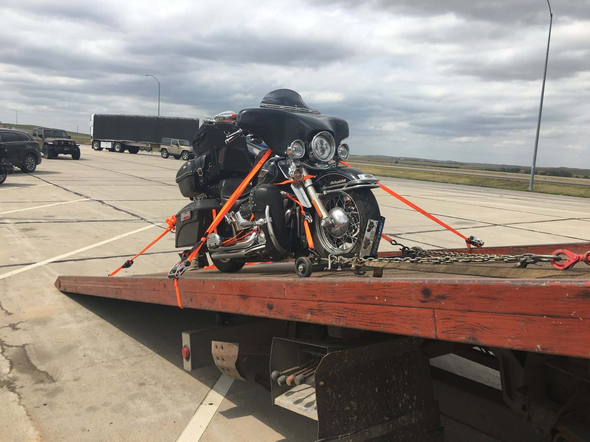

Originally Posted by OddJack
What would you do?
If you’re in a place where-as you can’t replace the valve stem yourself then there’s only 1 thing to do. (See below as I’ve been there)
In my case I was returning home from a road trip when my “tubed” front tire went flat.
The tube had less than 1000 miles on it and was told by the shop the valve stem split at the tube so just a bad tube that took a 1000 miles to fail.
Changed them on the side of the road before, ain't no fun.
