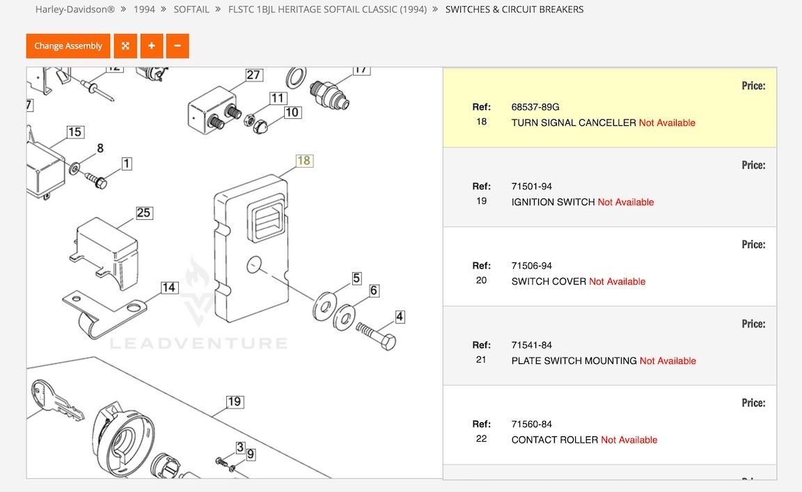

Does it have a 68537-89G
TURN SIGNAL CANCELLER.

If you want to get it running back in OEM form, the Harley part is #68537-89G. It is no longer available from the MoCo.
I know V-Twin makes an aftermarket one (about $100), and Custom Dynamics offers one too ($89.95).
