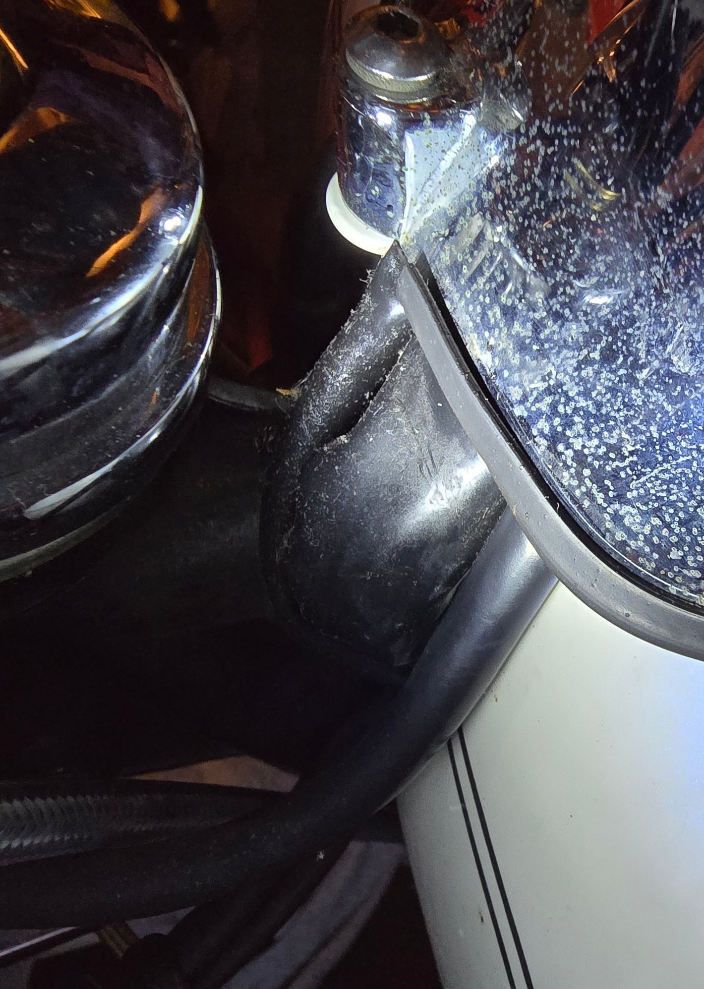

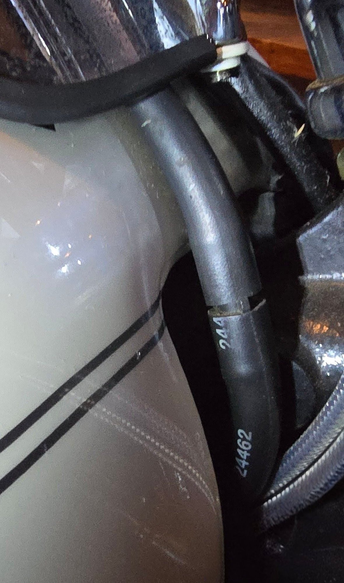

Just had my 04 off to replace a garage door opener battery under there. Have a matching push switch to the odometer one on the other side.
Mine has three bundles. Three go on one side of that center fastner. The biggest is slightly snug but console bottoms. The other vent hose to the other side of fastner. The vent hose is free.
It's obvious which ever side they go down the frame is the side they stay on.
It possible to spin console with it up to confuse the issue. I protected the tank with heavy towels. Still be nice to have 4 hands.
I used black plastic electric tape to keep those two spacer gasket on each side of the console. I see I left a piece too far out.
When mine snugs, the lines are still free to be push back in or pull out a tad which I did until just before screw snugs. My screw is a Allen head cap screw now.
Black tie wraps bundles them.
Mine is original factory. When I got the bike, the vent hose wasn't attached from the factory.
Your model appears to have less. Appears it's on wrong side and most should go back under console. You can see that bundle is chaffed were my guess it used to be coming just thru.
It really shouldn't be rubbing.. not like steering affects that part...maybe just not setup too well at the factory and should have been couple bundles.
