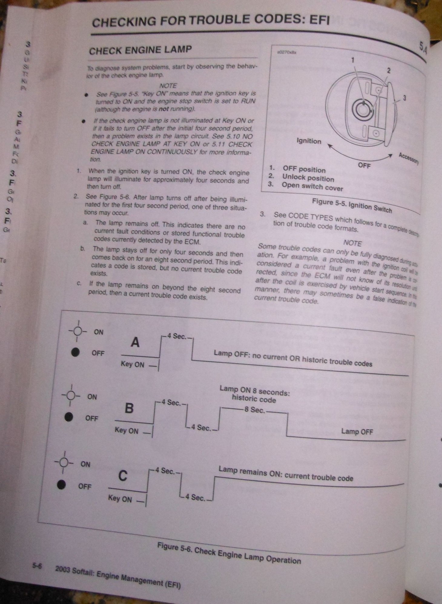

Unfortunately, I did not see the manual you will need most on that Low Brow Customs free .pdf page. Maybe I missed it, but I didn't see it in their group of manuals.
You will need to get a 2003 Harley-Davidson Softail Models Electrical Diagnostic Manual, P/N 99498-03.
I have one and the EFI Engine Management, sections 5.1 through 5.33 is 116 pages, but it is a wealth of information.
It is available from a dealer for $193.17 (Wow, they have gone up! Last Time I checked they were $149.95)
Or, you could get one on eBay. They have used ones in good condition for under $100.
Here is just one example:
https://www.ebay.com/itm/29744616865...3ABFBMmLWUq45m

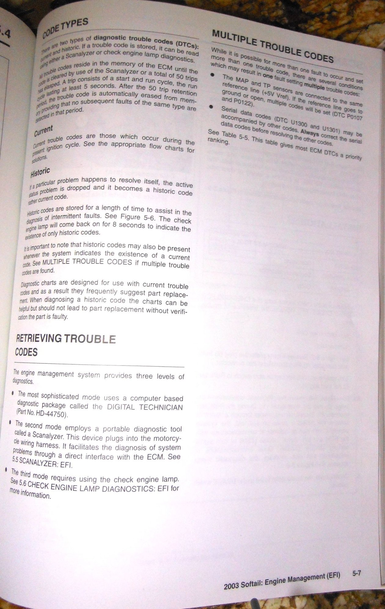

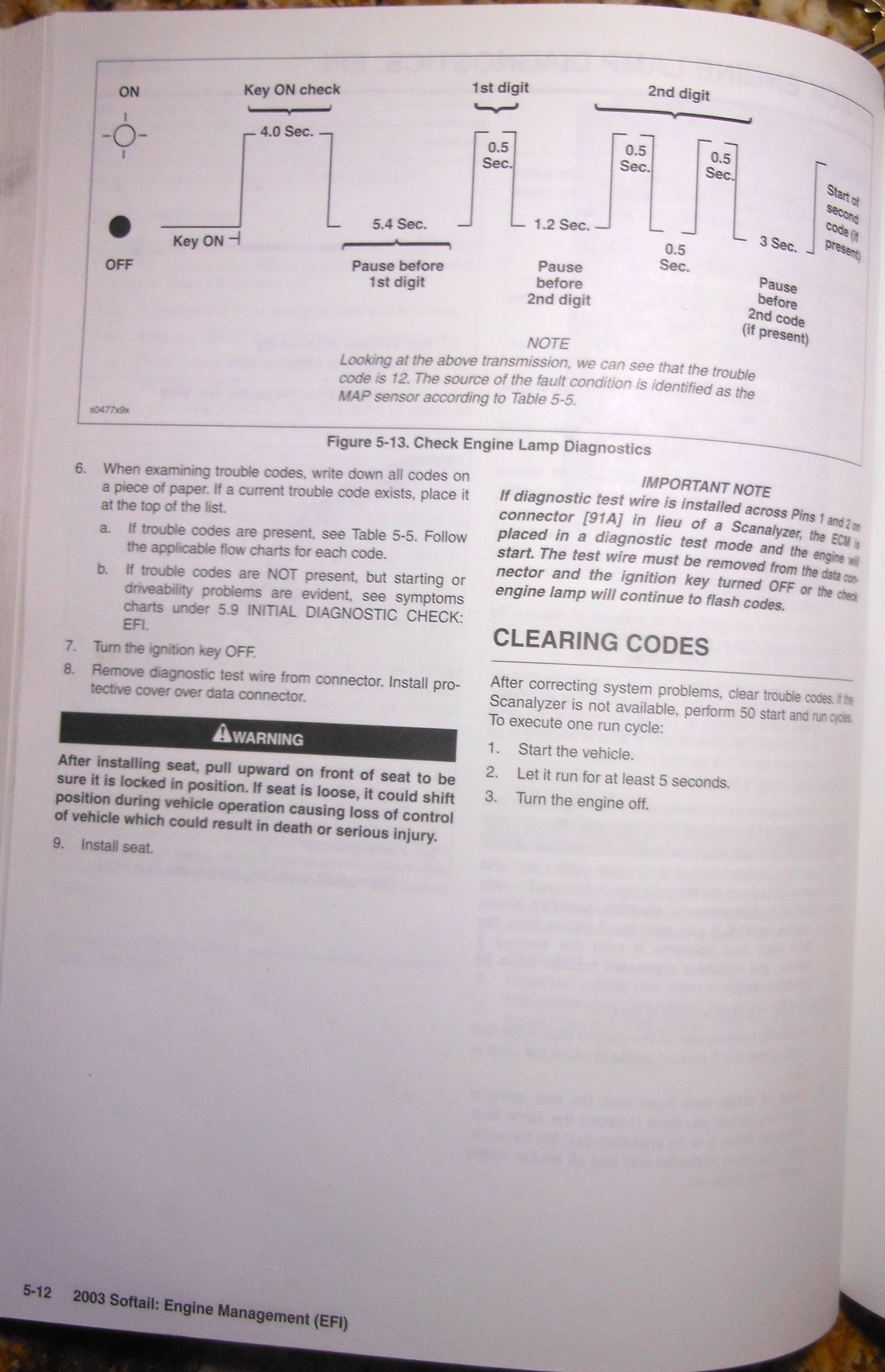

To get you started, you need to first decide if you have any DTC (diagnostic trouble codes) in the ECM.
Here is how to tell if you have any trouble codes to retrieve, it is section 5.4 Checking For Trouble Codes: EFI
I will guess that you don't own (or have access to) an HD Scanalyzer tool, cartridges, or cable that was made by Kent-Moore for HD dealerships, or a delaership Digital Technician computer. If you believe you have codes to retrieve, without the scanalyzer or Digital Technician, you will need to follow Section 5.6, Check Engine Lamp Diagnostics: EFI. (posted it below.)
I try hard to be a helpful member on this forum, but I will apologize in advance. I will not be posting the other 112 pages in that section of the 2003 Electrical Diagnostic Manual.
If you have and retrieve any codes, you can post them up. Someone will try to point you in the proper direction. If I see it, and can find anything in the manual specific to your codes, I will try to post them up for you.
Your repair will go faster, and you'll be much more self sufficient, if you buy an HD 2003 Softail Service Manual (P/N 99482-03) and the HD 2003 Softail Electrical Diagnostic Manual.
Please report back what you find and fix to get your bike back on the road.
Good luck with your repairs.
