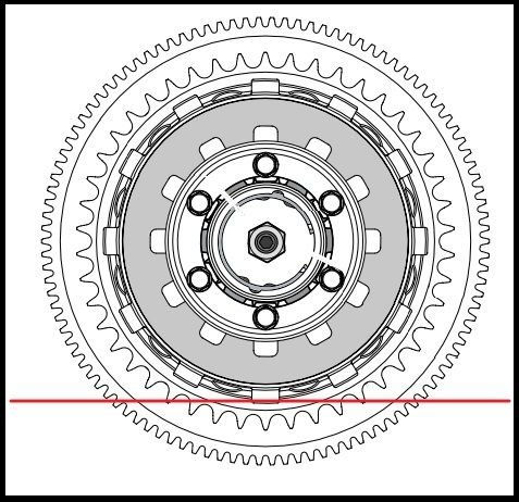

Set the primary lube level so that it just touches the outer diameter of the clutch shell, bike vertical.
A little less won`t hurt a thing.
