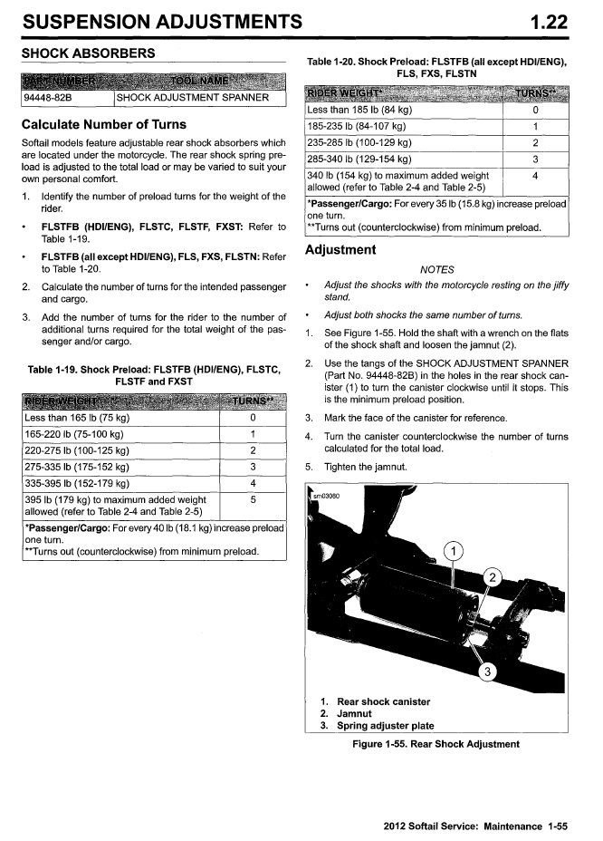

I have a 2012 softail heritage classic and im trying to get it to ride higher and not bottom out as easy but everythibg i look up contradicts eachother and its driving me crazy. Is minimum preload when its alway towards the front of the bike or the rear? Also i have it jacked up but its damn near impossible to turn the adjuster and even tho tje big nut is loosened and backed off the center threaded part turns with it on the right shock. Id appreciate any help cause i cant afford to put it in a shop and as it stands i cant ride my bike till this os fixed

Here is the HD Factory Service Manual directions for adjusting the shocks.
This is from the 2009 Softail Factory Service manual, but I believe the procedure is the same for 2012...
I hope this helps...

This is from the 2012 Softail Service Manual

Bone Doc, thanks for sharing that....
Same shock part#s for both years, yet that 2012 manual gives a lot more info/direction about adjusting than my '09 Service Manual.
Gonna print that and save it in m '09 manual...
