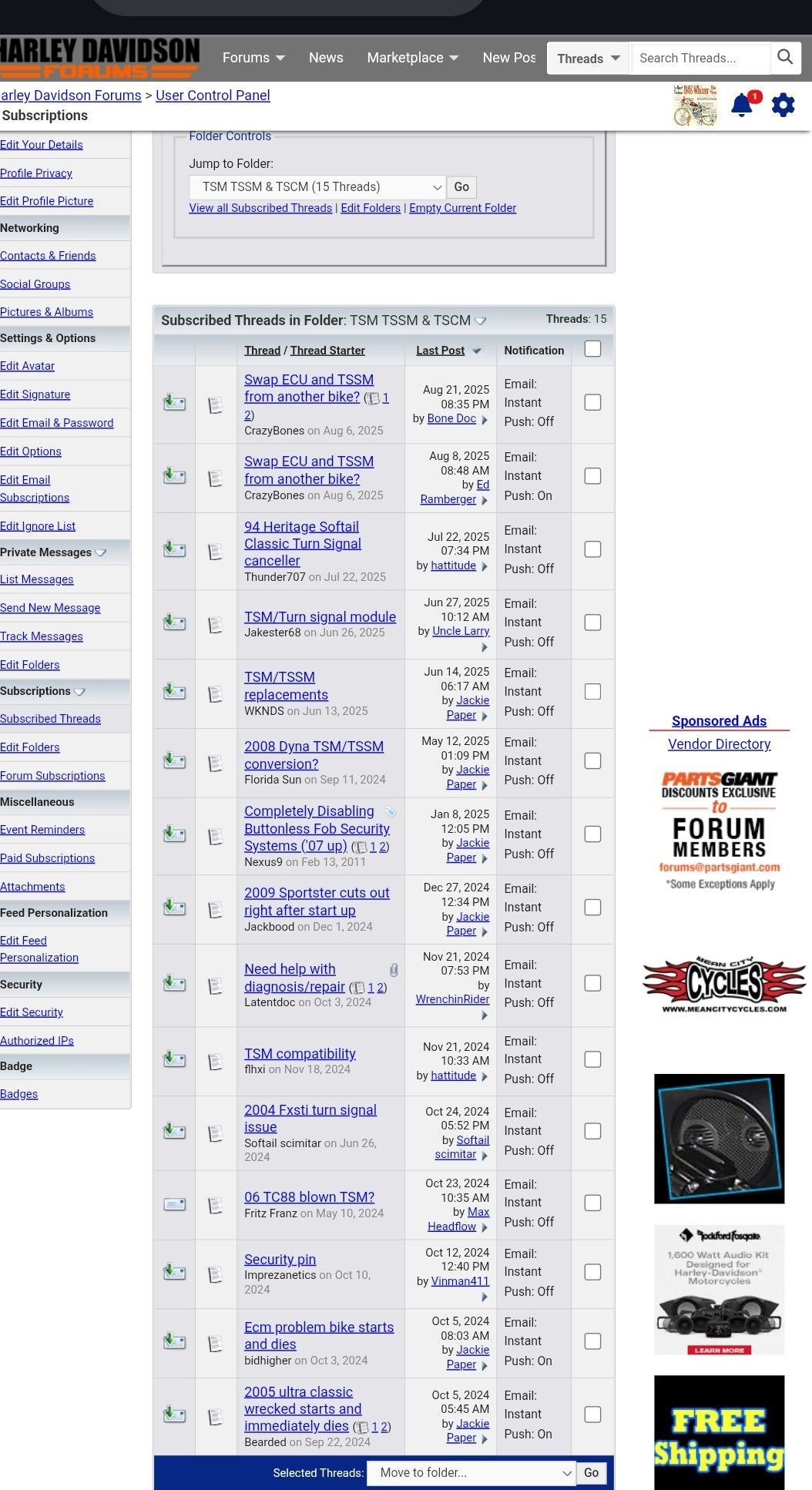

Welcome to the HDFORUM. Community team will move this probably to correct area.
Hopefully it wasn't locked before dieing. If so, a used one can be programmed to work with less issues.
The key is the time pause when you start to reprogram it.
Will attach a thread shortcut shortly.
PM or note in this thread if this doesn't help.
https://www.hdforums.com/forum/softa...er-bike-2.html
I have a folder full of the latest...
