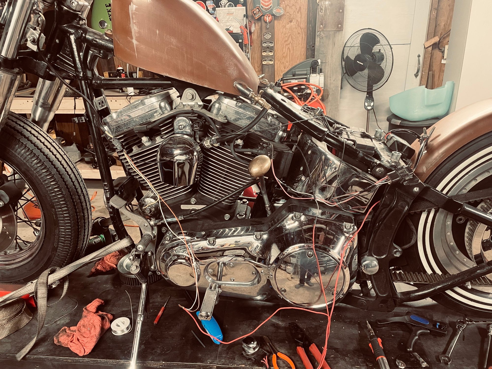

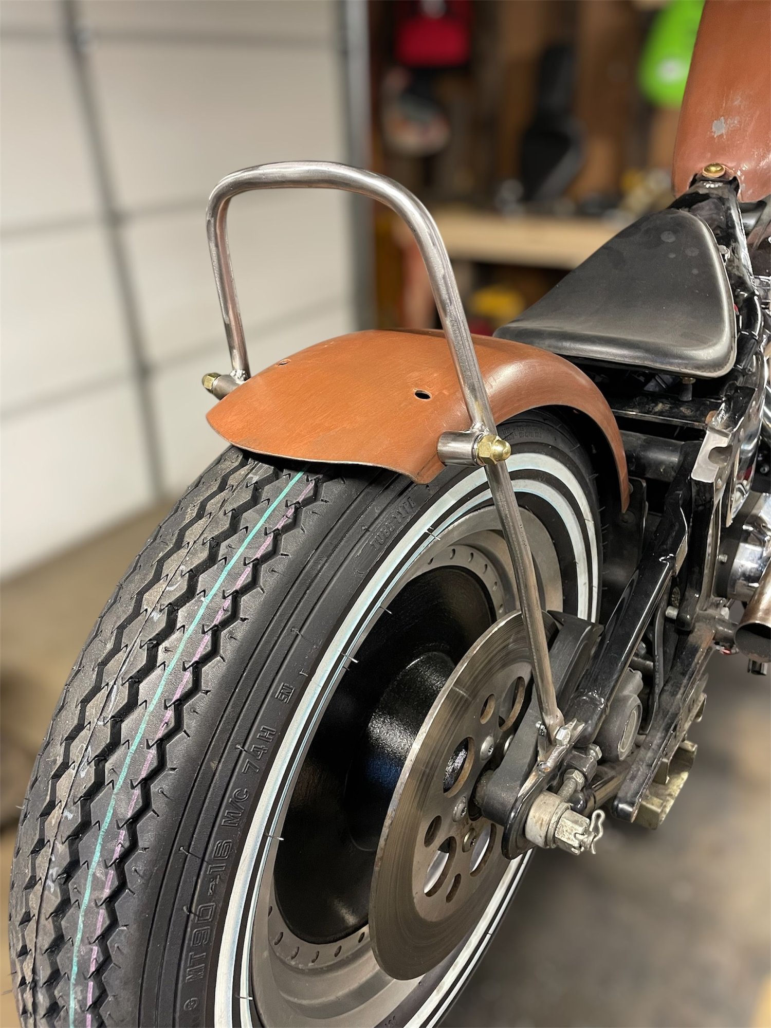

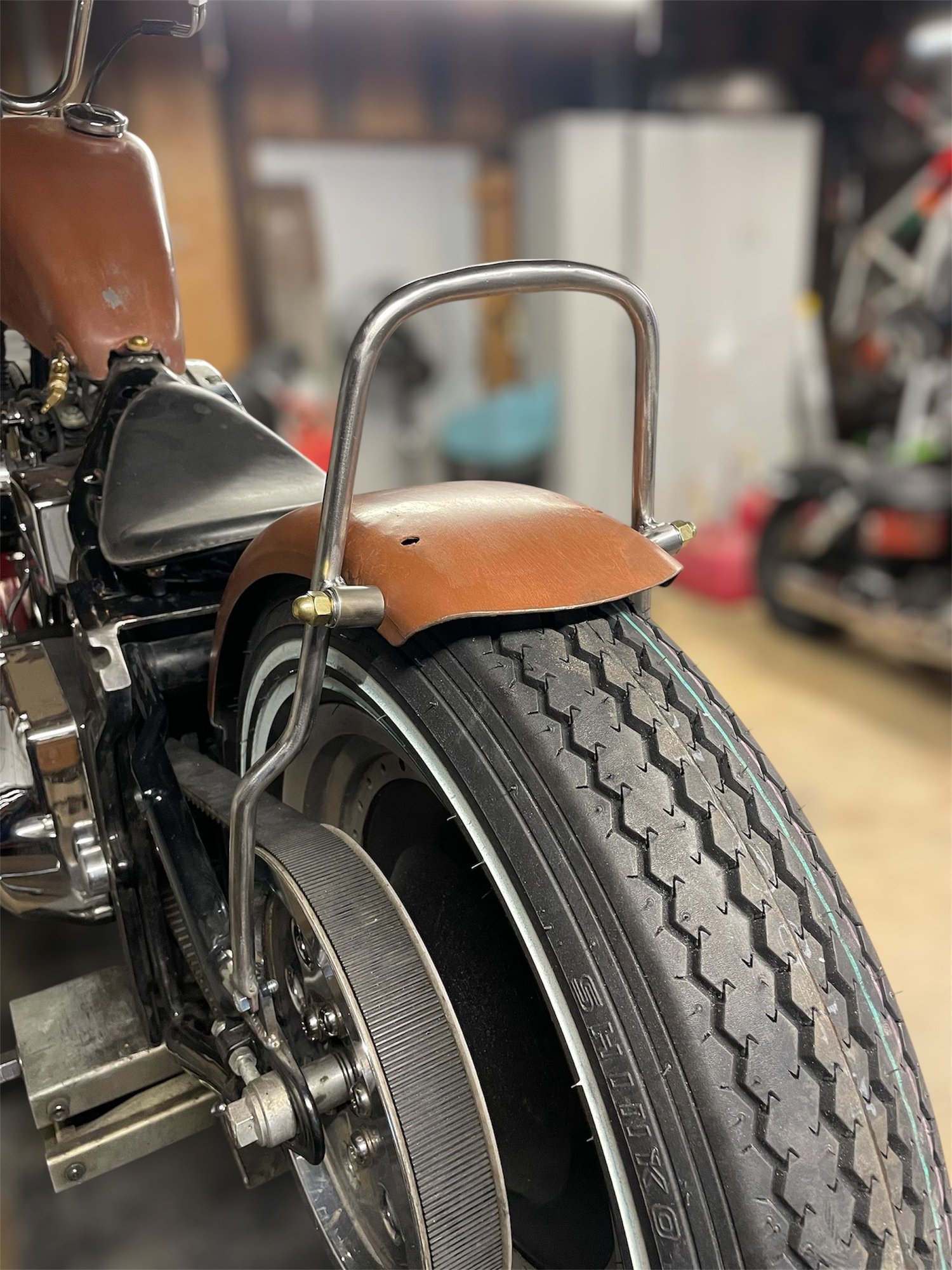

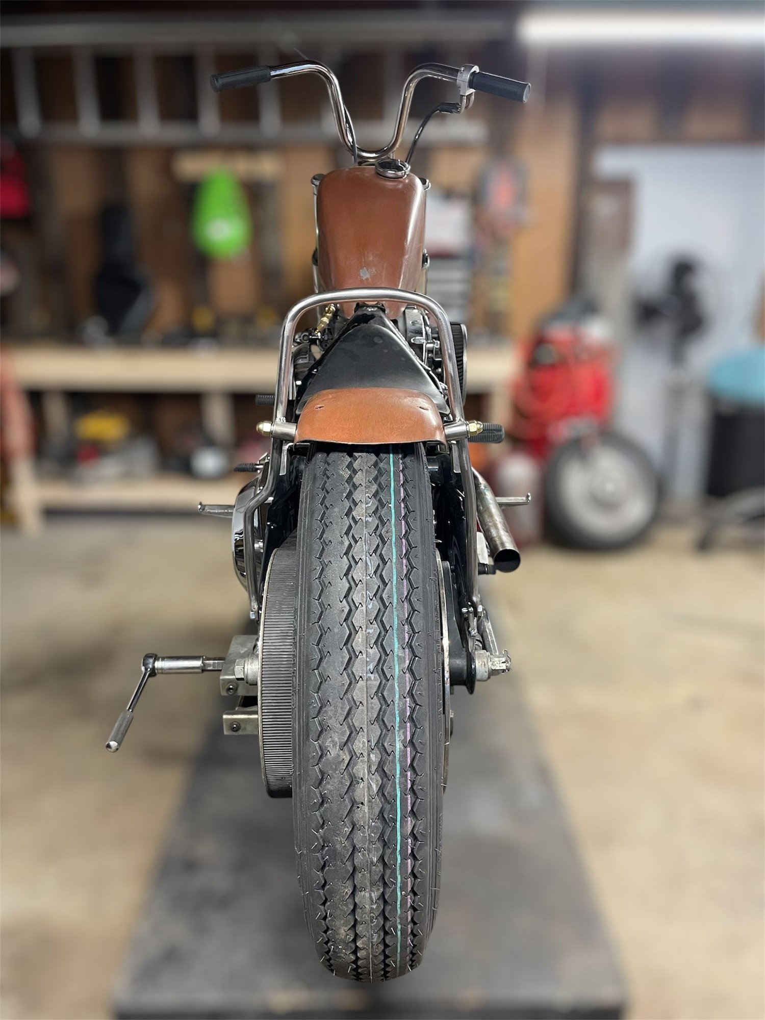

It’s coming slowly. I got a lot of fab work done already. Still need to pull the forks and shave the fender mounts off, I’ll probably polish them too. I need to finish some grinding on the swing arm and do just a little bit more welding then I’ll have to pull that and get it powder coated. I need to finish working on the exhaust too. Not sure what I want to do with that. I was able to finish up the sissy bar yesterday, that took about a week to do, there was a lot more work involved in that than I thought there would be but I’m really happy with the outcome. I started working on a wire diagram this morning. I want to use what was already on the bike if I can.

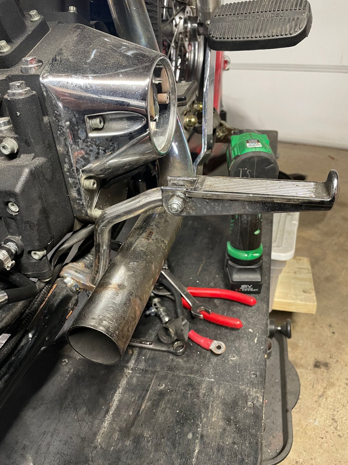

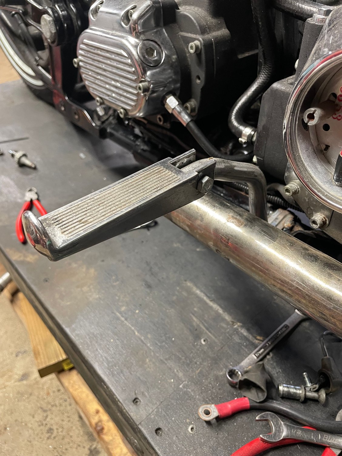

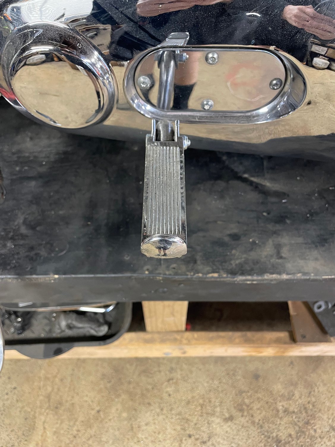

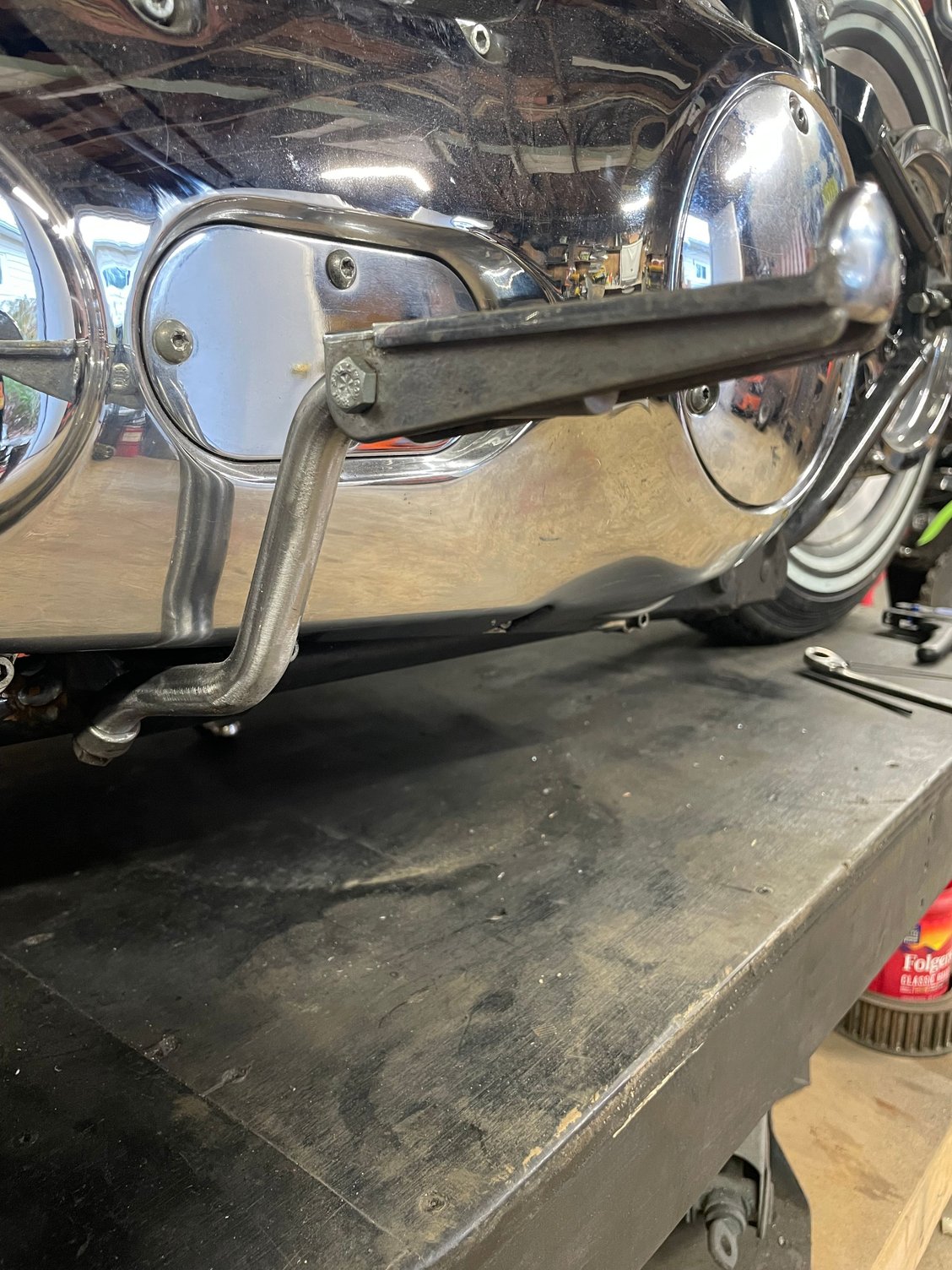

Can you post up better pics of the DIY foot pegs on the bike??
Old Nov 2, 2025 | 03:19 PM
sorensentyler's Avatar
sorensentyler
Joined: Feb 2010
Posts: 646
Likes: 159
From: New York
Old Nov 2, 2025 | 03:44 PM
98hotrodfatboy's Avatar
98hotrodfatboy
Posts: 21,100
Likes: 7,629
From: Poolville
Nice, you did a good job.. Nothing like options...👍

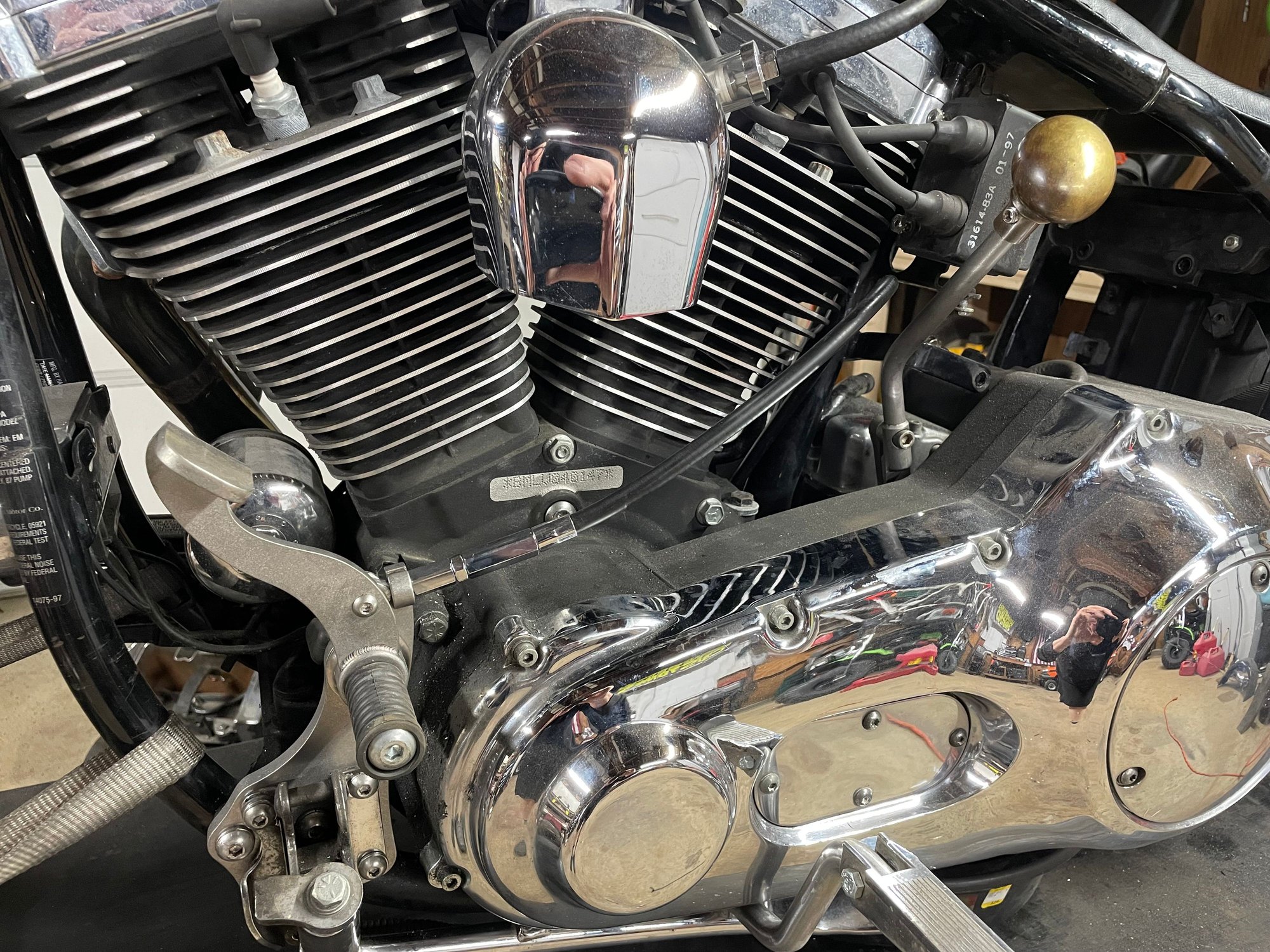

For clutch and hand shifter installed. Found the door **** at an antique store, thought it’d give it a cool look. I’m a sucker for brass, every bike I build I put brass accents on.
Foot clutch and hand shifter installed. Found the door **** at an antique store, thought it’d give it a cool look. I’m a sucker for brass, every bike I build I put brass accents on.

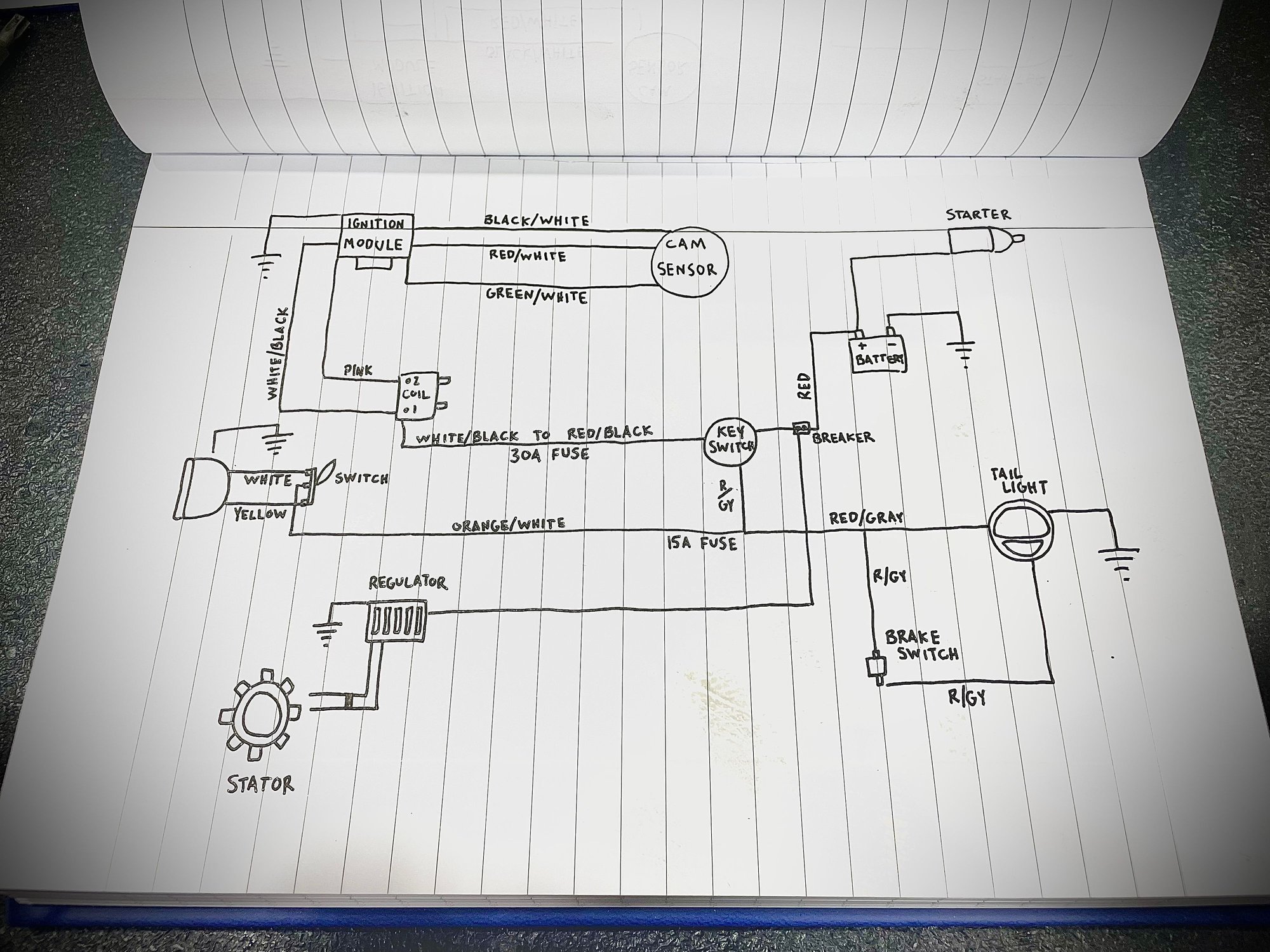

started wiring today. Took the main harness schematic and pretty much got rid of anything unnecessary. Took a few days to draw out. So far I have the starting and ignition systems wired up and I was able to fire it up today.
