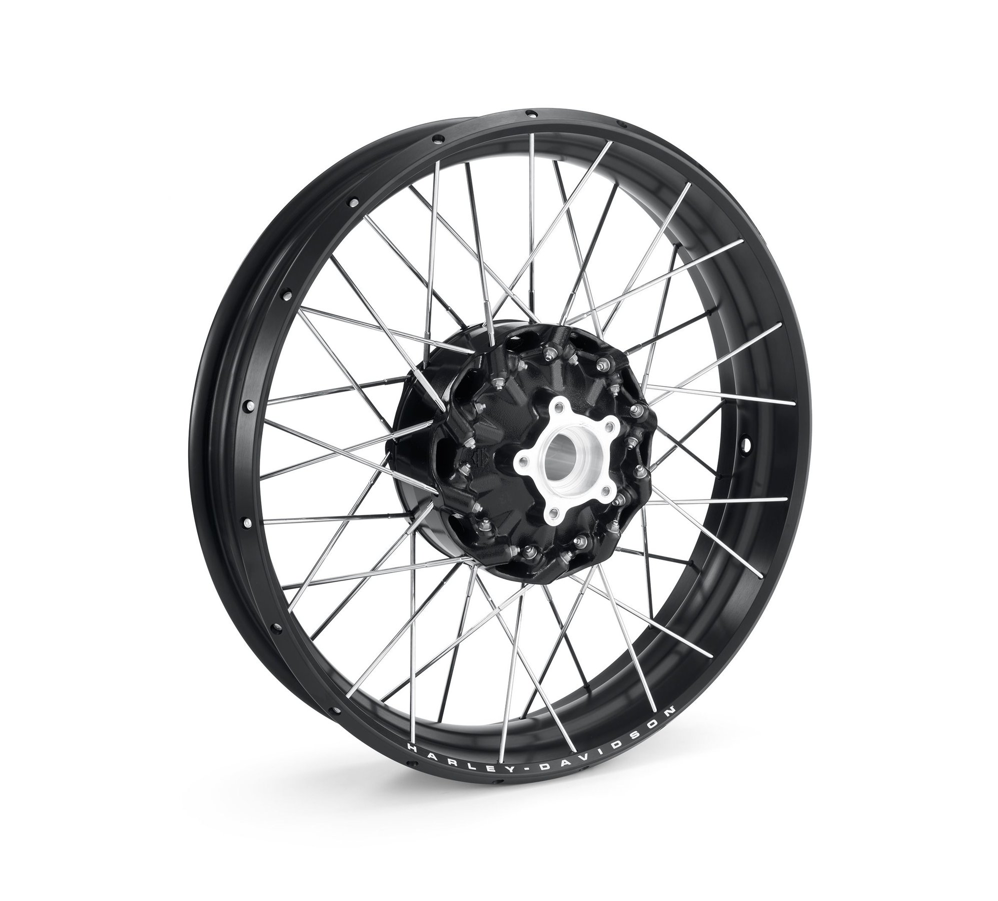

They now have laced rims, where the spokes are attached on the rim outside of the tire bead. The Pan American has them. They too are tubeless and you can actually change a spoke without the need to deflate the tire.
Obviously a specialty application, but interesting concept
