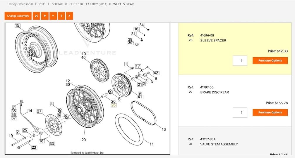

OP.... 98hotrodfatboy is spot on about the rear wheel washer between the bearing and the wheel (and his front wheel advice).
As you can see in the HD parts finder pic below, if you have an OEM rim, there should NOT be a washer between the bearing and the wheel.... only the spacer sleeve #26.
The washer suggests there is a modification, or aftermarket something, in the mix with your rear wheel and/or it's mounting hardware..
I hope this OEM parts pic helps

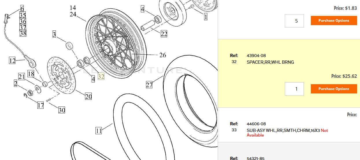

Usually when there's a washer under the bearing, the wheel was originally designed for the wider 1" bearing.
The only factory wheel with the washer that I'm aware of is the '08 touring.
I've seen after market wheels use it so it will fit both 1" & 25mm.

So it's a spacer and not a washer.. I understand the use of it but not a washer and that's where the clarification makes sense.., only because the difference in the inner diameter could interfere with the inner race of the bearing and possibly tear up the hub and bearing..

Right, I said washer but meant spacer.
