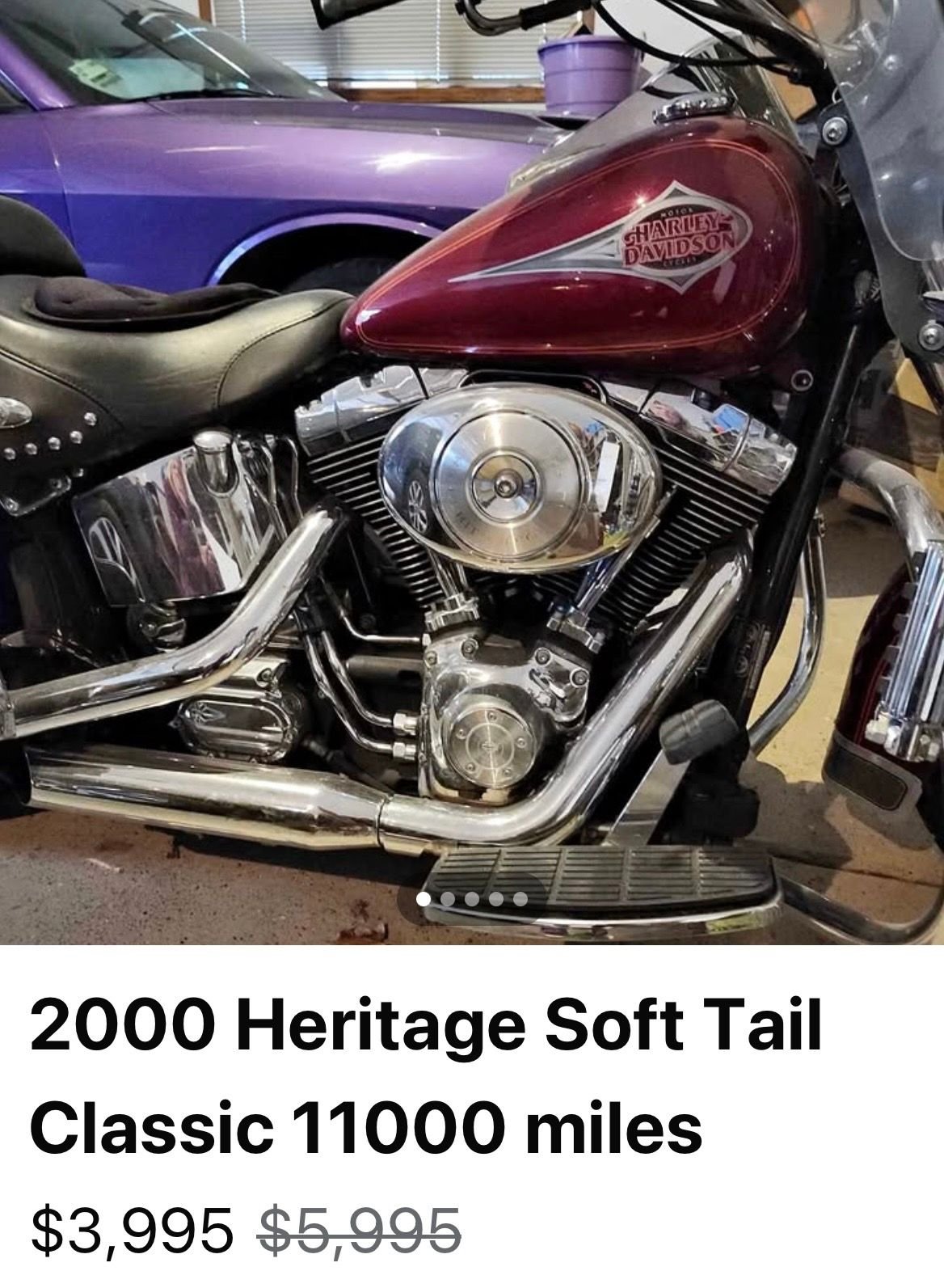

I am considering buying 2000 Heritage with 11k miles. Hope to get it for $3000 wonder if there are any issues with this model that I should be aware of or pay attention to so I dont make a mistale.
Seller asking 39995 what would be the most you will get it for? Buyer claim bike is in great shape running with new oil. And battery last year. I did 2 bike restoration so I am handy
few pix attached for reference.

The bike looks to be in very good shape.. How many miles? The early Twin Cams 88B motor had the better crank shaft that were less prone to runout issues along with the better left sideTimken bearing..A good foundation for a 95"or even a 98" bolt on big bore build.. But on the flip side is it's a counter shaft balanced motor with chains and guides that do wear out over time but should not be an issue for 50k miles depending on maintenance of the bike.. I could be wrong about the service interval and you will need to research that better..
The spring actuated timing chain adjusters wore out pretty quick and most should be at the least inspected and or replaced by 25k miles..
The cylinder heads valve springs limit the amount of cam lift to .510" and did not flow the greatest. A set of stock 2006 up cylinder heads would accept higher lift cams and did flow better than the earlier TC heads..
If maintenance was done properly at the correct intervals and the mileage is fairly low I would think that the asking price of $3995 is petty fair.. The Heritage was a pretty solid bike.. good luck.

big thanks this is super helpful. This bike is 11k miles
